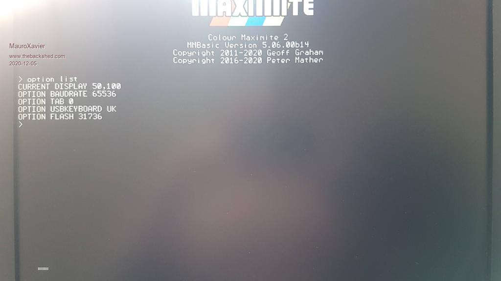

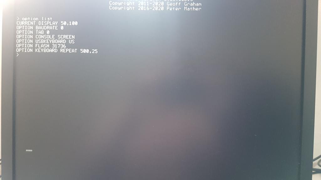

I upgraded from B7 to B13 and my cursor on the start is corrupted, what is working then I ignored it, then when I type my options as below it crashes on boot:
OPTION KEYBOARD 500,25
OPTION RAM
OPTION CONSOLE SCREEN
OPTION CONSOLE SAVE
Now when booting, there is no cursor and keyboard doesn´t respond anymore, it only shows the CMM2 logo and version. I flashed the firmware again using directly the waveboard and it back to the cursor corrupted but in a working CMM2 enviroment, but if I use the options above, crashes again.
I´m updating using USB A-A and tried other ports and the result are the same.
I reseted options using PIN trick and it works, and then when not using OPTION RAM and using OPTION FLASH 4, it gives me this in OPTION LIST:
PS.: Look at the giant corrupted cursor.

Posts: 12085
Posted: 06:58pm 04 Dec 2020
Try b14 just posted. I've just been through your sequence and it works perfectly
Do an erase all before flashing.
Also try putting the switch into SYSTEM mode then reset to enter flashing rather than UPDATE FIRMWARE
Finally, remove battery when flashing and put it back in once flashed
Edited 2020-12-05 05:07 by matherp

Posted: 07:07pm 04 Dec 2020
Full flash enabled and b14...
Cursor corrupted and OPTION FLASH 31736 as default.
I will try other things to see if I see it´s something here that is causing it.
Posts: 12085
Posted: 07:28pm 04 Dec 2020
Try as follows:
Plug in A-A USB
Switch Waveshare to SYSTEM
Press RESET
You should get the MS connected noise
Into CubeProgrammer
Connect to USB
Go to download screen
Click on the top select checkbox to select all sectors
click Erase Selected Sectors
You should see confirmation of each sector being erased in turn
Check "Skip flash erase before programming", we don;t need to erase twice
Make sure "Verify programming" is also checked
click Start Programming
Click message boxes
Click disconnect
Move switch back to FLASH
press reset
Check Options look sensible
MauroXavier
Joined: 06/03/2016
Location: Brazil
Posts: 307
Posted: 07:44pm 04 Dec 2020
Tried exactly as you said, and the result is the same:
Posts: 12085
Posted: 07:46pm 04 Dec 2020
What happens if you now go
OPTION RESET
Posted: 07:50pm 04 Dec 2020
I wonder if the corruption is a sign that (say) the last part of the file is not programmed correctly (or maybe at all)?
Maybe round up the size of the bin file to a multiple of (er, 512? 1K?) by padding with 0xff (&HFF) bytes.
