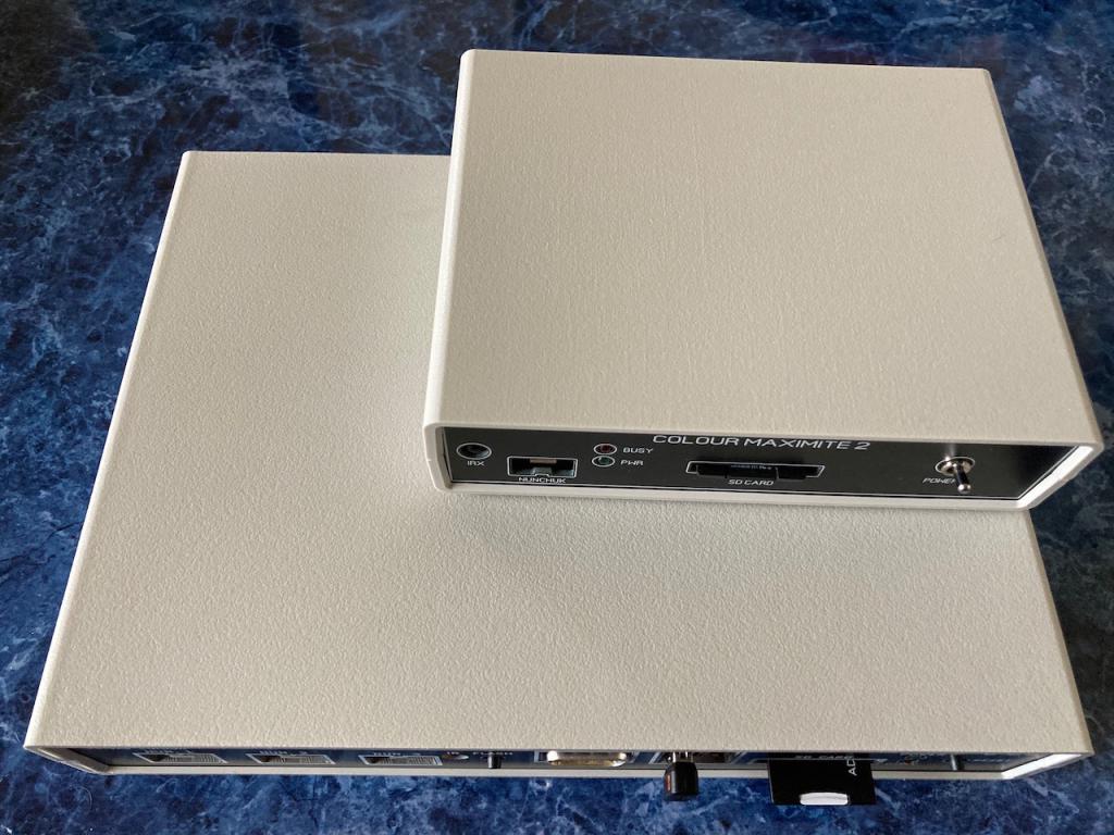

• SD card socket is different (not with spring) -just for info
• is VERY big compared to my other CMM2 (I didn't expect it)
Unfortunately I was not able to pack so much features in smaller case, giggest issues much more ports that are added comparing to original there is still some space to add more in distance feature, like HDMI. An there might be more to come...

Size is also OK and I understand the reasons, I was just surprised by difference. Maybe the size should be somewhere on you web.
Of course You are right, I will update web page with this information
