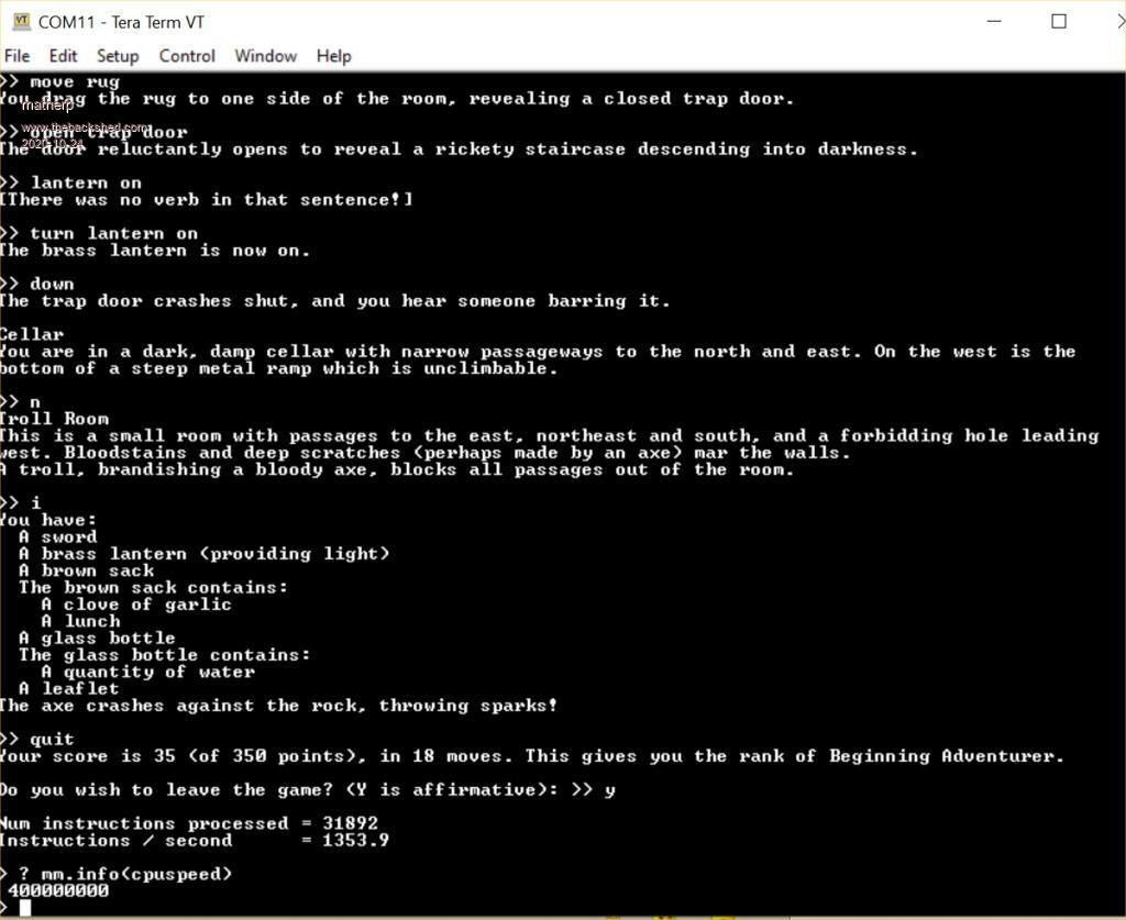

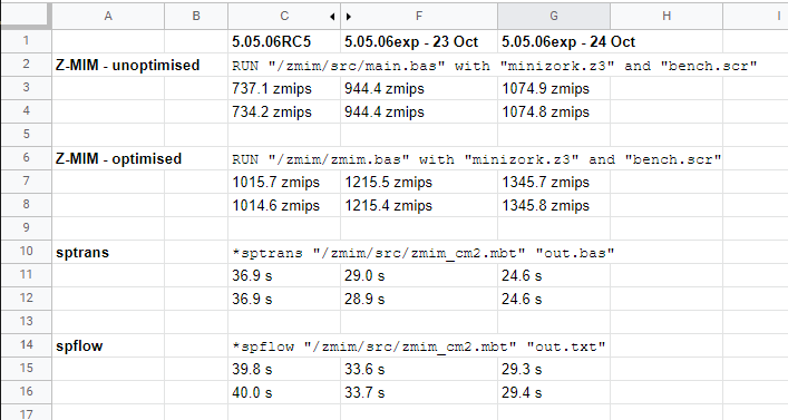

Posted: 01:09pm 24 Oct 2020
Very impressive, the unoptimised version of Z-MIM now reaches 1000 zmips.
I don't suppose there is any chance you'll stop now so that I can smoke test the Welcome Tape against a fixed target ?
