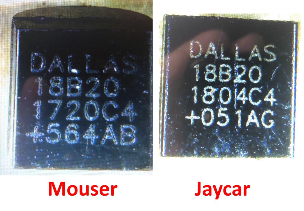

I went and ordered some "DS18b20" devices and found the following
The 2 I bought from MOUSER.COM proved to be genuine.
I bought one from Jaycar Electronics which is mounted on a small PCB substrate and whilst both read a temperature and responded as expected when I held a soldering iron near them the Jaycar module comes up as a FAKE.
Stay away from these Jaycar Modules
Now when I run the tests, the fake returns a value in 232 ms whereas the genuine was 692ms (I think from memory)
However there was a temperature difference of approximately 2 degrees C (fake was lower) between the 2 just measured at ambient room temperature (fake read 24.5 the genuine 26.5).
I will run some tests with both bonded together so I should be able to see the variations at various temperatures.
But the difference is quite pronounced and I pose the argument that you should not use the fakes unless you have calibrated against a known source but even then how reliable are they?

Hi Jim, All,
  TassyJim said
Can you run the program on the suspect chip again and tell me what ROM code you get?
Ok No worries, I am using a CMM2 as well directly on the 3 pads near the ARM chip
Here are my results
The Jaycar Module
MM.ONEWIRE  1
Conversion time:  176.335
The temperature is: 23.500 degrees C
on DS18B20 (FAKE!!!) with ROM Code 28 AA EE 63 3F 14 01 E5 using External Power.
The Mouser Part
MM.ONEWIRE  1
Conversion time:  610.162
The temperature is: 26.125 degrees C
on DS18B20 (Genuine) with ROM Code 28 98 4F 9B 09 00 00 73 using External Power.
EDIT ****  Note the different temperatures. they were stored in the same bag.. My CMM2 was on less than 30sec each time

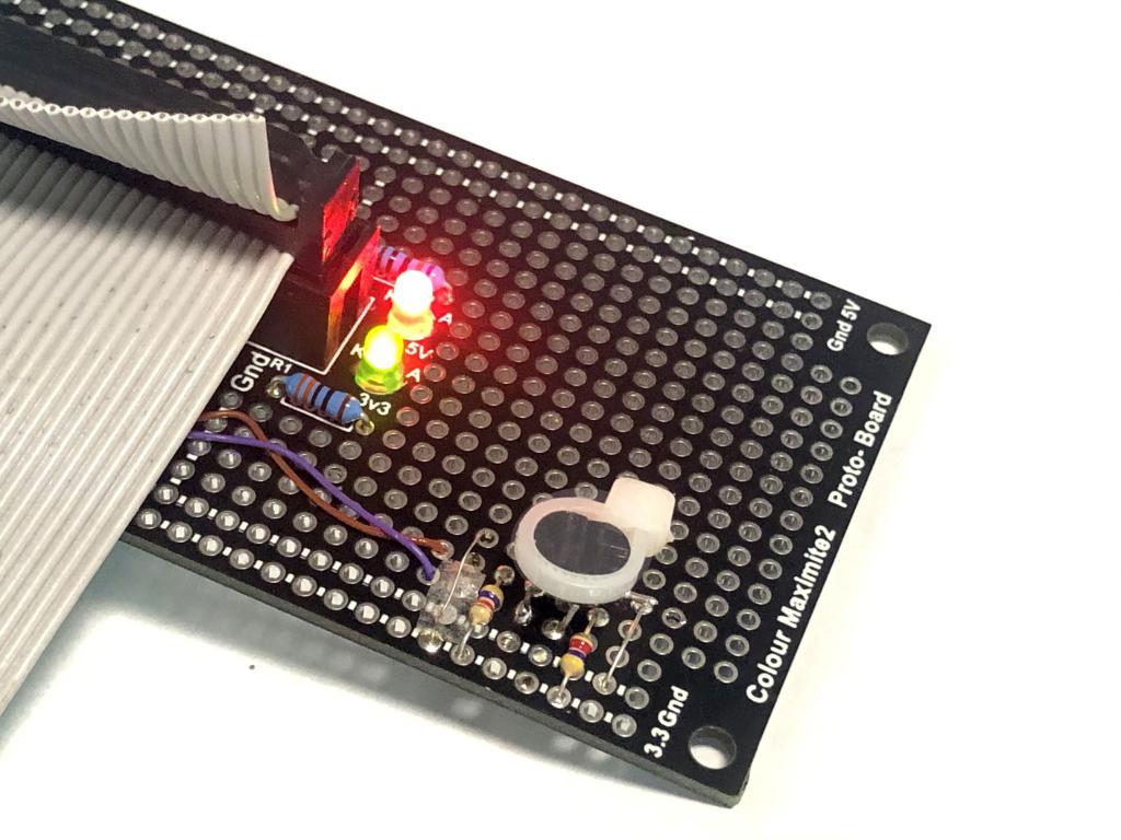

Hi Jim, All,
I have done my test with the 2 types bound together with a small cable tie.
The Mouser unit on pin(35) the Jaycar on pin(37)
Using this code
mik:
print "Mouser = "; tempr(35),"Jaycar = ";tempr(37)
pause 2000
goto mik:
I got these results after heating, carefully, with my heat gun from around 20cm away to roughly 60c and letting them gradually cool... each check is 2 seconds apart.

The cooling curve is almost exactly identical and all readings are within 0.25degrees
If the Jaycar unit is a fake it's a good fake.
This is how I tested them.
This is the markings for each, both appear to be laser etched.
