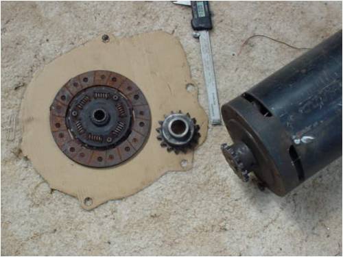

Thanks for the photos, I was a bit curious what your setup looked like, especially the 275A DC controller. I was sort of expecting a thing the size of a small 19" rack; yours is much smaller than I expected.
Nice looking setup, compact and portable. With a bit of automation it would make the ideal dumpload for guerilla grid-tied. Or, using a 3-phase induction motor instead of the present 1-phase one you could even generate your own 3-phase power for the workshop (I understand you use a rotary-converter for that at the moment?).
Your setup is basically indirect grid-coupled, except you've replaced the fancy inverter with a down-to-earth induction motor:
http://www.windpower.org/en/tour/wtrb/indirect.htm
If I were to try it as an experiment I'd probably use a small 3phase motor, remove as many loads from the house/workshop, and see if I can make the (very old, analog) power meter spin backwards, if only for a few minutes.
Just curious, don't answer if you don't feel like doing so on a public forum: if you some day plan to install a grid-connected turbine... would you go through all the paperwork to connect it... or go guerilla? Have had a look over here for the Belgian rules & regulations w.r.t. grid-tie windpower... and after reading all the legalese... I think I'd pass on their kind offer and go at it alone (i.e. off-grid DC system, only for private use).
As far as waterproofing goes: have you considered using plain epoxy? The hotglue may melt during normal operation of the controller?
Then again, the hotglue can be easily removed later again in case of future repairs.
Looks like you're having way too much fun on your deserted island...
Peter.

I don't think Ghurd would approve of no hot glue at all. I may blow it up again, so hot glue is good. Otherwise I would have used resin (epoxy).
Can't go guerilla here, everyone knows what everyone does. It would be secret for 10 mins tops... A short term fiddle can be tolerated, and in fact this set up could well be used to charge the batteries.. ie motor generator... perfectly legal... but.. if the batteries are higher.... Not my fault if the 1440 rpm is too slow to charge the batteries..now is it.
That was yesterday, since then the device has been dismantled. The motor and the curtis controller (1204)is to be used on a small Electric Vehicle...
..........oztulesEdited by oztules 2008-12-03

what is with the digital calipers? I still have to make do with the analogue version and a maggy lamp.
Gordon.

My eyes are getting too old for the vernier, and I can still stuff up with the digital ones .
.......oztules
