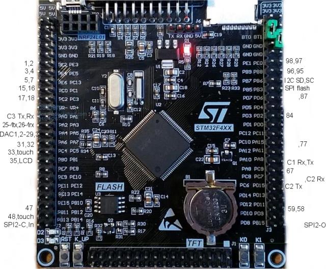

Thanks. I don't see PA13, PA14, or PB2 on the double headers on the sides. Are they on the top or bottom connectors?

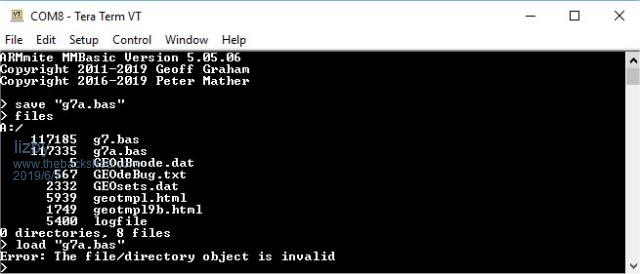

I'm still having problems reading my large file off of the SD Card. Any idea why I would be getting this--failure to LOAD "filename" after (apparent) success with SAVE "filename":

  Quote  Thanks. I don't see PA13, PA14, or PB2 on the double headers on the sides. Are they on the top or bottom connectors?
See schematic

Here's my labeling of the usable pin numbers. I didn't include labels for the display or SD, and various others.
Please let me know if any corrections or additions should be made.

You don't need to worry about pin numbers. Just use the pin names in all of the relevant commands
? tempr(PE2)

With a new cable, I was able to flash a second F4 and get to the ">" prompt with the USB connection. A little experimenting gave some likely clues to my problems downloading a large basic program. Memory shown is 114K. The program is 121K.
If I try F10 and copy and paste the entire program, it stalls at 114K. Makes, sense--all ram is used. If I try F11 and in teraterm, xmodem send the file, it goes to about 93% and stalls--same explanation. If I omit the last 140 lines of comments and use F10, it succeeds (barely--114K-odd downloaded--112K flash used for program, 9K for fonts, 23K free).
So I guess instead of using teraterm I need to use MMEdit and crunch the comments out, especially since the program is likely to grow more.
I suspect this is also the reason why I can SAVE the file to the SD, but not LOAD it--some amount of ram overhead in the load routine. MMEdit to the rescue.

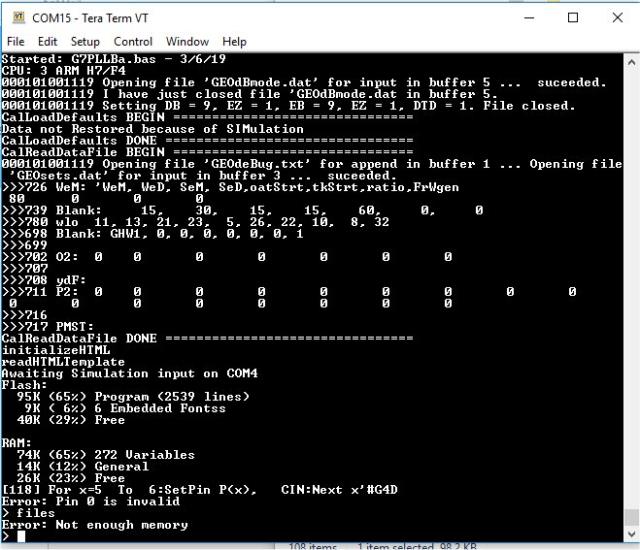

My large program runs on the early versions on the F4, but fails with the most recent. When trying to read a configuration file off of the SD, it reads the first line successfully, but further reads have results which come from I don't know where. It took me a while to track this down and isolate it so I provide something to test with.
The first line is read with "Line Input #3,in$", and the second with "Input #3, WeM2,WeD2,SeM2,SeD2". The problem is not, per se, with the switching from LINE INPUT to INPUT--if I strip down to just read the file, the code works (as it does on older F4 releases).
A related odd thing is that after the program fails, "FILES" fails with "Error: Not Enough Memory". "NEW" clears this.
This is what the failing output is:
I've sent a PM with a dropbox link to a zip file which includes the .bas file (with all full-line comments stripped out so that it fits in flash), and two additional files which need to be on the SD card. It is the reading of GEOsets.dat which is off--but that works on prior F4 releases (and H7).

Posted: 09:22am 22 Jun 2019
Please try this version
2019-06-22_192001_ArmmiteF4.zip
The bug was in an optimisation I'd put in for file reading that didn't properly cope with multiple files open for read.
The FILES memory issue was correct. The command needs a buffer to sort the long file names and if a program is using lots of RAM then it can't get the buffer space it needs. I've changed the maximum filename length from 255 chars to 63 chars to reduce the buffer needed so don't use filenames > 63 chars

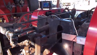

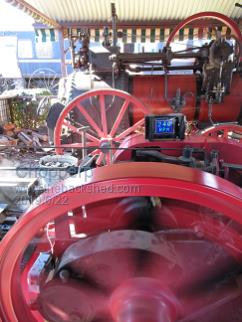

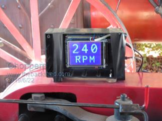

Just a few of photos of one of my F4's in action.
Simple Tacho for a 1/3 scale traction engine on blocks, made up in sort of a hurry.
Using a Hall Effect sensor with six magnets taped to the 6 spokes of the flywheel.
Just used a Frequency input for today's test which gave 10Hz resolution with reasonable accuracy.
Got it up to about 250 RPM before it started shacking too much.
There is a 5V battery pack taped to the back of the box. Magnets were used for fixing.
I was mainly interested in how fast the beastie was turning. Slowest was about 30 RPM. (1 rev every 2 secs)
