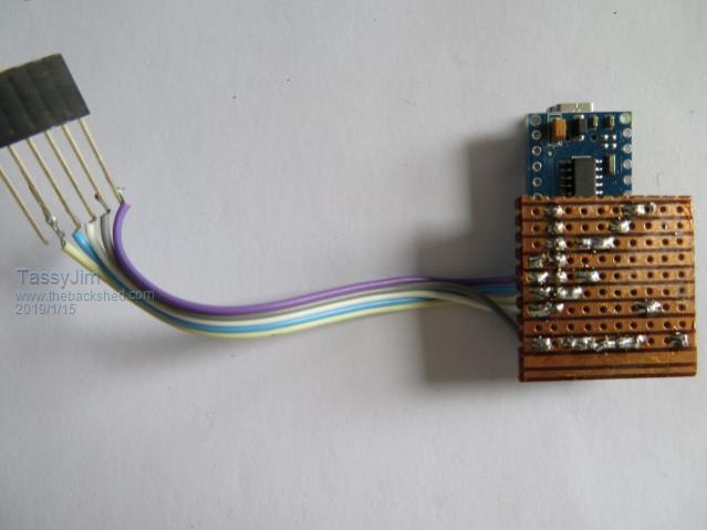

You don't need to get that sophisticated.
A bit of veroboard has served me well since Rob first told us about it.
You might find MMFlash useful as well
