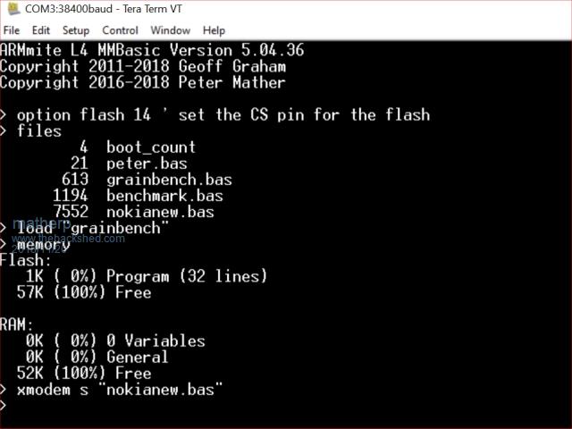

What technology are you using for this? FRAM by any chance? Or is it using built-in memory?
This is getting very exciting now Edited by WhiteWizzard 2018-11-21
Posts: 12085
Posted: 03:40pm 19 Nov 2018
  Quote  What technology are you using for this?
SPI flash - Winbond 25Q32 (4Mbyte), will also support 25Q64 (8Mbyte), and 25Q128 (16 Mbyte)
Edited by matherp 2018-11-21
