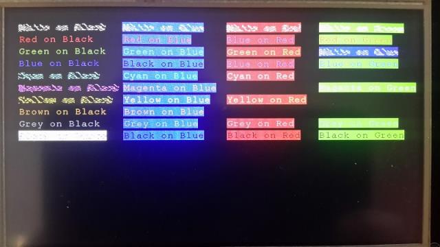

I have tried using the new speed related drivers with no luck.
I have moved on to the 7 inch just to see if it might have been my 5" display causing the problem, again no change.
Here is a screen shot of some "text" tests, quality from my Samsung Tab not the best.

The lower left below "Grey on Black" is "Black on White" and resembles top left "White on Black", not clear on photo.
It's weird certain colours react differently.

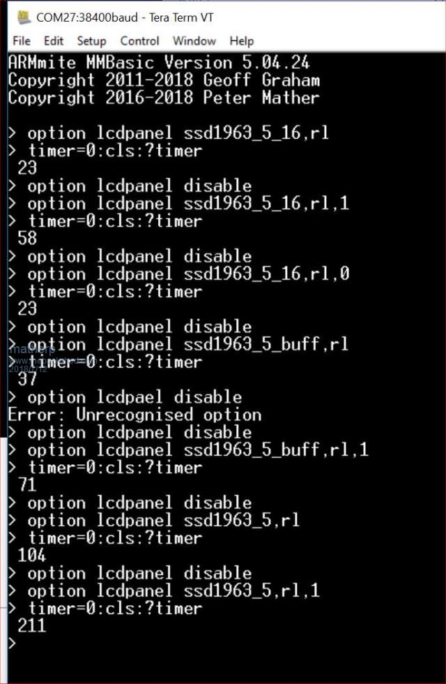

  Quote  Just a thought, am I the only one getting this problem with the Armmite & TFT?
No there is an issue but I'm certain it is electrical rather than code:
My original results with your test program:
option lcdpanel ssd1963_5_16,rl,1 - perfect
option lcdpanel ssd1963_5_16,rl,0 - Corruption of white-on-black and black-on-white otherwise OK
option lcdpanel ssd1963_5_BUFF,rl,1 - perfect
option lcdpanel ssd1963_5_BUFF,rl,0 - Corruption of black-on-white otherwise OK
option lcdpanel ssd1963_5,rl,1 - random small sections of background missing (typically 2 chars per run)
option lcdpanel ssd1963_5,rl,0 - random small sections of background missing (typically 3 chars per run)
BUT
I then put a 47pF capacitor between WR and GND on the display and the results for all the 16-bit driver versions were then perfect but the 8 bit results were worse
Basically I think we need a daughter board to get a good connection to the display. The signals from the STM32 seem to "ring" more than those of the PIC

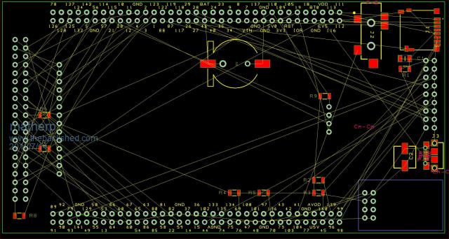

Here is a first cut (as yet unrouted) for a Nucleo-144 daughter board. It supports:
Battery for RTC
SSD1963
ILI9341
ESP8266 module connected to COM3
OV7670 camera I/F
I2C pullups
Micro-SD card
Jack socket for DACs
Micro-USB socket for 5V input power (use Pi3 PSU or similar)
Comments and ideas appreciated
