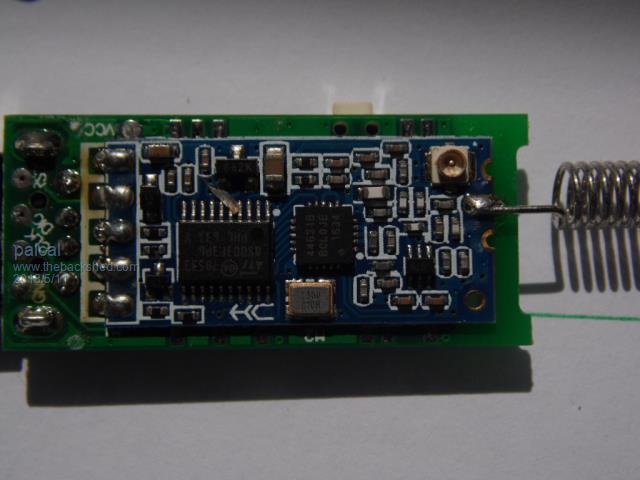

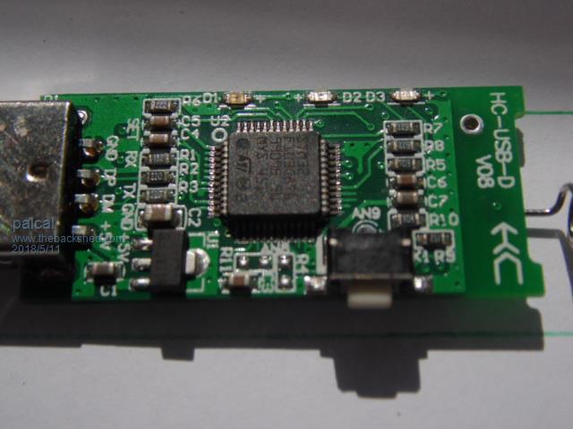

Edit... I will see if I can take a photo of its innards and post it.Edited by palcal 2018-05-12
palcal
Joined: 12/10/2011
Posts: 2053
Posted: 12:19am 11 May 2018
Here is a pic. of each side of the device.
Paul.
Posts: 10081
Posted: 12:31am 11 May 2018
It appears they are using a large QFP ST device as the USB-serial adaptor.
Overkill, I would have thought....
Can you post the ST part number on the QFP chip? That would allow us to search for the device over at the ST website, and download any drivers it needs.
palcal
Joined: 12/10/2011
Posts: 2053
Posted: 01:08am 11 May 2018
Chip No. STM32F103C8T6
99089B 9U
MYS 451
that is as it is printed on the chip.
I downloaded the STM32 driver from here..STM32
Paul.
Posts: 10081
Posted: 01:21am 11 May 2018
So you installed that driver, but it still would not talk to you on XP or Win7?
