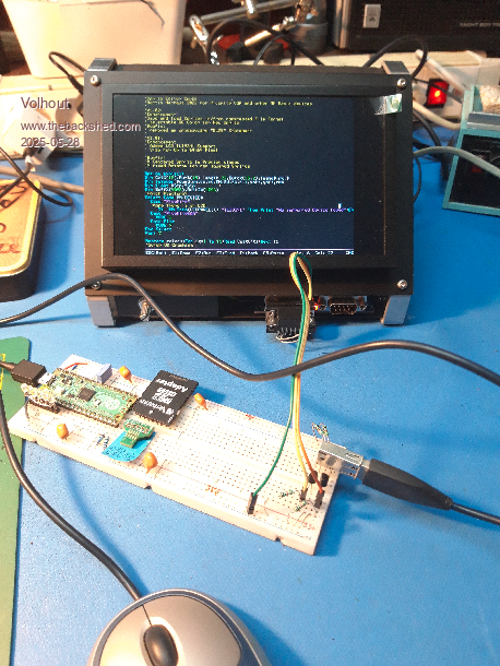

Not sure how many are using PS2 keyboard / mice now but I think this needs looking at, can anyone else confirm?
Using VGA 2040 with PS2 mouse, it appears the mouse cursor defaults to 16 pixels high whilst the font is 12 pixels high. The cursor also moves in 16 pixel increments so except the top line it doesn't line up.
HDMI firmware is ok, only VGA shows problem at both 640 and 720 resolution.
Tested with real PS2 mouse, still working on USB-PS2 keyboard / mouse adaptor....

Posts: 6197
Posted: 07:18pm 27 May 2025
  mozzie said  G'day All,
Lyle.
Hi Lyle,
I cannot confirm this. Running 6.00.02rc24 on a RP2040 VGA platform.
I breadboarded a 3V3/5V level shifter and added a USB/PS2 compatible mouse.
OPTION MOUSE gp0,gp1
The cursor in the editor is 8x12, and moves character per character. In below picture, the mouse cursor is mid screen right. It is a block cursor.
P.S. the pico on the breadboard is just supplying 3V3 and 5V for the mouse and level shifter circuit. The 2040 VGA board is behind the DB9 connectors, below the VGA LCD screen. The 2040 VGA board has never been in widescreen mode. It is 640x480 60Hz.
Edited 2025-05-28 05:28 by Volhout
