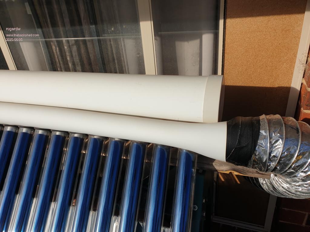

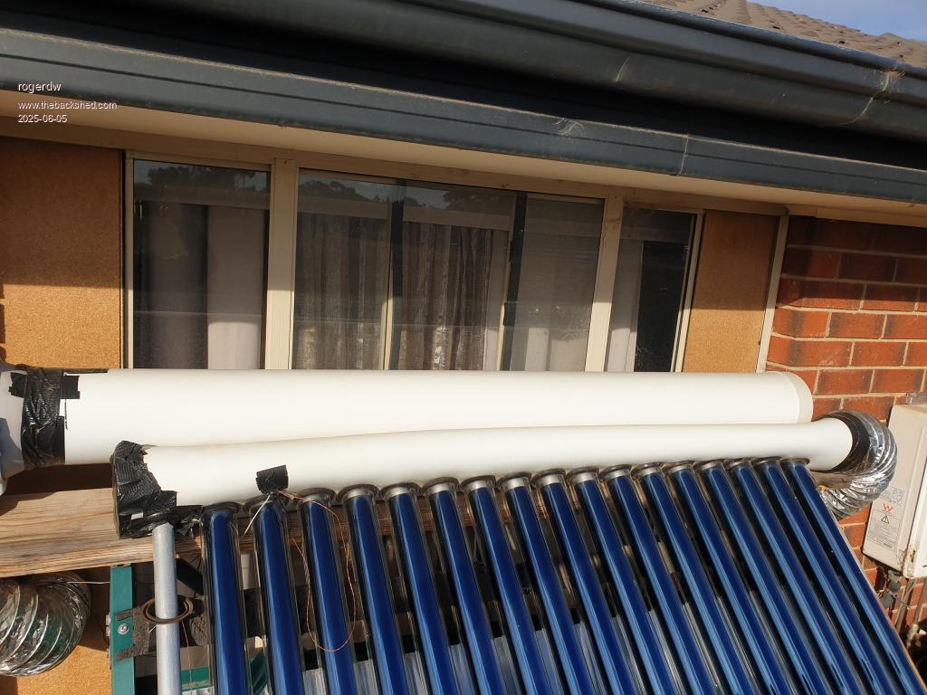

My plan with the original was to transfer it to the workshop. Just hang it vertically on the wall and cut a 6" hole either end for 90 degree elbows. I had started to think that with all this solar I'd just use a reverse cycle aircon  ...  but with just 43 watts for the original airheater fan  ...  and the fact it runs as soon as the sun shows up  ...  often at 7.30 am  ...  I have to try it there as well.
Of course I have to rebuild it because it is fairly badly distorted. I can't remember who it was (haha) but someone suggested I run it on a hot day to see what sort of heat it would put out  ...  and of course being pretty gullible I decided to give it a try.
One hot day I ran it for a minute or so and was surprised that it wasn't any hotter than I'd seen before  ...  so a bit of an anticlimax. Anyway a few weeks later I walked past and noticed the endcap off the hot mainfold was lying on the ground. Once I looked at it, the tube had collapsed by a couple inches from just that minute or so of heat and with the cap popped off was just pumping outside air into the room.
I thought it was stuffed, but when the cool season turned up, I just taped it up and kept it going. Not too much later, from the pressure of everything being out of alighnment, one of the tubes broke  ...  but with my excellent taping skills, I had it bypassed in no time.
The lower pipe used to be the same shape as the top one.

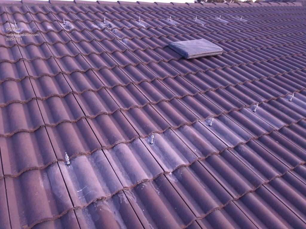

The whole assembly is 4 mtr x 2.4 mtr  ...  and so it will straddle 8 rafters.

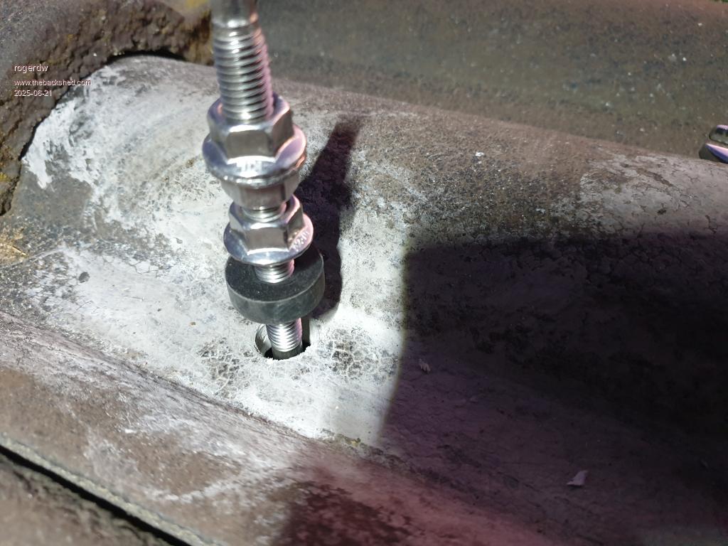

I bought some 200mm x 10mm stainless steel anchor bolts which have a coach screw thread at one end and metal thread at the other  ...  with a rubber grommet in the middle to seal where they come through the tiles.
I bought a batch of 5 diamond encrusted 16mm bits to drill through the tiles  ...  ~$20 from aliexpress  ...  as against ~$60 for one from Bunnings. I practised on a spare tile and was amazed at how efficient it all was. Certainly worked better by consistently spraying with water to lube and cool.
I was on my third bit by the time I finished the 16 holes, so very relieved I bought the five.

Hi Roger you probably already know this but with SS threaded parts they are prone to galling so make sure you put some lube on the threads    The last you need is a stuck nut on the installation.

Hi Bryan, and no I had never even heard of galling with SS threaded parts. I've probably experienced it at some stage but never knew it was a thing  ...  thanks for the heads up. What lube would you recommend using or isn't it really important what type as long as there's something.

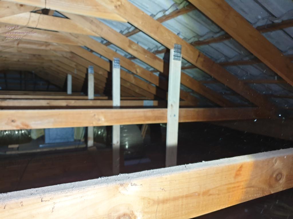

I am feeling a lot more confident now I have all the anchor bolts in place and just need to cut up and weld together the angle brackets that will sit on the bolts, so the frame can be lowered onto them. Then I can drill through the sides of the frame and stick some bolts through.
I managed to get four support timbers in for the higher side  ...  and was surprised and really pleased that there is a wall directly below, that the struts rest on. I'm hoping I actually planned that but can't really remember, it was so long ago when I was crawling around in the ceiling trying to work out just where to locate everything.
I haven't tackled the lower end yet but they need timber about 900mm long on a bit of an angle to another wall frame. Should be easy enough to do that next weekend.
It's not a good photo, but the anchor bolts are located directly above the studs  ...  and the bottom ends are resting on the wall frame. The closest one looks like it's on a bit of a lean  ...  but they were all dead vertical according to the spirit level. Must be the optics.

Roger what I use on solar rack bolts and fittings it called Nickle Seize.
Stainless steel as Bryan said does gall. Old solar rack bolts are almost impossible to remove after a few years.
So I put nickle seize on the threads and have found it works well.
I use it on any stainless steel bolts especially on motorcycle engine bolts.

Thanks Pete. I guess that's what was wrong with a heap of solar fittings I couldn't dismantle when I wanted to reuse it. I just assumed there was a mismatch of materials  ...  but was probably this galling you're talking about.
And thanks Bryan, that would be very useful. Hopefully once it's up there it won't need to be altered in my lifetime, but you never know.
I do wonder now about all the railing and fittings I used when I put up all my panels  ...  I just put them all together dry. Hopefully I won't need to make any changes there.

I would recomend LanoCote available from Bunnings for use on all solar fittings, stainless bolts etc, just spray it on; years later you wil be able to pull things apart again. LanoCote

Roger looking at that Lanocote Mike mentioned sounds like the best solution and I'm even going to get a can for myself.
The beauty about lanolin spray it does get in and stays there and being a spray can with a fine nozzle will make it a breeze, even with your existing solar array a quick spray where the bolt goes into the base block will do wonders for undoing it down the track.
The main problem with old style never seize it does get everywhere and makes a mess so a spray can does look the best solution.

  Solar Mike said  I would recomend LanoCote available from Bunnings for use on all solar fittings, stainless bolts etc, just spray it on; years later you wil be able to pull things apart again. LanoCote
Mike
Thanks Mike, a spray does sound good and it looks like something really useful to have on the shelf.
  Bryan1 said  Roger looking at that Lanocote Mike mentioned sounds like the best solution and I'm even going to get a can for myself.
Regards Bryan
Yeah, after seeing Mike's suggestion I figured I'd grab some too  ...  and this job should be a good test for it too. Thanks.
Cheers,  Roger
