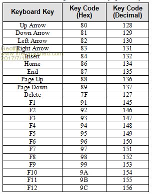

  flip said  In MM when keys are pressed which generate compound codes [e.g. up-arrow CHR$(0) + CHR$(72) ] then the second code is delayed until the subsequent key-press...and so forth..until a key which doesn't generate a compound code is pressed...everything 'catches up'.
That issue and the other bugs are fixed in the attached version 5.04.05 Beta 4:
2017-07-15_143318_DOS_MMBasic_5.04.05_Beta_4.zip
This version generates the following codes for special keys:
The manual has been updated to reflect this and the other errors listed above.

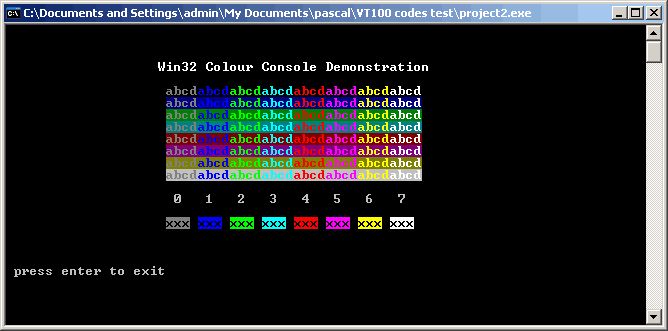

Posted: 05:43am 18 Jul 2017
have done a bit of digging - getting VT-100 compatibility is indeed complicated. however, positioning the cursor and changing colour attributes is relatively simple using the win32 API calls SetConsoleCursorPosition(h, xy) and SetConsoleTextAttribute(h, at).
the attached demo (source included in delphi/pascal) provides three functions:
gotoXY(x, y)
colour(attribute)
clrscr
i reckon these three functions would be a neat addition to the DOS version of mmbasic. there are also console functions in the win32 API to handle keyboard (and possibly mouse) input, but these look a little more involved. see:
https://msdn.microsoft.com/en-us/library/windows/desktop/ms682073(v=vs.85).aspx
2017-07-18_153918_project2.zip
rob :-)
