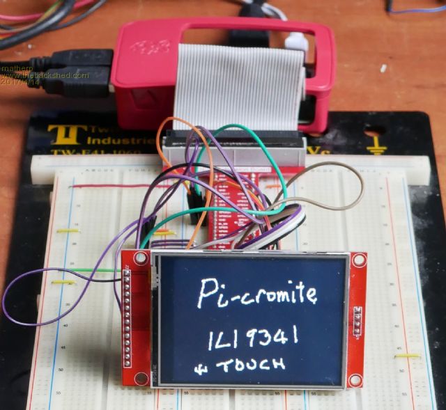

Fairly big upgrade 5.3a2 including more "Micromite" functionality
2017-04-14_184056_mmbasic.zip
This now supports hardware SPI using Pi pins 19,21,and 23 with the standard Micromite syntax (SPI OPEN, ? SPI(x), SPI WRITE, SPI READ)
In addition it supports the following SPI displays connected to the same pins (+ user selectable CD, CS, RESET) ILI9341 (320x240), ILI9163 (128x128) , ST7735 (128x160), ILI9481 (480x320). Transparent text and BLIT are available for the ILI9341 display.
Touch is fully implemented and should also be connected to the SPI H/W pins + user selectable IRQ and CS.
The displays and touch are enabled using the standard Micromite syntax (OPTION ...)
Options are saved in the file ".options" in the same directory as the mmbasic executable
GUI TEST LCDPANEL and GUI TEST TOUCH are both implemented (exit using ctrl-C)
All MX470 GUI capability is also implemented and has been tested at a limited level.
as before you need to install pigpio on your Pi if not already installed
[code]sudo apt-get update
sudo apt-get install pigpio python-pigpio python3-pigpio [/code]
and execute mmbasic using
sudo ./mmbasic
Always exit mmbasic using ctrl-z or "quit" to avoid leaving disconnected processes running on the Pi which will interfere with pigpio initialisationEdited by matherp 2017-04-15
