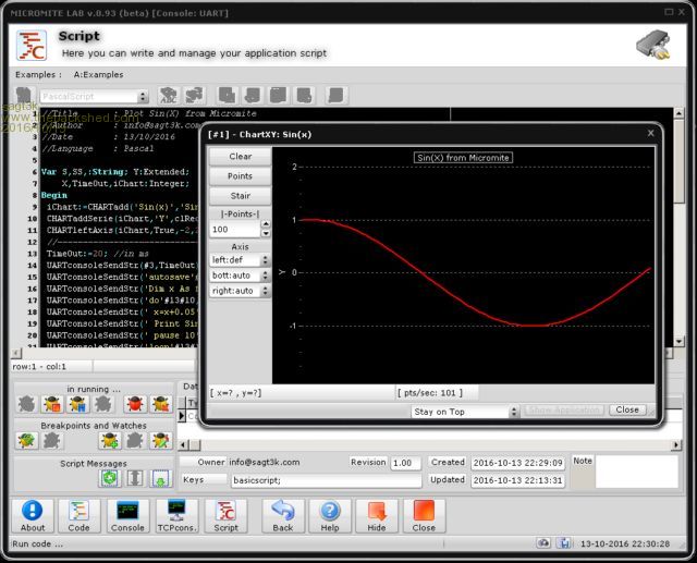

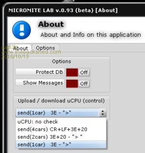

I published new version of MicromiteLab 0.93. I have added the option "to not check the uCPU". This for all those who have encountered the error "uCPU: non connected"
I have added a script that you can download script Sin(X) . To run the script, you need to connect SW with UART/console, after you connect the console You can run the script. The script sends and run a simple program "Sin(X)" and plot input from Micromite to ChartXY as in example:
To start the script press button: and to stop:

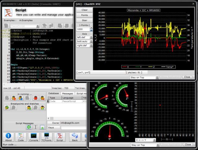

Here other examples. This time an example a little more special. Communicate with a sensor Acc+Gyro MPU6050. On my site sagt3k.com you will find the code. Where you will find "Sensor MPU6050 + Code + Script" you can download the code for Micromite and the script for the Script Engine.
To do everything correctly you need to program Micromite from "Code". On console you can "RUN" the code and you can create a TCP connection on port 1500 on "Srv: UART <--> TCP" and choose the port 1500. To make it more intriguing, I send data on TCP from UART, acquire data in TCP, sending data to chartXYZ. To start the Script Code push the button . Remember to "RUN" the code by "Console"
Thanks for your attention

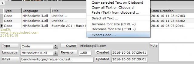

Thanks for trying the latest example. As I have expressed in other posts, no longer exists the possibility to make "load / save" from "CODE". This is because I'm designing a cloud as dropbox. However you can create a new code with the button
. Then, You can write or to do a paste from other place. Later You can save with this button
To export a ".resdat" you have to wait the cloud solution.
".resdat", that uses MicromiteLab, is a complex structure and is used to provide security and other things. This is why I prefer this way.

I agree with you,I could put aside the "cloud" topic. But as I thought the structure ".resdat" when then export to save much data that would be imported by another user as language, keys,vers, date, title, note , including a unique hash key that ensures the uniqueness of the export. The only thing that You can not change is the email. That is saved by the program only with a registration phase. (here I have to think of an alternative solution).
Now "Export Code" on "Code" and "Export Script" on "Script" generate ".resdat" files.
For the moment I can add "Load/Save" from .txt, or .bas. But the user need to complete all the informations. Then when the user choice "Load" I create a new record.

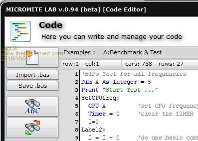

Hi to everybody

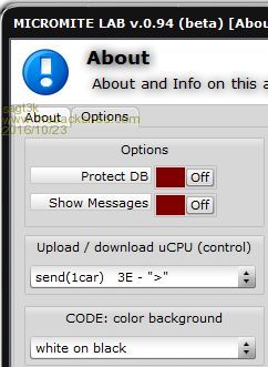

I published new version of MicromiteLab 0.94 .
- I added the ability in "CODE" to import or save file .bas
- In option I added a new parameter to change the background color for "CODE" editor
sagt3k

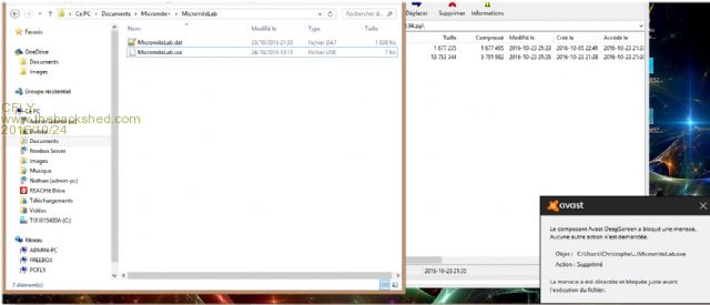

Posted: 01:17am 24 Oct 2016
Hello !
Impossible execution... AVAST destroys the application ... malware !!!
Normal or not?
How to use it?
sagt3k
Joined: 01/02/2015
Location: Italy
Posts: 313
Posted: 01:25am 24 Oct 2016
Hi CFLY
Micromite Lab does not have virus. I use symantec, windows defender. In this version the file .exe is full and I don't use .exe compressor. I think that AVAST sees tcp connections as possible anomaly. Can you send me a screenshot of error message?
CFLY
Joined: 20/05/2015
Location: France
Posts: 41
Posted: 01:54am 24 Oct 2016
And after, there is no more an application in the directory ...
