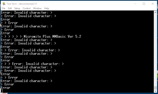

Just as an 'aside' here is the 'dump' I got at the 'command prompt' when I had shorted 'console port' pins -
At my stage of life I like to think about problems before 'posting'. I like to think it wards off Dementia
Note that this was a continuously scrolling dump. Edited by mikeb 2016-08-21

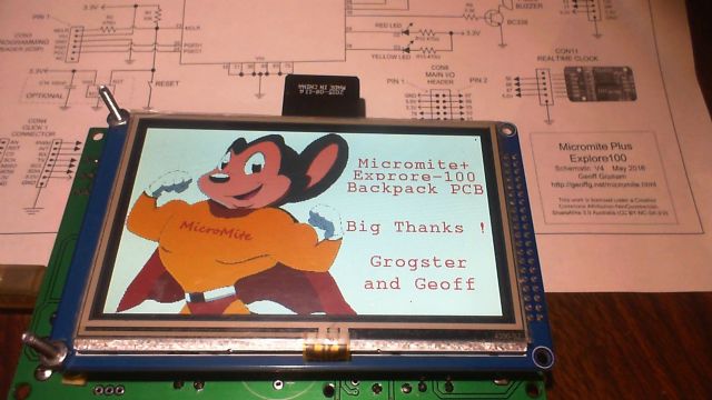

One picture worth a thousand words..!!
Posted: 06:09pm 19 Aug 2016
@ Phil23 - Yes, Chip-Quik is very expensive, but it just saves so much mucking around, that..... It is a common complaint - the price of the stuff. But IMHO, I don't care about the price of something like this(within reason, naturally!) if it works. Chip-Quick does work, and it makes removing stuff like this so easy, you hardly have to think about it. No, I don't work for them.
mikeb is spot-on with his comments about making sure you fully heat the solder when removing pins using the cutting method. If you try to pull the pin out when the solder is not fully melted through to both sides of the board, you can indeed lift pads, tracks or vias - or all of those at once.
@ Zonker - Glad to see it arrived to you OK. Nice image. 4.3 inch screen?
