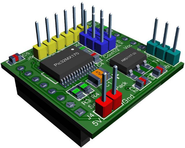

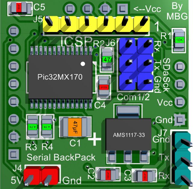

Posted: 03:53pm 29 Apr 2016
Hi All,
As Mentioned, DEX is improving the 3D visualisation at the moment and I just wanted to show a couple of examples of the effect, hoefully TBS wont resize these images too small.
The latest effect is to add a `weave' to the fibreglass PCB so that it looks a bit more realistic. (that probably wont be able to be seen in the reduced size of the screen shots but I can follow up with a close up if anyone is interested.
Kind Regards,

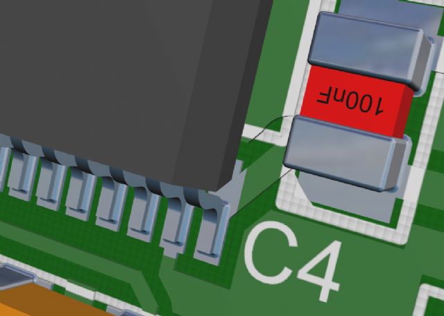

EDIT****
Yes TBS reduced the size so the weave couldnt be seen.
Here is a close up view.
Mik
Edited by bigmik 2016-05-01
Posted: 07:41pm 29 Apr 2016
The 3D visualization actually was the thing that convinced me.
I like that a component is not only a footprint and a 3d model.
Here it is actually a parametric model with parametric feet. This gives the most realistic representation with the least amount of data. Very smart.
There is even solder on the pins.
But what really makes a difference is that each component can have a color. In your example the headers and resistors is a great use.
My biggest wish is colored traces, but i can understand that is more a 'false color' 3D but great for documenting a project.
It would save a huge amount of coloring by hand.
I am not convinced that having the schematic and pcb being one single entity is the best thing. More working with it will make that clear as i am still finding my way around. One thing that bothered me was that I deleted some traces on the pcb that directly removed those traces from the schematic. I think it would be better to change the behavior in the PCB layout to 'unroute' a trace when hitting the delete key.
A few small other things like switching between keyboard and mouse when a right click would be much faster to do. Especially 'copy' 'paste' which is either a keystroke or a long travel with the mouse pointer. I am collecting those 'productivity enhancing' things i miss and will suggest them.
Edited by MicroBlocks 2016-05-01

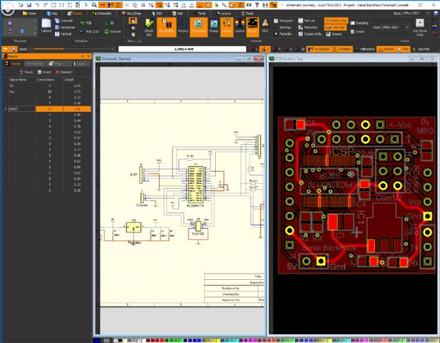

Posted: 04:30pm 30 Apr 2016
Hi All,
Iliya has been reading this thread and responded with this answer regarding separate SCHEMATIC and PCB files and Track Highlighting.
QUOTE Iliya..
___________
Doing 2 different PCBs with one schematic in a single design is full of problems.
The main one is that often the pin numbers on packages are often different for different package types.
What if a different PCB combined elements into 1 e.g. resistor arrays.
DEX has a one to one mapping of symbols/footprints so select a symbol selects a footprint. Same with schematic wires to tracks.
The complexity and risk of software bugs would go through the roof!
I could do this but to be quite honest it’s not worth it.
Other programs might handle it with users clicking forward/reverse ‘annotation’. These are not real-time links. I think often they have problems. Reverse annotate a PCB to a schematics, what about the other PCBs made from the same schematics.
As for colored tracks matching colored schematics wires; what about layer color?
In DEX select a wire the PCB net and all its tracks get selected. Same the other way.
Try the route panel to select named/unnamed nodes/nets.
Iliya Kovac
EDIT****
TBS reduced the image size to be almost unreadable.. Here is a ZIP with the Image file full size.
2016-05-01_023303_Iliya.zip
Edited by bigmik 2016-05-02
