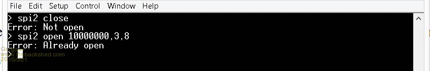

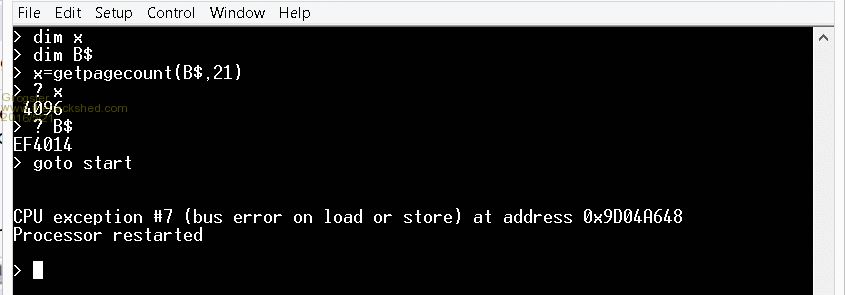

Calling getpagecount before attempting a write routine causes a processor exception:
I can't close the SPI2 port, as it is not open, but I can't open it cos it is already open.......
I will ask Geoff about that last one, cos that should not be I don't think.

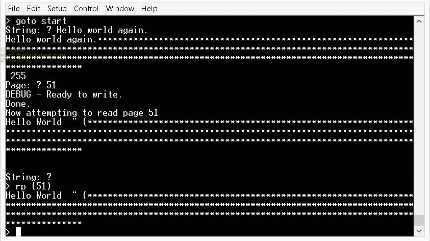

I am getting reading and writing now SO LONG as I don't try to write to the same page more then once. If I do, the data is corrupted. If I make sure I use a new page each time, it reads back fine.
EDIT: Yes, I have confirmed this. If you write to the same page that has been written to before, the data is corrupted. If I issue D$=SPACE$(255) at the command prompt, and then writepage (51,D$,21), that completes fine, and you can read it back with readpage, but if I then try to write some data to page 51 again, it remains as blank spaces - you cannot overwrite a page that has previously been written in other words.
I don't think these logging routines are for me. Matherp obviously wrote them for logging purposes, and I get the distinct feeling I am trying to mutate the Cfunctions etc into something they were never written to be in the first place.
I am now reading the device manual. Perhaps I can write some basic code of my own to manage the pages the way I need to be able to. I'll have a go, anyway. Edited by Grogster 2016-05-22

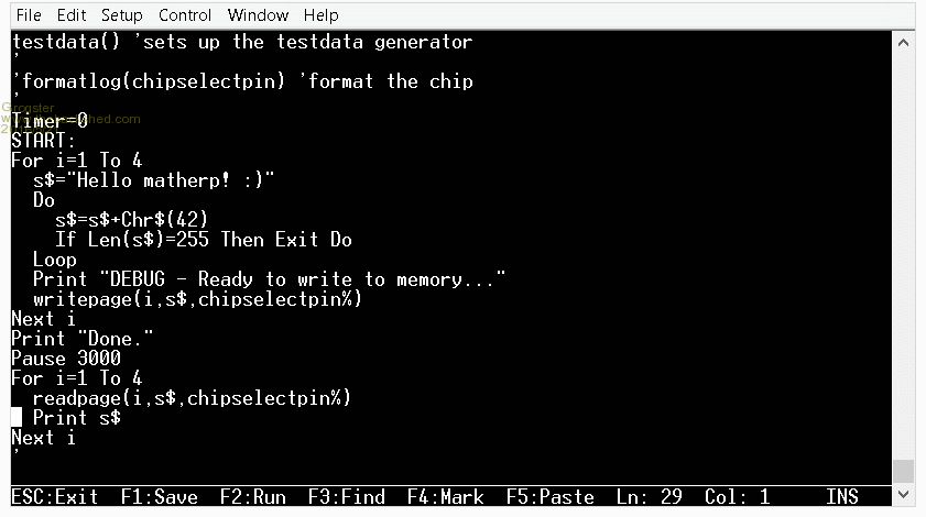

testdata() 'sets up the testdata generator
'formatlog(chipselectpin) 'format the chip
'spi2 open 10000000,3,8
i=getpagecount(d$,chipselectpin%)
timer=0
for i=1 to 1000 'log 1,000 strings
s$=int2Text(i)
s$=s$+space$(255-len(s$))
writepage(i,s$,chipselectpin%)
next i
print "1,000 records constructed and logged in ",timer\1000," seconds"
pause 3000
readpage(i,s$,chipselectpin%)
print s$
next i
end

spi open does not work, as the memory is on SPI2, and I can't open the port - I get the error that it is already open etc - see above.
I have put getpagecount in there, and that is working OK now, but not for writing to the same page more then once.

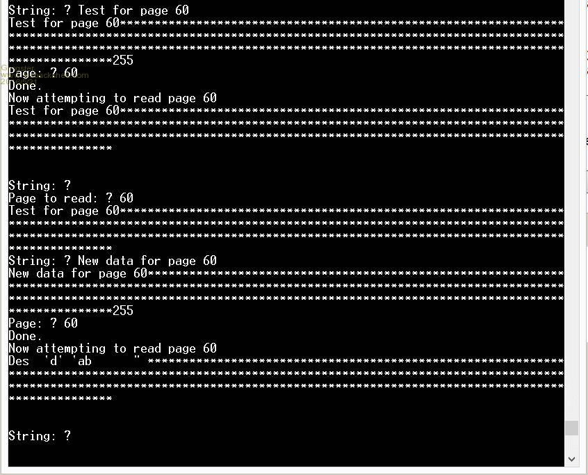

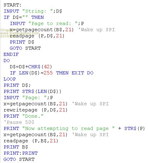

OK, my test code all off the command line, but I still cannot write to the same page more then once. I can read and write though, so that's progress!
My code:

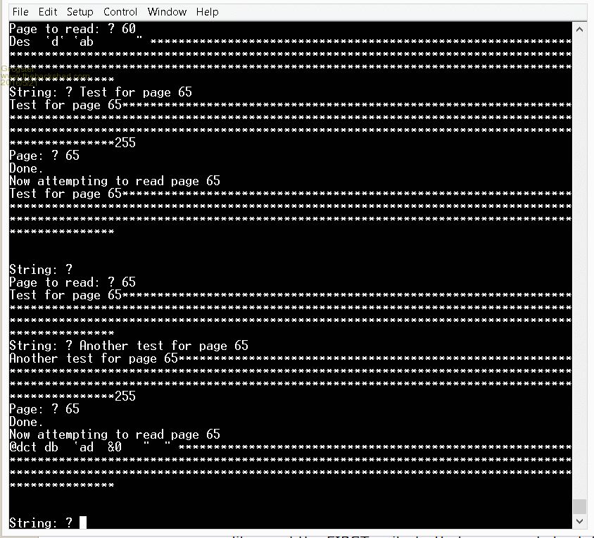

My results - note how I can write and read page 60 in this example fine the first time around, but if I try to write to page 60 again, it is corrupted:
So, it is working, but I can't make it write anything different to the same page more then once. I can select any page number I like, and the FIRST write to that page reads back fine(as many times as I want), INCLUDING previous tests to other pages, but if I try to write something else to the same page, the readback is corrupted as in the image above. I suspect the writing routine, cos the readback is always the same, even though it is corrupted. I have no idea why that should be.
I can readback any page at will by just pressing ENTER when asked for a string, and that also returns corrupted data IF I have tried to write to that page more then once. It makes no difference if "'x=getpagecount(B$,21) 'Wake up SPI" right below "Now attempting to read page" is commented out or not.
This keeps all my testing inside a running code, no nothing on the command line anymore.

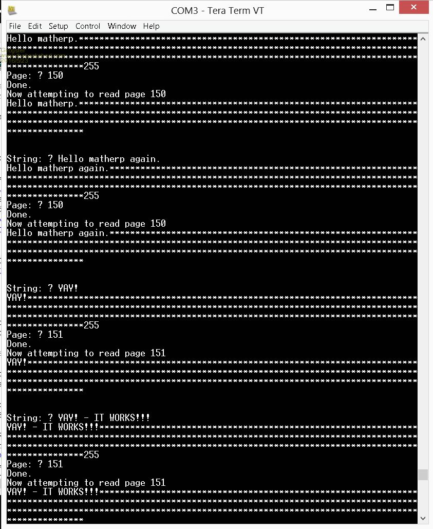

EDIT: Here is another example with page 65 this time:
Posts: 12091
Posted: 04:47am 21 May 2016
  Quote  but I still cannot write to the same page more then once. I can read and write though, so that's progress!
This is how SPI flash works. It is erased to all &HFF and then writes can change bits to 0. You can only get them back to a 1 by erasing the page. Pages can only be erased in blocks of 4K
To re-write an individual page you would have to read in the requisite 4k block, erase the block and then re-write the block with the new page updated.
I hadn't understood this is what you were wanting to do. Give me an hour or two and I'll write a block erase CFunction

In this demo I've added a new function rewritepage.
This takes the same parameters as write page: the page to write, the data to be written, and the CS pin number. It works by reading the sector (16 pages) containing the page in question into buffer memory (4096 bytes) and then erasing the sector. It then re-writes the sector with the original contents except for the page requested which is replaced with the new data. Of course this takes quite a lot of I/O so it does take some time (approx 60msec on a Winbond 25Q32)
This took very little time to write but ages to debug because....
WARNING
If you are using a flash chip on a TFT display you must ensure the CS pins of the touch controller and the SD card (if inserted) are held high. This is done automatically if touch and SD are configured (OPTION TOUCH etc.). Otherwise it appears electrical noise can cause the touch controller to just very occasionally result in miss-reads from the flash.
NB I've added a simple Basic subroutine to initialise the I/O and optionally erase the chip. This should work whether or not the Touch and SD card are in use as long as their CS lines are held high

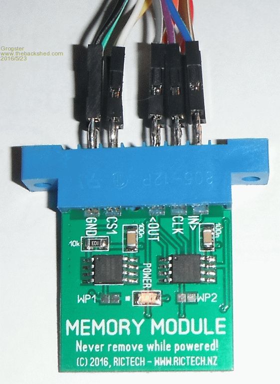

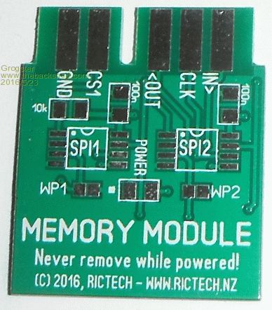

Oh, matherp, you are a champ - this is working perfectly.
I don't care about the 60mS sector rewrite time - anything less then 500mS is fine with me, as I am only storing text in each page, so speed is not any real concern(for me), only that I can easily store and readback pages any time I want.
...and my test code:(I ran your example code first, before I started tinkering)
...and my memory-module board:
Now I can get to work on writing the rest of the code to use this module and your Cfunction/CSub code to talk to the memory easily.

  centrex said  Grogster do you have these little boards for sale?
They are not on the website, but I can sell you some if you want any.
Flick me a PM if you want some. If anyone else reading this thinks they should be on my website, let me know and I can add them.
US$5 for two including airmail to anywhere on the planet.
They are designed to fit a standard 12-pin edge-connector socket such as these ones.
Edited by Grogster 2016-05-25
