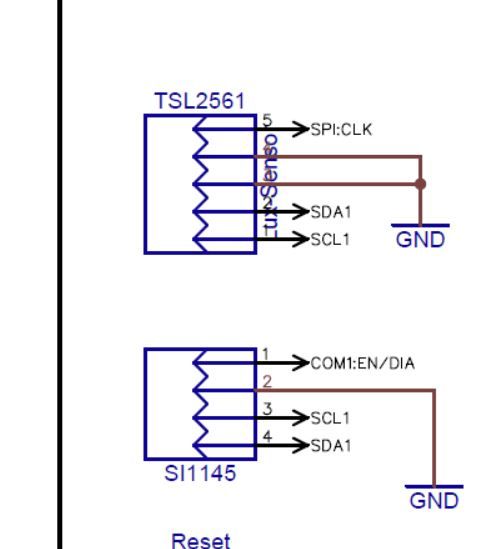

I am still wondering about the connections you used for the BME280 and TSL2561.
Are you using a breakout board for those?
If so which ones? Any other modules you are using?
Pictures/datasheet/partnumbers of those available.

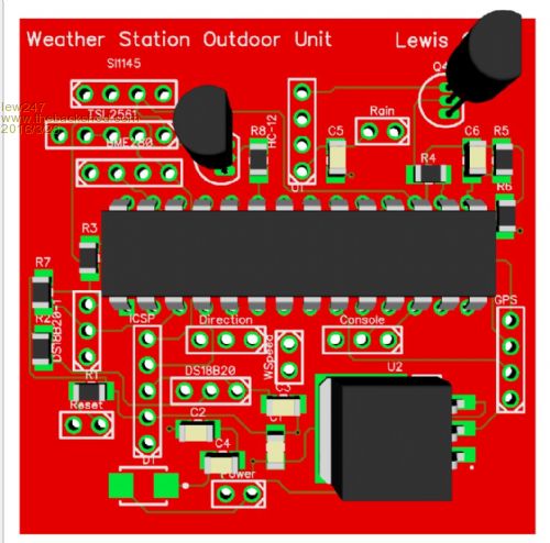

This is what i got so far:
All the screw terminals are facing to the outside of the board making connections easy. They can also be headers as the pitch is the same 0.1".
Not sure if the silkscreen for the screw terminals are right, the little dots might go on the inside, but that does only matter when the screw terminals have plastic notches that go into small holes in the pcb. I did not do that as the screw terminals i have in stock are flat on the bottom.Edited by MicroBlocks 2016-03-23

DS18B20
could pin 2 labelled Sun
could Pin 3 labelled Shade
and Rain pin 2 labelled Speed

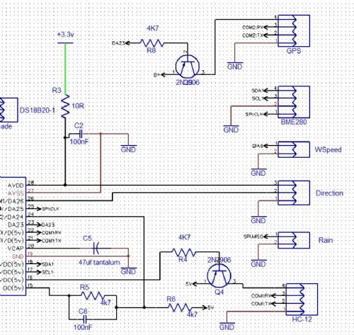

GPS needs power to go via transister/resistor/5V (or 4.7v) and pin 23
although I can use Pin 7 if you want as thats already on the board?
See image below (this is to conserve power)

On the right side of the uC there are resistors R9, R8, R4, and another surface mount part I can't make out.
These are a little close to the uC, especially if a socket is employed.
Could there be just a smidge more room opened up, perhaps by simply sliding the uC a few hundredths of an inch to the left?
HREdited by HankR 2016-03-23

I'm using a gps module which can use anything from 5v to 2.6v
I guess it would probably use a little less power using 3.3v instead of 5v
Hank it's the capacitor for the Micromite that you can't identifyEdited by lew247 2016-03-23

I hope I can persuade Lew to make a slight change in what has become two power saving switches driving the GPS and the HC-12. We've been PMing about it.
As now drawn, NPN transistors (Q1, Q2) are hooked up as "emitter followers" so it's not possible for them to deliver more voltage to these emitter driven loads than the base voltage, because these circuits have 100% voltage feedback where the output follows the input with an AC voltage gain of 1.
That's where the name *emitter follower* comes from.
For DC levels it's actually even worse, because the B-E junction voltage drop subtracts from the output, so it's going to be something like 3.3-.6 = 2.7 out (depending a little on load current and other factors).
The solution is very easy: change to a PNP (2N3906 is the exact complementary part, but almost anything works) and switch emitter and collector leads. I've sent Lew the circuit. Even if the board stays as is, a twist of the two transistor leads will work.
Hank

Hank's suggestion is a good one
All it really needs is the silk screen for the board to show the the 2N3906 pinout instead of the previous one (pnp instead of npn)
(pins reversed)

Hi Lew,
You have the emitter and collector reversed. In your schematic... (If my transistor logic has not left me far behind)

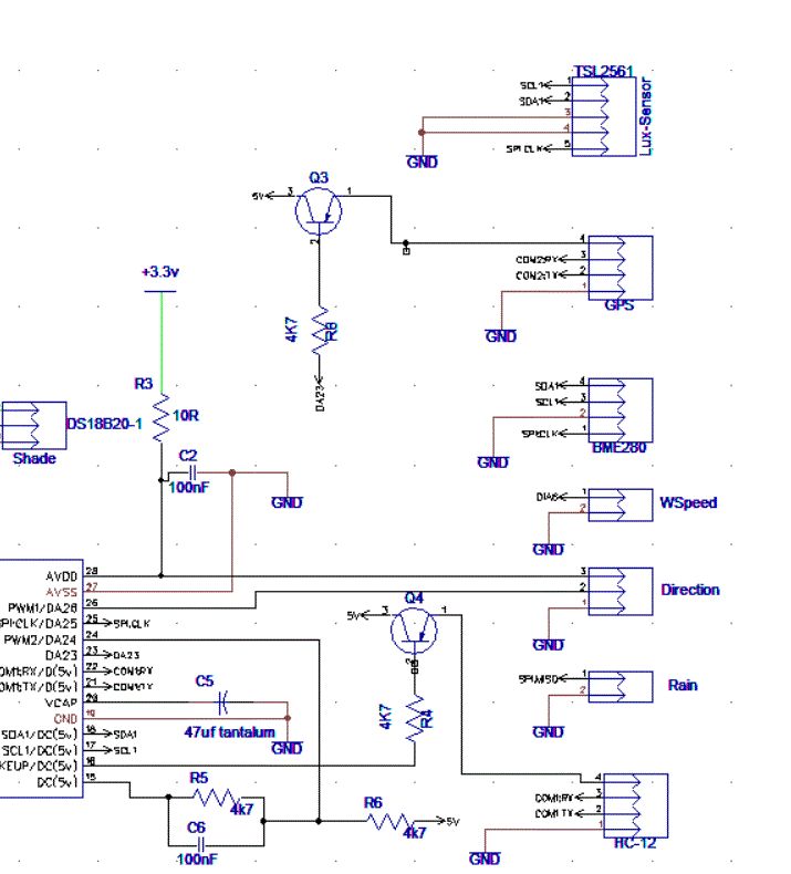

Sorry you're right
corrected below (hopefully)
I wish there was a way to delete posts that need deleting like the circuit above!!!!!
Posted: 06:34am 23 Mar 2016
When the output pin of the uMite is in a high-z state or configured as in input, what would then be the effect on this transistor?
The base of the transistor is then basically floating.
Or in other words is the transistor 'on' when the uMite starts up or 'off'?
I normally use a pullup or pull down resistor to make sure the state during startup is known. Would that not be better?

  MicroBlocks said   When the output pin of the uMite is in a high-z state or configured as in input, what would then be the effect on this transistor?
The transistors will not be conducting so the peripheral devices being controlled will not be running.
  Quote   Or in other words is the transistor 'on' when the uMite starts up or 'off'?
Based on the above statement, you'll be able to answer that question definitively, but I'd guess the startup condition of the uMite is with I/O pins floating. That in turn means the peripherals will not be running (usually a good thing).
  Quote   I normally use a pullup or pull down resistor to make sure the state during startup is known. Would that not be better?
No, I don't think so. It's an unnecessary part. If it makes you feel better you could do it.
With a floating state, the startup situation is perfect with the circuit just as it is now.

I have been looking at your transistor circuit again and I dont think it will work as you expect it to.
The basic premise is to conduct across the emitter/base to turn the transistor ON.. This means applying a LOW to the BASE will conduct across the emitter/Collector... OK that works..
BUT
The maximum voltage you can apply to the base driven as shown is 3v3 which would still mean that as this is more than 0.6v less than the emitter's 5V level that the transistor is still ON.. Personally I think a better solution would be to use some Opto-Isolators to do the job..
Open to feedback.. There are many cobwebs in my brain where I stored my transistor logic theory..

  lew247 said   Got the board a nice 50mm X 50mm now
Looks OK, but some constructive criticism....
Firstly you would not be able to use screw terminal blocks the way you have them layed out, you are limited to male/female headers (not that that is a realy problem if that is what you want)
Secondly I would increase the track thickness for all of the power rails, (5V, 3v3, GND)
I generally use 0.01" for signal tracks and 0.025" for power tracks (or 0.20" if space is tight)

  bigmik said   Hi Lew, All,
I have been looking at your transistor circuit again and I don't think it will work as you expect it to.
Mick,
You are correct with the present state of the circuit. So good catch there.
As originally conceived by Lew, the feed to the peripherals was 3.3 volts, just like the uC.
In that instance, no problem in the standard configuration shown in the schematic (except going back to 3.3 volts on the emitter) which is used all the time.
uC output pin low = switched loads supplied with 3.3 volts (across load terminals) and current.
uC output pin high = switched loads have no current.
and, just to be thorough,
uC pin floating = switched loads have no current.
To stay with 5 volts going to the switched loads, a circuit mod using only one more transistor and resistor will do it nicely. Details in a later post.
