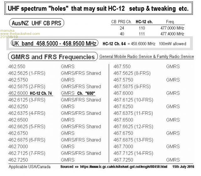

Agreed ! As HC-12 cover >100 "channels" at 400kHz spacing a further benefit is that they may feasibly suit use on other frequency spots, some with higher power.
The legality of this should of course be verified, but reception (at least) on several UHF CB channels is possible - see attached summary.

Aside from NZ/Aus UHF "PRS", several UK & USA spectrum slots match up too. At the very least a cheapie UHF CB set can be used to check if your HC-12 transmitter is actually working,along with it's range,duty cycle & antenna/elevation benefits etc. Stan.Edited by manuka 2017-08-20

OK- is your neighbour running the old 27 MHz CB or the now normal UHF "PRS" ? At UHF elevation can be the deciding factor & better coverage tends to relate to elevated signal take off rather than transmitter power.
I'm happy to help with HC-12 extensions, as I too consider them real sweeties. The attached compares them with classic 433.920 MHz ASK devices. Stan. (also a "retired" ham -ZL2APS since 1966)Edited by manuka 2017-08-20

  Alastair said  Have you encountered any problems with interference in & out with other rf devices? This aspect worries me somewhat with the vast number of wireless devices we have around us now. I connected a long piece of wire to the input of my cro and turned the FFT on. There are certainly lots of signals around the place!
I have not encountered ANY interference issues at all with the HC-12's I have used.
The trick is to use a band that many others may not even know about as manuka was showing in his images.

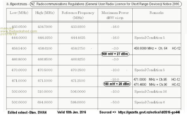

Here in New Zealand, I use the HC-12's on channel 64 as he was showing(458.6MHz) as there is a nice little unrestricted slot of frequencies there at 458MHz where you can run up to 500mW of power
This applies to New Zealand - other countries would need to check their own regulations.
Anyway, at 458.6MHz, I can run the full 100mW output power, and with a 1/4 wave whip on the receiving end, and just the tiny supplied 433MHz helical on the transmitting node, I was getting very reliable transmissions out to about 350 meters - THROUGH WALLS/BUILDINGS/WET PLANT LIFE. One city block, really. This is excellent performance for the price of these things.
Just to be very clear: 1/4 W 433MHz SMA antenna(which is a 20MHz mis-match!) on SMA-U.FL adaptor lead plugged into receiving end HC-12, INSIDE house. Walking around with a polling transmitter HC-12 node and an RT to talk back to a helper at the house to tell me if the transmissions were getting there or not, and just holding the transmitting node in my hand and putting houses and plants in the way, all the way, as I get further and further down the road. The helical antennas I was using were 433MHz antennas, so I cut 1.75 turns off the end of it to re-tune the helical up to around 458MHz, but that was the only "Mod" really. I have no doubt that up high with decent tuned antennas at each end, you would get the 1.8km they claim they are capable of.

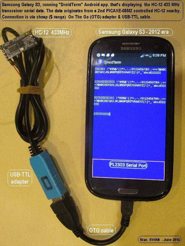

FWIW it's possible to link HC-12 to a smart phone too - proof of concept shown below
