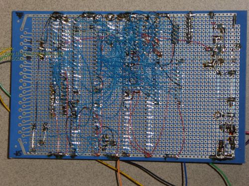

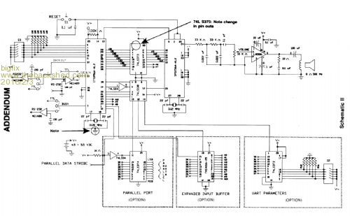

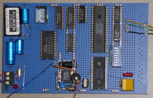

I have a version which does not require holy water or any C-Code !!!
It is THE original maximum version from Radio Shack parts built with WireWrap
I have no detailed memories about it at all, I believe I built it in the mid 80s
while I worked at DEC.
Soon after I got a scrapped DECtalk - which was the Rolls Royce of Voice HW...
So I shelved it and completely forgot it until just now...
cheers
Guenter

Hello,
very nice old fashioned project.
Unfortunately this brings me back to very old memories.
It could be nice if you are able to make alive again and give us the joy to hear its voice.

bigfix, does your SP0256 circuit still work? I got one of those chips too and have used it with a Basic Stamp and a Parallax Propeller but I had to use a colorburst crystal.
Last year I was lucky enough to come across the crystal and the CTS256 chip used in the circuit you made. I just need to get the latch ICs to build it.

Right now I have a complete mess here, as I try to sort the unfinished piles in my electronics room into meaningful heaps...
But I will try to reverse engineer what I did 30 years ago and post the outcome here
