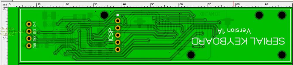

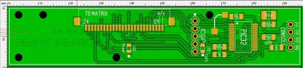

Posted: 12:54am 24 Aug 2015
Crafty idea using the 4017 counter.
Here is my version:
TOP LAYER:
BOTTOM LAYER:
This board is designed to directly replace the existing Bluetooth board.
Remove the securing screws and FPC cable, plop this board in it's place, and replace the FPC cable and screws. This board will then output plain serial for any key pressed at 19k2 baud.
This one is not near as fancy as your one TZA, but it is a start.
3v3 supply from the host system, as my concept is designed to work in close proximity to the host, rather then on a big long cable, so one meter or so is all the cable I have allowed for.
That, and I was too pressed for space to fit a 3v3 regulator!
I could get the reg in there, but there is no real-estate left for routing tracks!
Posted: 01:23am 24 Aug 2015
Looks great and when it replaces the current pcb all the better.
Instant keyboard!
Would it be possible to salvage the powerbutton and connect button?
The connect button would be a nice 'reset'
Also maybe use the bluetooth location to blink a led when a key is send. This will give you a visual confirmation. Maybe the charge led as a aid for debugging. Visual clues are nice to have when testing.
