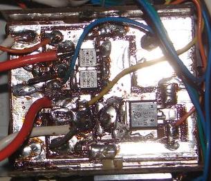

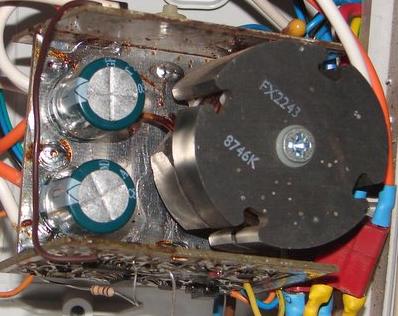

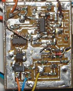

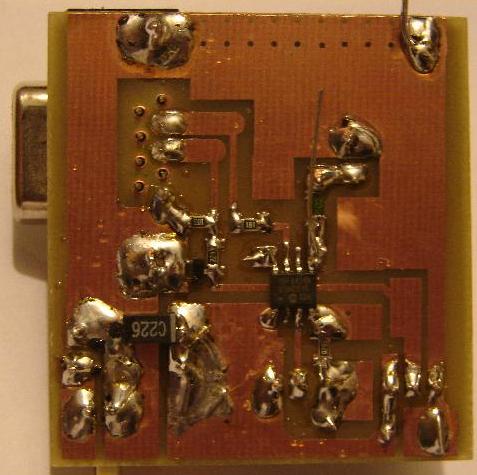

I have attached some photos. I have described how the cct works in previous posts.
pic 1...mill in operate mode, red light ON means caution when working on mill.
pic 2...mill in brake mode. green light ON means safe to work on mill.
pic 3...cct includes control 12v supply, modulator and fixed low end current shunt.
pic 4...cct includes swithing transistor and steering diodes and bypass caps.
pic 5...topside of pic3 showing input and output main filter caps and pot core inductor.
pic 6...cct includes voltage controlled shunt and mill overvoltage detection and protection cct.
I think you can see that the construction should not be breadboarded. each of the cct boards require screening with an earth plane to reduce coupling that causes detrimental feedback.
