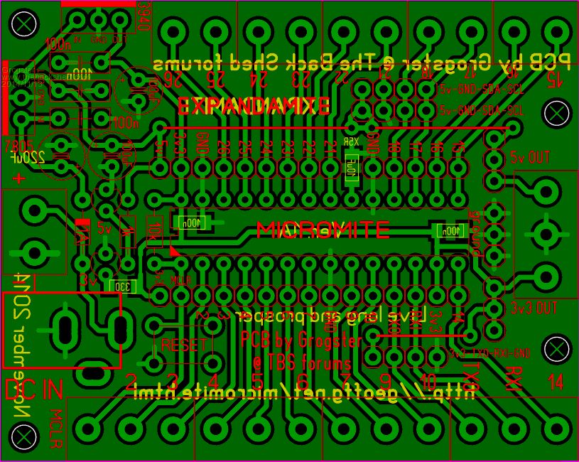

Please nudge the 5v output trio, the ground trio and 3v3 output trio near PIC pins 14 & 15 to be on the same 0.1 inch grid as the rest of the "mini-shield" pins. You don't want to go down the *cough*duino route where a 50mil screw-up becomes a new standard.
Posted: 01:16pm 12 Nov 2014
  TZAdvantage said   Yeah. I like it!!
Just a consideration for you to make about the parts used.
You have the 100n capacitors in through hole and smd versions.
Would it not be better to make all of them smd.
It will make the BOM smaller and fewer types of parts are needed.
Making it easier for someone to source the parts and a little cheaper as more of a single part can be used.
I could do that easy. The reason for thru-hole 100n's was to make it easier for to build for those who do not like SMD. Any boards I was going to supply(if any) would have the three SMD parts pre-fitted.
[Quote=TZA]I would change the silkscreen for the t-blocks slightly.
On the bottom (pins 1-14) I would use four 3-way blocks and on the top five 2-way blocks.
That IS a good idea, and I had not spotted that. Much neater to change them as you suggest.
  Quote  Is the 1k resistor on the mclr enough to the left to allow a dip socket?
Maybe, maybe not. Will see if I can re-arrange for more space there.
  Quote  The power LED is now on the 5v. This will indicate that 5v is available but not if 3.3v is available. You could add another led, or change the connection of the led to the 3.3v. This would then indicate that 5v and 3.3v is available.
I can shoehorn an LED in for the 3v3 rail somewhere.
  TZA said  And just for kicks. :) Add another pin for 3.3v to the console connector and make sure the order of the pins is right so that Geoffs vt100 terminal ( http://geoffg.net/terminal.html ) can be connected and powered directly from your board.
Not an insane idea - will see if I can squeeze that in too.
  TZA said  :) Already getting tired from me? :)
You are a fountain of ideas, ain't you, TZA?! (rhetorical!)
Posted: 01:20pm 12 Nov 2014
@ atmega8 - will upload a ZIP shortly, which will have ALL files in it, including the raw LAY6 file for Sprint Layout 6.
Posted: 01:28pm 12 Nov 2014
@ centrex - Design by committee. Something I always promised myself I would never get involved in, but here we are.... Still, despite that, some good ideas have been flowing. Perhaps the best one yet is atmega8's one - post the files, and then let people change the basic layout how they want - I think that is probably what I will now do.
@ vegipete - well spotted. Will nudge.
So, last round of changes, then I will upload a ZIP with all the files in it, and people can do whatever they want. Make it as-is or change it to suit themselves.
I will probably still be getting some boards made, so if anyone wants any(with SMD fitted), then flick me a PM.

Hi Grogs,
a tiny suggestion - how about a 1K ohm on the Rx console input to protect against 5v USB to serial adapters?
Greg
Posted: 02:40pm 12 Nov 2014
OK, will have to be SMD though.
EDIT: No room. While I can fit one between the T-blocks and the chip, that does not cover you if you use the headers. I will upload ZIP shortly, and then let's call it quits! By all means, other members can download the layout, and change it to suit their purposes, as suggested by atmega8 - better then me changing things all the time.
OK, here is the final:
I've aligned the right-side t-block and headers for power, to a standard grid(0.3175), moved the 10k for MCLR slightly to the right to allow for IC socket, added 3v3 LED and resistor(SMD), and changed the terminal header to four-way, which is pin-compatible with the VT100 terminal board.
Here is the ZIP file:
2014-11-13_011240_Expandamite_1A.zip
This file contains all the gerbers, the Excellon drill data, the original LAY6 Sprint Layout file, the GIF image, and isolation milling CNC files.(mirror, drill from copper side, mill from bottom side, single pen(drill) size for holes as a pilot)
Do with it what you will!!!!
Edited by Grogster 2014-11-14

Hi Grogs,
Design by committee can be never ending..
I know you are near done BUT.. IF you add a pad on pin 28 of the pic you could then link it to the Vcc connection of the I2C for 3v3 operation and the 5v link can go the full distance.
You still end up with 2 links but have the option of 3v3 or 5v i2c.. If you cannot juggle a bit then these links need to be insulated.
Posted: 05:29am 13 Nov 2014
I think there is even room to put 3.3v pins next to the 5v pins and have bot voltages available. :) :)

Posted: 11:27am 13 Nov 2014
TZA wrote
  Quote  The ICSP connector might be just a little to close to the mcu. You might not be able to plug in a pickit directly.
Grogster wrote
  Quote  I have done away with the ICSP header at the suggestion of Rob.
@ Grogster
I now use the low profile socket strip from Altronics for these connectors. I first bend the pins at right angles then solder to the board, much smaller than the vertical or right angle header. It is then just a matter of plugging in a row of header pins to the socket and connect the PicKit3.
PaulEdited by palcal 2014-11-14

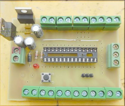

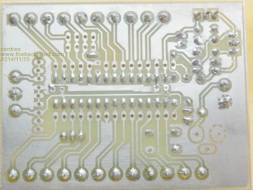

I hope you take the attached pictures as a compliment to the excellant job you did with the expandamite.
Below is my version using your layout.
I use a very old program for board layouts, it is called Traxmaker, it was developed for windows from a dos based version.
The board is close to your dimensions, all done to a 0.1 grid with a 25mil snap to.
Unfortunately I do not have the special cap req for the 170 micro.
Anyway here they are.
The board is made with Riston coated pcb, which is hard to get in Sydney as both sources are no longer...
regards
CliffEdited by centrex 2014-11-16
