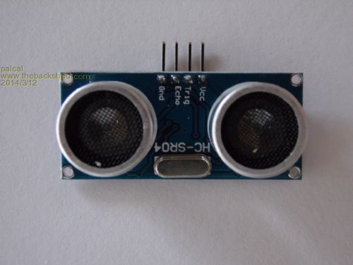

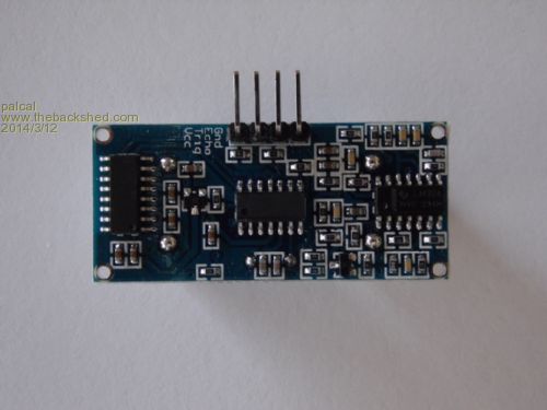

Here is a picture of my module.
Paul.

Posted: 01:04pm 12 Mar 2014
My HC-SR04 module (4 pins) looks similar to your photos until you study the component layout. I will try take photos of my module and post them so you can see how much the Modules do actually vary.
