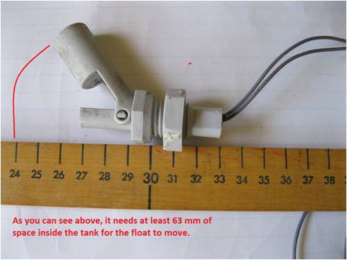

I have attached a photo of one of rhe Float Switches I bought from JayCar.
But it only has about 15 mm of Hystersis.
This means that when the water level falls to the point where the contacts close (and starts the pump running) the water level only has to rise about 15 mm before the contacts open & the pump stops.
So if you have a narrow tank (eg. a length of downpipe) then the pump will be starting/stopping frequently.
If you want it to run for a longer time & therefore start/stop less often, then you will need either a second Float Switch (one to start the pump & the other to stop it) or a simple timing circuit to keep the pump running for a longer time each time it starts.

Len, looking at that float switch it appears easily modified for a greater hysteresis.
All you need to do is find a PVC or poly tube to fit over the barrel like float very well. Fit a cork to the end of that and your new water level range is set by the additional tube length.
The switch is shown upside down BTW, the moving part has to hang down and float up - when it lines up the switch operates.

That's a good idea.
But the length of tube will depend upon how wide the tank is.
It may even be useful to attach a weight at the end of the tube to make it less bouyant.
I did not think about which way to orient the FS before I took the photo.
However, I think the orientation in the picture is correct as you want the contacts to close when the water level drops & to open when it rises.

You may be right there Len , but as it very much looks like a switch for a bilge pump and I'm a sailor I'd want it to close when the bilge water gets too high

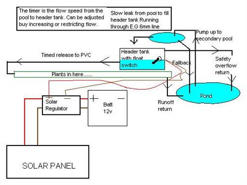

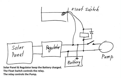

Please excuse the electrical wiring for the battery it just gets in the way a bit.
Gotta love Microsoft Paint! I can sell you a full colour print of this for $24.99! Haha
Hope you like the idea anyways! I think its decent. Please pick out any areas that may cause issues and comment/trouble shoot anything that comes to mind. Pretty sure this is what you lot are basically getting at. Forgot to mention I am adding a pump into the header tank as its cheaper than a valve. Float kicks it off. If it doesn't the header fills up into the overflow returning back to pond as a precaution.

I don't fully understand the diagram.
How is the Timer & Pump wired?
Why is the Float Switch connected to the Solar Regulator?
Note that you don't want the Float Switch to switch high currents.
It should control a relay so the relay contacts switch the high currents.

Thought the regulator handled any outgoing electricity used while the panel is still charging the battery. Correct me if I am wrong. I'm just looking at regulators on ebay and that's how this particular one is wired up by the looks of it.
Also...How come I cannot edit my posts any longer? I want to re post my picture. I can only edit the last one posted now?
Anyway I will add this to my diagrams. The 2 pools of water are like this and imagine this it happening via a solar pump on its own circuit just turning the water up and over or filtering for the fish or whatever...
You fill your header tank somehow from the higher smaller pool. I recon tap into it from underneath with slim 6mm line or something for a slow fill over a few hours to reach the dropping point for the float. Header would sit somewhere at mid height between the 2 pools. Run it off and back into the lower pond.Edited by Lapsy 2012-03-13

The regulator will control the battery charging, but I doubt if it would have an input for the Float Switch.

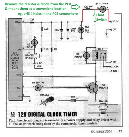

I have attached a modified Timer circuit that shows you how to modify the PCB to make allowance for the Float Switch.
There appears to be plenty of vacant space on the PCB so you can drill a few 1 mm holes for the Diode, Resistor & connector.
Interconnect them with hook up wire of some kind.

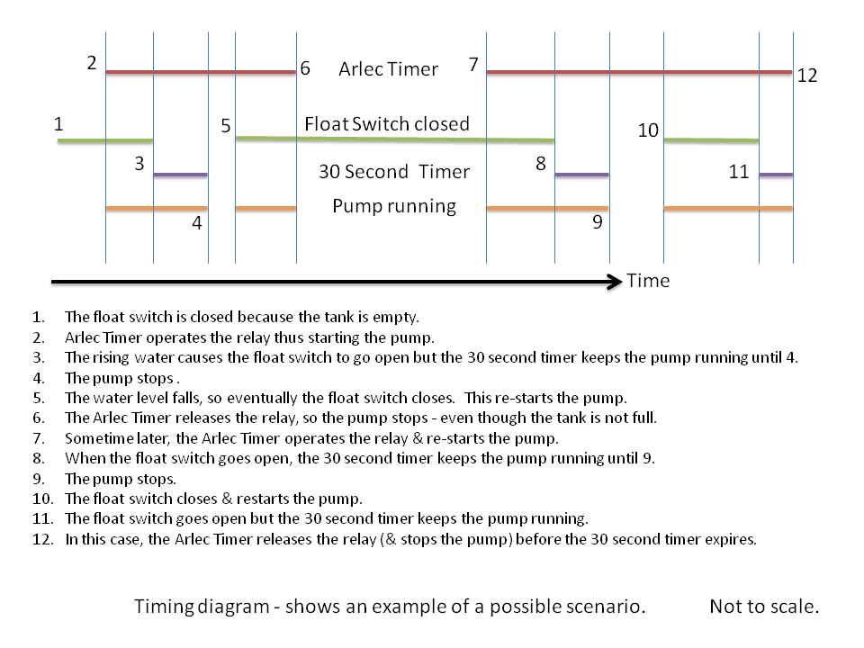

I will design a simple 30 sec timer for you that will hold the relay in your Arlec Timer operated for an extra 30 seconds as requested.
What I believe you want is as follows:-
1. The Arlec Timer will operate the relay to start the pump.
2. When the water rises to the point where the float switch goes open, the 30 Sec timer will start.
3. The 30 sec timer will hold the relay operated for 30 seconds. Then the relay releases & the pump stops.
4. When the water level falls to the point where the float switch contacts close, the relay will re-operate and the pump will start again.
5. When the water level rises and the float switch opens again, go to step 3.
Is this what you want?
Len

Posted: 10:25pm 05 Apr 2012
I'll concentrate on the electronics & leave the plumbing to you.
I have attached a timing diagram of a possible senario.
I buy my parts from Semtronics as they are cheaper than the others & are located only about 2 km from where I live.
I'll send them an email & ask for the prices of the parts.
Len

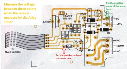

Posted: 02:00am 09 Apr 2012
Please measure the voltage as shown in the attachment.
I need you to measure it when the relay is operated by the Arlec Timer.
I don't need to know what the voltage is when the relay is released as it will be 0.
Len
Lapsy
