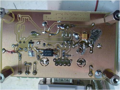

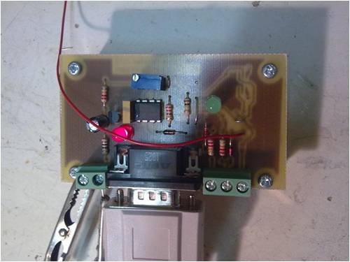

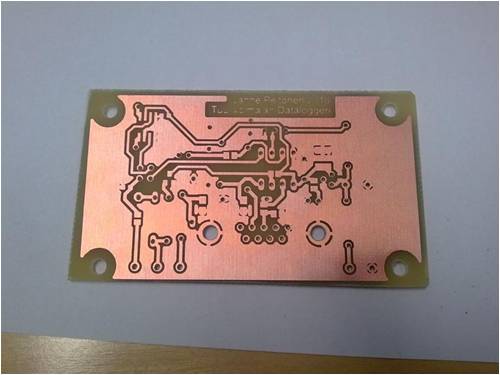

I just finished my own version of the datalogger, a couple of pictures of it are below. It's doesn't differ too much from Glenn's board, just some things are routed to different picaxe inputs but the principles are the same. And instead of using a normal current shunt, I'm just going to use the negative cable from the rectifiers to get current data.
I was thinking of using the piclog2 to do the logging. It basically has everything I need in one package, bells and whistles included :) One question though.. As the piclog by default saves data to log every 10 secs, but the default picaxe hardware sends data every 2 secs or so. Is it so that the logger software will average those recordings received during the logging cycle, and then save them to the logfile? If not, I was thinking of adding some sort of averaging to the picaxe firmware, and to do more measurements over the 10 sec perioid.

very neat work there Janne .... sorry for coming in after you post

Posted: 11:08pm 24 Sep 2010
Very nice work Janne.
How was the board etched, Positive resist?
Pete.
Posts: 5200
Posted: 11:48pm 24 Sep 2010
Hi Janne
Yeah nice work.
Niall's suggestion to ad a smal cap across the optocoupler input is a good one. The PicAxe is quick enough to pick up the rectifier "hash' at cut in speeds, a small filter capacitor can help smooth them out.
Yes the PicLog2 does average out the readings over the log interval. The more readings per log interval the better as a rule, but it does mean small spikes in power from gusts of wind will be averaged out. The standard PicLog circuit will send data every 2 to 3 seconds, so a 10 second log interval means its averaged 3 to 4 readings, which is good enough for every day use. The PicLog2 will read a faster modified PicLog circuit too, I've tested it to 30 data readings per second, and it sucessfully processed every chunk of data and averaged it out correctly.
PicLog2 uses a 1 second timer as its main trigger event, meaning it will process everything once a second. It will read in and process 30 odd records in that second second, but if you wanted to have it log the data to file any faster than once per second, you would need to change the 1 second timer to a smaller value. This will work, but that one second timer is also used for a few other house keeping functions, so its not recomended.
Janne
Joined: 20/06/2008
Location: Finland
Posts: 121
Posted: 03:24pm 25 Sep 2010
Thanks for the replies. It's nice the piclog does averaging as well, reducing the overhead the picaxe has to do.
The 100n cap sounds like a good idea, and easy to add too now as it's still on my work bench. Thanks. I've used the same hardware before to read RPM on my MPPT board, but in that version the RPM is read by calculating the time between zero crossings using interrupt, so the slow polled interrupt of the picaxe system automatically filters out any ringing from the rectifiers. But with the count command the input should pick up almost all noise, so some filtering is indeed in order.
I made the pcb at work, using the positive resist method.. Nothing hi-tech in there, just an UV box and a couple of jars with chemicals, but it's good enough for me to ocassionally borrow on hobby projects :). The name of the board and maker got kinda faded away, I think I forgot the board in the sodium hydroxide(developer) for a tad too long. One good reason to include some text is to know that you have not accidentally put the exposing film in there mirrored... happened to me a couple of times too often in the past. Nowdays I prefer to use SMD components where possible, as drilling the holes with the manual drill machine is a real pita.
I also discovered a problem with my plan of using the cigarette ligter adapter(the link mentioned in my previous post).. As the adapter lacks ground isolation, it's not possible to have the logger board anymore at the "lower" potential, the shunt would effectively be shorted via the serial port ground wire on the computer. So I'm going to have to plug in the inverter, with the normal brick psu to get isolation for the computer power supply. Good thing this dawned on me before letting the smoke out from the serial port!
edit: it seems like it's no longer possible to edit my old post.. If possible it would be nice if some of the moderators would add a note to the end of the post warning about using that lighter adapter, because of the lacked isolation.
Edited by Janne 2010-09-27

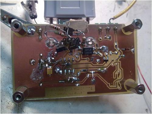

Janne
Joined: 20/06/2008
Location: Finland
Posts: 121
Posted: 11:06am 27 Sep 2010
After mulling over the problem a bit, I think with this version i can circumvent the ground problem by isolating the serial interface from the logger board. To do this, I'll just grind off the ground connections from the serial connector, and use an optocoupler to drive the serial line. Pull-up voltage can be stolen from pin 4 on the serial port.
A dirty solution, but should work. Generally, I think a high side shunt would make life easier, as it would remove the confusing setup with multiple ground levels.

Janne
Joined: 20/06/2008
Location: Finland
Posts: 121
Posted: 08:03pm 01 Oct 2010
I did the mod I described in the previous post, so much for the mr. nice board, but hey, at least it now works :)

Posts: 5200
Posted: 09:42pm 01 Oct 2010
Hi Janne
Yeah its ugly, but its also very clever.
Are you using a negative rail regulator, like a 7905, to give a -5 volts with respect to the 12v, and using that as the PicAxe's ground connection?
Using a positive side shunt resistor is a big plus, well done.
