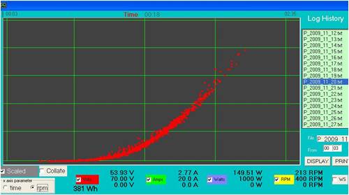

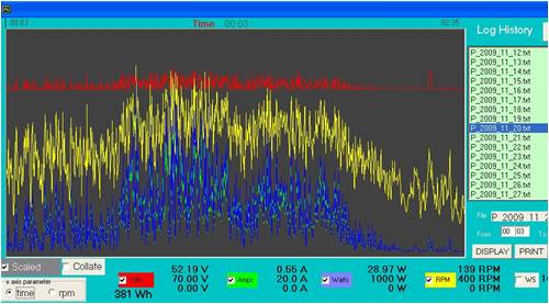

For those readers who may not be aware of how valuable the ability to directly view past or real time data from say the time based version, and a power v rpm base, here are some examples of the same data set, viewed both ways. These can be clicked between each view, for any part of any day over any period in the day.
The RAW logged time based data is pretty standard.
and this is the power v rpm for the same period.
The view also gives a relative feel of the wind energy distribution.
I see this as a most valuable tool and anyone that has built a windmill, or has an interest in windmill performance will realize this as well.
Gordon.

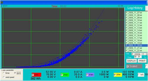

As an asside, here is a plot of my windmill[raw power output data] plotted against windmill rpm, in comparison with a plot of a cubic function. The windmill follows a similar cubic output. I have no way of proving the power matches the windspeed, but at least the 2 graphs are doing similar things. This windmill had a cap doubler, and series caps in place. This is now my reference graph.
I would expect that most windmills with a good loading reigime will follow a similar profile.
Gordon.
PS: the blue does not show well, so I will make the reference cubic function red, so it is more clear.
