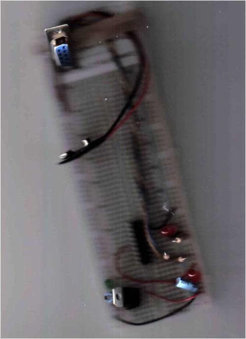

I ordered and received a picaxe 18x with the breadboard and serial plug also a 9 volt battery socket all wired to blink the LED's I plugged in the battery and no lights.
I immediately checked the battery to make sure it was snapped in and burnt my finger on the 1N4004 heat sink.
I quickly Disconnected the Battery. It too was so hot I thought it would blow up. Back to the drawing Board for the distributor. I'll probably have to eat this one.
Many years ago I had a Compac < brand)Computer built like a suitcase with handle. It had a 21 meg. hard drive, 64 kilobytes ram.
The operating system was basic and I learned some of the commands that are used to program the picaxe. I chose the 18 X because of the GOSUBS = 42 and several inputs. it cost about a dollar more than the O8-M , A lot of places to POKE and PEEK, I suspect that poke and peek refers to
memory locations on the chip rather than pixel locations on a monitor as was the case with the compac.
You are doing a worthwhile service for many more people than you will know about. RoeEdited by Greenbelt 2010-01-20
Posted: 03:42am 19 Jan 2010
Greenbelt,
Hmmmmmmm!
Look like a problem??
A 1N4004 is a diode and have never seen one with a heat sink??
What battery voltage are you using??
Do the board have a voltage reg? (LM7805) ( i am guessing this is what was hot)
If the reg was hot then it may well be in the wrong way around or your battery was reversed.
Firstly remove the 18X from the board and then try to trouble shoot the power problem.
You need to have 5 volts supply to the 18X Ic pins 5 and 14. pin5 = 0v and pin14 = 5v.
All might not be lost just yet as they can be tough little buggers but then i have mannaged to kill a few.
If you can give a little more information we might be able to get you back on track.

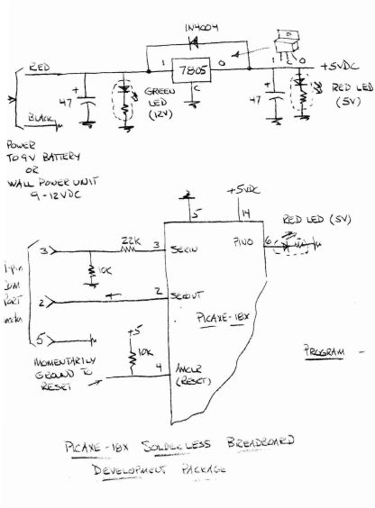

The problem is yours Truly. I took a better look at the little Drawing that came with it -I now see that what I thought was a detailed internal circuit for the pictured
voltage reg.with no connections and quickly concluded
the large number above the diode was its ID. The little arrow pointing at the box. its been sometime since I
messed with a circuit. I should have remembered that
the 1N-- prefix indicates a Diode, or maybe not anymore. and yes The LM7805 is right where it should be. I'm using a standard 9 volt dry cell Battery. when I get some time I'll Check it Out. My Clothes Drier on a stacked system went on the Blink, Man what a Pile of Screws to get in to the blower fan!! When Things are broke, life is not good around the house. Blower Fan is plastic,
Hub wallowed out on the motor shaft. Thanks for the Tips--Roe

I found a small cap has a broken lead, it has the appearance of damage in shipment, things are bent to one side, laid over as if something heavy rode along on top of it.
# Solderless Dev Package - 18-pin consisting of 830 point solderless breadoard, serial connection to solderless breadboard, PICAXE-18X, 5VDC voltage regulator and associated capacitors and monitor LEDs, 9V transistor battery connector (battery not included) and 22 awg solid hookup wire suitable for use with a solderless breadboard. Assembled and tested with blinking LED example. This is the same as the package for the PICAXE-08M except it uses the PICAXE-18X. Includes one PICAXE-18X. $24.95 US Only.
Edited by Greenbelt 2010-01-21

Now your sad sorry board
I had a look at the kit you bought and can only see a photo no schematic.
It aint rocket science and the cap thats damaged is only on the voltage reg part of the circuit.
What is the value of the mangled cap??
Would not mind to see the instructions you got with the board if you are able to post them or pm me for an email address if thats easier.
Think we can get you back on track.
Dont know if you have used a bread board before.
The one you have has 2 power rails either side of the board that run length wise to the board and the other inner rails run cross wise to the board.
Some how you wired a dead short across the vreg or inserted/wired it backwards to cause the problem you had.
The damaged cap would not cause the problem of making a heater.
Unless you inserted the cap backwards??
The easiest way to sort this out might be to piss the vreg and caps etc off.
Get 3 x AA batterys and tape them together to give 4.5 volts and use them for now without the vreg etc.
The picaxe will work fine down to 3 volts but must not go above 5 volts.
This way you will only end up with the 18x, 1 x 10K resistor, 1 x 22K resistor the programming socket, and the led.(you can even leave the program socket off for now to)
Plug the positive battery wire into ic pin 14 of the 18x and negative into ic pin 5 of the 18x and all being well you should have a blinking led.
From what i can see the led will need a positive wire connected to the other leg ( flat side of led towards the 18x)
Ensure the led dont have both legs plugged into the same rail or rails used by another pin.
Use one of the 2 outer rails for the other led leg and run a positive wire to that rail.
Pete.

I have not used a breadboard but i have it figured out.and I don't anticipate having a problem with the board.
The only thing I did was plug on the battery. no kind of
rewiring or alteration. I checked the diode, It is shot.
the 7805 is definatly blown. I will get back to this in a couple days when i can concentrate here is the drawing

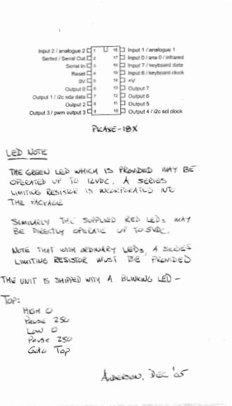

that came with the board its in pencil and didn't scan
very well. also I recently had computer problems and have lost the driver for my digg Camera so I tried to scan the board, Didn't work as you can see.
Edited by Greenbelt 2010-01-22

Greenbelt,
The 1N4004 diode dont need to be in the circuit to start with for this application so get rid of it we dont need it.
It takes a lot to kill a 7805 voltage reg so can only think someone has wired your board incorrectly to start with.
The 7805 has thermal protection so if you just had a short after the reg it would get hot and shut down and the diode should not be affected.
At a guess i think the leads from the battery might be connected to the board the wrong way around.
With a bit of luck the diode may have taken the brunt of the load and fused closed circuit and protected the 18X.
Worst situation is you own a nice breadboard and need some new components to plug into it.
Just disconnect one of the power wires going to the 18x before testing the v reg circuit any further.
Will wait to see what you find when you get back to it.

Downwind;
Your Right my man!! The Battery connector still has the rubber band around the dangeling wires as it came from the vendor.
