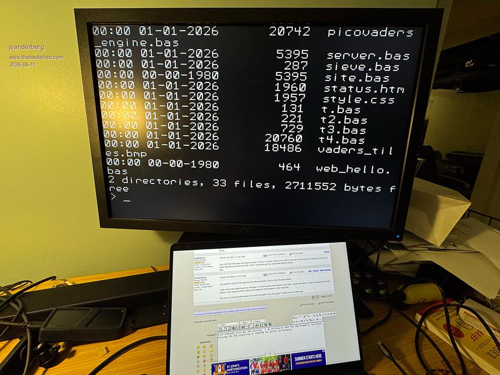

jvanderberg
Joined: 06/05/2026
Posts: 86
Posted: 08:48pm 10 Jun 2026
Glad somebody else got VGA working.  I am working on some VGA improvements, including driving the VGA signaling at 320x240 for better performance.
I've got it working on my 15 year old Dell 30" monitor, so it should be pretty compatible.
gadgetjack
Joined: 15/07/2016
Posts: 240
Posted: 09:48pm 10 Jun 2026
I have that same monitor on my shelf. I use it a lot for testing.
