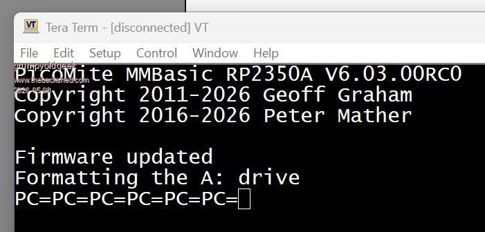

Amazon Beetle is probably not a good choice.
https://www.amazon.com/dp/B0F5PQMT6S?ref=ppx_yo2ov_dt_b_fed_asin_title
Runs the V6.02.01 firmware after loading it twice.
Locks up and gives this with V6.03.00RC0
Edited 2026-05-08 06:33 by grumpyoldgeek
Posts: 12055
Posted: 09:38pm 07 May 2026
The RP2350 code won't run with only 2Mb of flash. The Pico2 has 4Mb which is the lowest required. If you could swap the flash chip it would probably be OK
