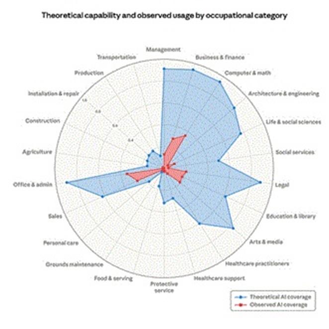

Posted: 05:11pm 08 Mar 2026
A chart giving estimated scope of AI usage in the economy, and reported so far:
Chatgpt-5-4 announced this week:
"The performance gains arguably deserve a bigger version jump. Models that can maintain state across long, multi-step tasks is the kind of breakthrough that would justify the moniker of GPT-6." AI Productivity (My favorite AI analyst)
