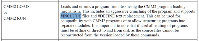

The PicoMite manual has a CMM2 LOAD command which mentions "#INCLUDE".
But "#INCLUDE" produces an error:
[11] #INCLUDE "jobrec.str"
Error : Invalid character: #
#INCLUDE would be useful for having a file which contains a structure for a file of structured data.
Edited 2026-01-08 02:22 by lizby
Posts: 12057
Posted: 04:45pm 07 Jan 2026
#include only works within a file being loaded by CMM2 LOAD or CMM2 RUN

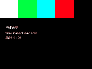

Test code for colour map on LCD (tested on ILI9341, running 5.09.00rc5 that supports colour map on lcd).
framebuffer create
framebuffer write F
dim col%(15)=(0,0,0,0,0,0,0,0,0,0,0,0,rgb(white),rgb(green),rgb(cyan),rgb(red))
dim indx(3)=(12,13,14,15)
dim paint(3)
colour map indx(),paint(),col%()
for i=0 to 3
 box i*64,0,64,64,1,paint(i),paint(i)
next
framebuffer copy F,N
Edited 2026-01-08 19:16 by Volhout
Posts: 12057
Posted: 09:40am 08 Jan 2026
What should I see?
