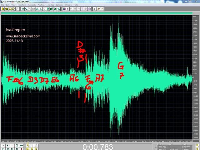

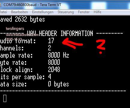

The WAV format is unusual (type 17) and the signal level is abysmal.
I made a first attempt with Cooledit, but only found 8 different tones:
D3, D#3, A6, E6, F#6, A7, D7, G7
That doesn't seem very plausible to me.
My suggestion: You could use a better microphone and ring the bells individually. Or check if they might even be stamped? ;-)
The storage format shouldn't be ADPCM, but PCM, mono, 16 bits/sample.

Michael

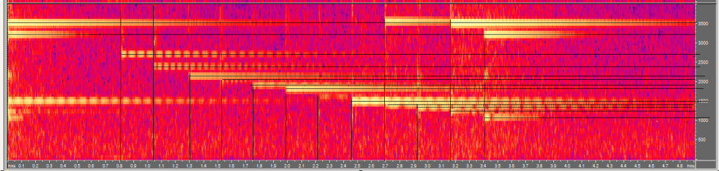

My version of CoolEdit using waterfall display
Frequencies detected (first number is time from start):
0 3500 3200 2130 1500 1210 1060
0.81 2750
1.04 2400
1.3 2130
1.53 2020
1.75 1900
1.99 1800
2.21 1600
2.46 1500
2.69 3500 1400
2.925 1350
3.165 3500 1210
3.41 3200 2130 1060

I agree that the signal level was way too low.
I started by amplifying it by 20dB but there is still the background noise to contend with.
Most of the tones I detected were in the 30-40% high but it is promising to see so many agreeing with each other.
There are also two phantom tones in my list.

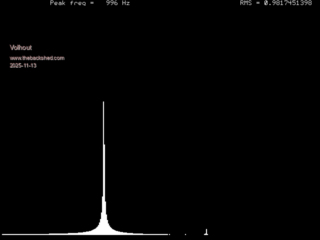

In case you have a picomite VGA, you can analyze the audio yourself.
Connect the audio signal to GP26(*) on the picomite VGA, and run below (very elementary) spectrum analyzer.
 'GP26 audio spectrum analyzer VGA
 'ping-pong ADC and calculate RMS value and fft
 'runs on picomite VGA in mode 1 (640x480 monochrome)
 framebuffer create
 framebuffer write f
 'system parameters
 Option base 1
 n=512                   'samples
 Dim a(n),b(n)           'ping pong buffers
 Dim c(n),d(n)           'processing buffer
 'hardware parameters
 offset = -1.66          'hardware default
 freq = 10000             'ADC sampling frequency
 'test signal generated from PWM
 'SetPin gp0,pwm
 'PWM 0,50,50            '50Hz, 50% d.c.
 'test signal from audio output
 play tone 2000,1000
 'open the ADC and start first conversion
 'SetPin gp26,ain
 ADC OPEN freq,1,INT_RDY
 ready=0:pingpong=1
 ADC START a()
 'main routine
   'every n/freq a new buffer is filled with samples and ready flag raised
   'we have time to process the data. Using math commands we gain time
   'rms is 4ms/512 samples, fft = 44ms/512 samples, plotting the graph consumes most time
   text 0,0,str$(timer,3,0)
   timer=0
   If ready Then
     If pingpong Then
       MATH ADD b(),offset,c()
     Else
       MATH ADD a(),offset,c()
     rms = Math(SD c())                 'math(sd a()) does all the math to
     'calculate rms from an array
     text 480,0,"RMS = "+str$(rms*scale,1,4)
     ready=0
     'fft calculate magnitude
     MATH FFT MAGNITUDE c(),d()
     dummy=math(max d(),p%) 'determin what cell in the array has the highest value
     inc p%,-1              'because option bas 1
     if p%>n/2 then p%=n-p% 'copy frequency mirror bin
     text 200,0,"Peak freq = "+str$(p%*freq/n,5,0)+" Hz"
     scale=(MM.VRES-10)/n
     MATH SCALE d(),scale,d()        'scale to match samples on 470 vertical
     'resolution
     'fft spectrum show
     bars=n/2-1:wdth=Int(MM.HRES/bars)
     For i=2 To bars'n/2 - 1
       BOX i*wdth,470-d(i),wdth,d(i)
     Next i
   framebuffer copy f,n
   CLS
 Loop While Inkey$=""
 Save compressed image "fft_bars.bmp"
End
 'interrupt routine
Sub INT_RDY
 If pingpong Then
   ADC START b()
 Else
   ADC START a()
 pingpong=1-pingpong
 ready=1

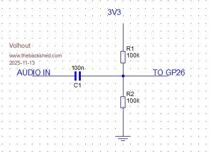

The screen will show the spectrum, the top right corner will show the level you input, try to increase the volume so get close to 1Vrms. Not higher, since you overdrive the input ADC. The sampler works at 10kHz, so you should be able to detect all frequencies up to 5kHz.
This is the input circuit I used.
P.S. the audio analyzer loop time is 70ms, so it most likely is fast enough to detect all notes (200ms between bells).
P.P.S. for the purists: the display routine and FFT are much slower than the ADC sample engine, so there is more data acquired than is shown (roughly 40% more).

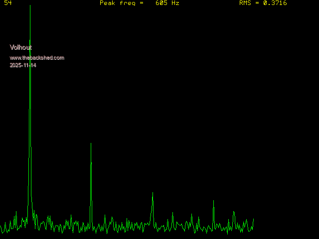

Update to the spectrum analyzer for pico VGA.
GP26_audio_analyzer_VGA_2.zip
twofingers
