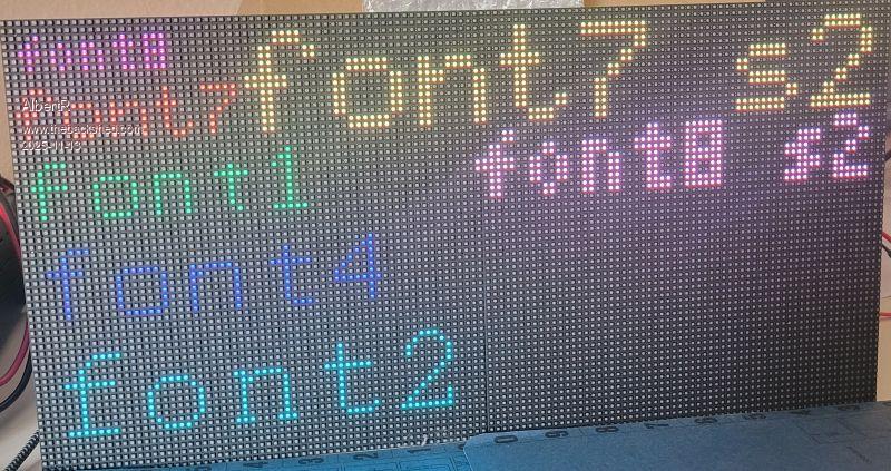

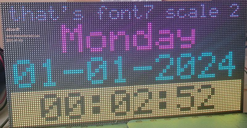

my last Bitmap-Userdriver for the Hub-display has problems with different fonts and "scale". I changed that in this version
Hub75User128x64.zip
I don't know if this is the quickest solution, but maybe someone would like to take a look at it.
If someone want to use my PIO-Program for the Hub75, I have noticed that the output no longer works with version RC11. For testing purposes, only use b14 up to RC10.

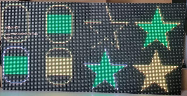

I think I have found an other bug of the Userdisplay-driver in Basic
The picture show the problem, Roundes Boxes work in Outline perfect but fails in filling, with Polygons it is reversed.
Albert

I suspect your drawrectangle routine isn't sorting the coordinates
Sub mm.user_rectangle x1,y1,x2,y2,col
local integer t
If x2<=x1 Then
t=x1
x1=x2
x2=t
If y2<=y1 Then
t=y1
y1=y2
y2=t
The other bug will be fixed in RC15
AlbertR
Joined: 29/05/2025
Posts: 111
Posted: 06:55pm 17 Nov 2025
Hi Peter,
that helped, thanks.
Polygon and RBox work now.
Sorry, my mistake.
Greetings
Albert
