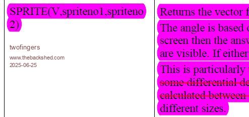

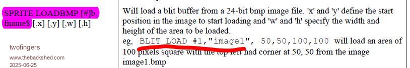

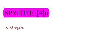

Since this was already overlooked in the last update:
  Quote  p. 149 (Typo)
PLAY LOAD SOUND array%()
You can use the MEMORY PACK command to
create the arrays from a normal 40956 element integer array.
should be: 4096!
An example would be helpful, as it's not clear whether all elements must be filled. It's also unclear how to use a second array or how to overwrite or delete the sound data (not the array!).
and I couldn't get it (PLAY LOAD SOUND) to work with MEMORY PACK, I found some more typos in the description of the sprite commands:
p. 159 (Blit load?)
p. 183 (missing closing bracket)
p. 184 (Duplicate section)
(so1 = s1)

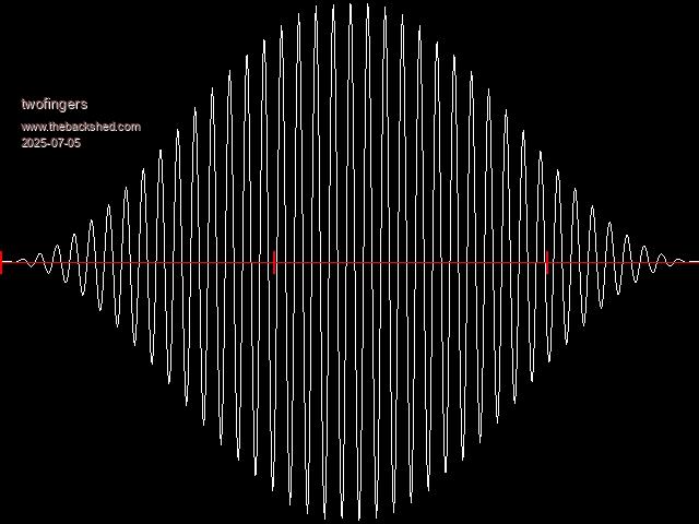

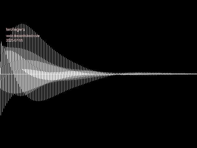

twofingers
Joined: 02/06/2014
Posts: 1782
Posted: 09:24am 05 Jul 2025
Thanks Phil, very useful.
I must have missed last year's post because I was in the hospital. But you also notice that in the second example you use a multiplier instead of a frequency?
By the way, I used for your example "PLAY SOUND 1, "M", U, 1000, 25"
I consider the function even more valuable if it allows me not only to play a single wave cycle, but also sequences of cycles with a decay characteristic or an envelope ...
And there are simpler commands for sine waves.
I mean, it's more useful to play complex waveforms, but I understand and acknowledge that you've only shown simple examples here!
I would also be in favor of removing the 4096 bytes limit; then even longer sound effects would be possible.
80 Hz, 8000 sample rate.
445 hz
Kind regards
Michael
