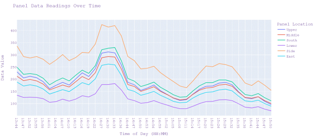

Here is my data for the 2+ hours I had the program working (6 INA226 current monitors calculating current through 12V-24V LED modules being read by an ESP32-C3Supermini):
250628134452  14.9   230 15.4 9.8   212 21.6 10.5   249 23.6 8.8   134 15.2 10.2   336 32.9 9.8   188 19.2
250628134752  14.5   205 14.2 9.7   194 19.9 10.4   220 21.1 8.8   125 14.2 10.1   293 29.1 9.7   172 17.7

It ran with no changes. I copied the output html file to /var/www/html, and it immediately displayed when I entered the URL:
I am very impressed. It no doubt would have taken me many hours to produce this chart using MMBasic DOS or MMB4L or lua or php. All I did was provide a sufficiently complete specification and some data. I like that it was able to pick out the data from my saying use the 3rd, 6th, 9th, 12th, 15th, and 18th words in each line.

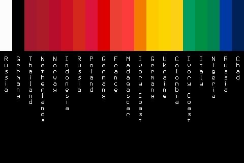

Posted: 01:01pm 05 Jul 2025
AI writes MMBasic code

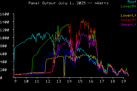

After getting Google Gemini 2.5 Pro to write python code to chart my mini-solar panels current on an ILI9341 over the course of a day, I asked it to do the same for an ILI9488. 3+ hours later and 4 different ili9488.py drivers, it had still not drawn a line or written text to the LCD, and it gave up.
It said that the fourth driver had derived from MMBasic source code (because I had shown that MMBasic could write the ILI9488 screen on the same hardware). (I doubt that it had looked at the MMBasic source, because it later said that it could not look at external sources).
So I asked it to write MMBasic code for the ILI9488, and it said it could. I gave it an 8-line program which illustrated all the graphical elements.
cls
line 48,0,48,272 ' draw vertical axis line
line 48,272,mm.hres,272 ' draw horizontal axis line
Text MM.HRes/2,0,"Panel Output July 4, 2025",c,2,,rgb(yellow) ' print heading
text 60,278,"  9",V,1 ' print first time vertically
text 8,36,"1400",,1 ' print first (highest) milliwatt reading
dim integer  mv(16)=(270,250,200,180,185,150,125,200,110,85,70,180,170,200,240,270,270) ' points to plot
line plot mv(),,50,20,,,rgb(yellow) ' plot the points
Not to laugh but it was 20+ painful versions before it was actually plotting, and Version 26 gave a good plot. Version 33 got some labelling tweaks finalized (279 lines of code):

So it was a painful session, but I learned a lot and had a good outcome. The steps were not too different from my own coding process--use F10 AUTOSAVE to throw code into the PicoMite, then fix syntax errors, then fix logic errors.
Thoughts for future use
I wonder if feeding it one of the recent MMBasic "help" files would enable it to avoid incorrect syntax. It's not hard to conceive that a near-future coding AI could have access to run MMB4L or MMB4W code in a sandbox to fix syntax errors before presenting code to the user.
Conclusion
Anyway, it was an interesting and fun effort. So now I have a somewhat capable and somewhat imbecilic junior programmer assistant for $.70 a day. More than what I had hoped for when I started this tread, but also in some ways less. Everything is happening fast.
' MMBasic Solar Panel Plotter (Version 33)

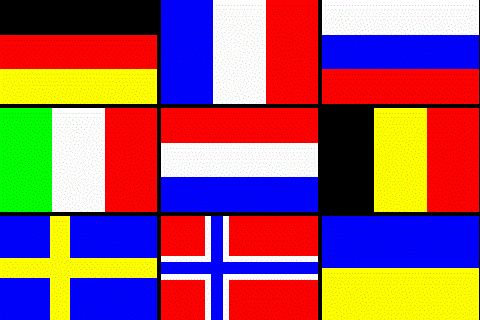

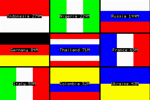

With a Pico 2 flashed with MMBasic, I issued "LIST commands" and scraped the TeraTerm screen and saved "commands.txt" and then "LIST functions" and saved that as "functions.txt". I downloaded electricat's help.txt file from here: https://www.thebackshed.com/forum/ViewTopic.php?TID=17777&PID=237581#237581#237581
I had to edit lightly. I removed the OPTION entries, and because AUTOSAVE choked on /hex, I edited or deleted the entries which had that (and something else involving "/").
I uploaded those three files to Gemini and told it to use only the commands and functions in those files, and to look into help.txt to find clues for syntax (and said that for many commands it might need further help with syntax and meaning of parameters). It said it understood and would use the proper commands and functions.
I then fed it this specification:
The flags of Germany, France, Russia, Italy, The Netherlands, Belgium, Sweden, Norway, and Ukraine can all be drawn using the line command (with width specified) and the defined colors. For fun, please produce an MMBasic program filling the ILI9488 screen with those 9 flags with 3 rows of 3 flags and 4 pixels between each flag and each row.
Three versions later (less than 15 minutes), after one syntax error and one misalignment of the flags, this is what it produced:
Pretty impressive, I think. It actually used the BOX command, not the LINE command (it said its misunderstanding of the LINE command with LW parameter had caused the misalignment of Version 2). I did not tell it what colors to use for the flags--it figured that out on its own.
Here's the code (120 lines):

Posted: 12:10pm 07 Jul 2025
I decided to ask Gemini to do a little independent research as part of its next effort. I gave it this task.
Can you read the list of countries by population here: https://en.wikipedia.org/wiki/List_of_countries_and_dependencies_by_population and determine which 9 with the highest population have flags which can be drawn with the BOX command (no angled or curved lines)?
So here it had to look at a Wikipedia page listing nations by population, look up their flags, and determine whether the flags could be drawn with just the BOX command. It gave me a list of the top 9.
I then gave the specification:
Great. Please produce an MMBasic program to draw those maps in the 3x3 configuration, and print in the middle of each map the name of the country and the population. If the text might go through a white area, use black as the color (rgb(black)), if through a black area, use white. Use the BOX command. With the TEXT command, an "alignment" parameter of C will center the top of the text at the x,y point.
It produced the 9 flags.
Great flags, but you did not include the name of the country and its population centered in each flag.
Two glitches later including a mistake on my part (black text on black background), it produced this:
Exactly right. Now go back to the wikipedia page and pick out the 16 countries with the highest population and a flag which can be drawn with the box command, and produce an MMBasic program to draw those on the ILI9488 with 4 rows of 4 flags.
So this is, at the least, something approaching independent (if guided) research. Gemini is somewhat prone to flattery: I was told that I was expert and patient.

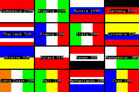

Posted: 12:17am 08 Jul 2025

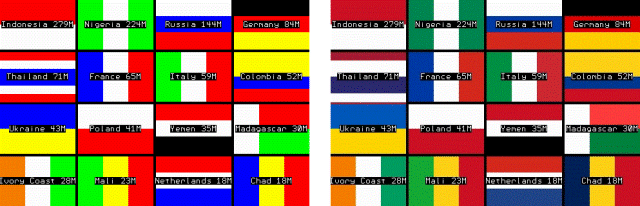

Today's task for Gemini was to get more realistic colors for the 16 flags. I had originally told it to use the named colors: rgb(red), rgb(green), etc. I asked if it could search out flag images on the web and determine the right colors. It said it could, so I set the specification:
Please use your understanding of RGB to get a closer match to the actual color as you find flag examples online in the RGB format (e.g., RGB(130,148,5) for dark yellow). Produce a program for that in the 4x4 format last used. So each flag may have a different version of what we might generally call "green".
I thought that if it could find appropriate RGB settings, which it quickly did, this would be result in a quick solution. Unfortunately, for reasons which were mostly silly, it took until Version 13. Among the inexplicable regressions were returning to 9 flags in the 3x3 format, omitting the text, and most contradictory to the specification, returning to the named colors after it had successfully drawn using better colors.
But here's the final result--first with the named colors on the left, then with more accurate colors:
The reds, greens, yellows, and blues are notably darker. You can see the difference between adjacent blues with Thailand and France and Netherlands and Chad, and greens between Ivory Coast and Mali.
Although it was frustrating for it to take so many iterations when it had immediately solved the color problem, the process is pretty straightforward. Usually within a minute of my presenting an error (or a specification), it has new code, which I copy and paste into TeraTerm after F10 AUTOSAVE. Ctrl-Z, run, and there's a new result.
The program--now Version 17 (219 lines) because I noticed a problem with the rendering of the Thai flag (the only one with more than 3 boxes to be drawn).

FlagNumber = 1
FOR Row = 0 TO 3
   FOR Col = 0 TO 3
       x = Col * (FlagW + Gap)
       y = Row * (FlagH + Gap)
       idx = FlagNumber - 1
       SELECT CASE FlagNumber
           CASE 1: DrawIndonesia x, y
           CASE 2: DrawNigeria x, y
           CASE 3: DrawRussia x, y
           CASE 4: DrawGermany x, y
           CASE 5: DrawThailand x, y
           CASE 6: DrawFrance x, y
           CASE 7: DrawItaly x, y
           CASE 8: DrawColombia x, y
           CASE 9: DrawUkraine x, y
           CASE 10: DrawPoland x, y
           CASE 11: DrawYemen x, y
           CASE 12: DrawMadagascar x, y
           CASE 13: DrawIvoryCoast x, y
           CASE 14: DrawMali x, y
           CASE 15: DrawNetherlands x, y
           CASE 16: DrawChad x, y
       END SELECT
       DrawLabel x, y, Names$(idx), Pops$(idx)
       FlagNumber = FlagNumber + 1
   NEXT Col
NEXT Row
END
' SUBROUTINES
SUB DrawLabel(x, y, Name$, Pop$)
   LOCAL INTEGER CenterX, CenterY, LabelTextLen
   LOCAL STRING LabelText$
   CenterX = x + FlagW \ 2
   CenterY = y + FlagH \ 2
   LabelText$ = Name$ + " " + Pop$
   LabelTextLen = LEN(LabelText$)
   TEXT CenterX - (LabelTextLen * MM.FontWidth / 2) , CenterY - (MM.FontHeight \ 2), LabelText$, , , , White, Black
END SUB

A new task, as a lark, illustrating some independent investigation. This MMBasic program will be Version 1. Specification: determine how many unique colors there are on the 16 flags; sort them by wavelength into a rainbow arrangement; display a box for each color starting at y=0, depth 100 pixels, width=mm.hres/number-of-colors; below each color box print the country name with an "alignment" in the TEXT command of CT, which is to be centered below the box and printed vertically; avoid syntax errors by confirming that any variables used have been declared and that command or functions used are in the commands and functions text files provided earlier, or are supplied by you, and syntax conforms to the "help" file provided earlier.
I thought that if Gemini could sort the rgb colors in the flags in rainbow order, as it quickly showed it could with access to some API which gave it hue, this might be a one-and-done task.
Unfortunately, it was Version 10 before it got this:
Errors included undeclared variable (despite the fact that I have told it multiple times to always check before providing code that all variables are in DIM or LOCAL statements), giving country names of "Cyan" and "Magenta", regressing entirely to a version of the flags program, inventing a new parameter for the TEXT command (compounded by my initially saying the "alignment" parameter should be CT instead of CTV), and not sorting in rainbow order (with white and black first).
I eventually had to feed it the colors it had used in the flag program:
CONST IndoRed = RGB(206, 17, 38)
CONST NgrGreen = RGB(0, 135, 81)
CONST RusBlue = RGB(0, 57, 166)
CONST RusRed = RGB(213, 43, 30)
CONST GerRed = RGB(221, 0, 0)
CONST GerYellow = RGB(255, 206, 0)
CONST ThaiRed = RGB(165, 25, 49)
CONST ThaiBlue = RGB(45, 42, 114)
CONST ItaGreen = RGB(0, 146, 70)
CONST ItaRed = RGB(206, 43, 55)
CONST ColYellow = RGB(252, 209, 22)
CONST ColBlue = RGB(0, 56, 147)
CONST ColRed = RGB(206, 17, 38)
CONST UkrBlue = RGB(0, 91, 187)
CONST UkrYellow = RGB(255, 213, 0)
CONST PolRed = RGB(220, 20, 60)
CONST YemRed = RGB(206, 17, 38)
CONST MadRed = RGB(252, 63, 62)
CONST MadGreen = RGB(0, 129, 60)
CONST IvcOrange = RGB(247, 127, 0)
CONST IvcGreen = RGB(0, 158, 96)
CONST MaliGreen = RGB(20, 170, 52)
CONST MaliYellow = RGB(252, 209, 22)
CONST MaliRed = RGB(206, 17, 38)
CONST NldBlue = RGB(33, 70, 139)
CONST ChadBlue = RGB(0, 32, 91)
CONST ChadYellow = RGB(252, 209, 22)
CONST ChadRed = RGB(206, 17, 38)
The process was more frustrating than it should have been, but still pretty quick. I think its finding and sorting on the hue value was creditable--indicative of an ability to search for external means to solve a problem.
Here's the final code (63 lines):

I notice that although I gave it 28 rgb colors (that it had generated for the flags program), it only displayed 20. It is possible that its hue routine returned the same value for some. I didn't think to ask it if that was what happened.

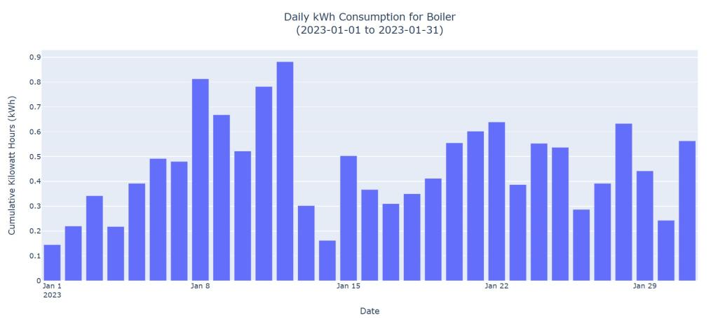

A different path. I have log files which record various sensor readings--mostly temperatures but also current usage for my boiler, freezer, and wellpump. A data record looks like this:
J 3 4 -1 240101071140.
A single first capital letter indicates the sensor/recordtype. In this case, "J" means readings from my barn. The 2nd word is temperature in °C in the barn at floor level, the 3rd is at waist level, and the 4th is outside. The 5th word is a timestamp in the format of "YYMMDDhhmmss". For the boiler, the letter key is "L" and a record looks like this: L 0 25 0.317 241026084155. The second word indicates appliance turned on or off ("1" or "0"); the third is number of milliwatt hours used since turned on, and the 4th is cumulative kilowatt hours for the day. The 5th is always timestamp.
I gave Gemini this prompt: Please produce a python program which will read an input file, "signals23.txt", and produce an html vertical bar chart file of watts consumed per day for one of three appliances. "L" as the first word of an input line stands for "Boiler", "T" stands for "Freezer", and "K" stands for "Well Pump". each record had 5 words separated by a space. A second word of "1" means the appliance turned on. A second word of "0" means it turned off. With a 2nd word of "0", the 3rd word will be the number watt hours used. The 4th word will be the cumulative kilowatt hours for the day, and the 5th word will be a timestamp in the form "YYMMDDhhmmss". When the program is run, query the user for the appliance ("L","T","K") and the starting and ending time periods in "YYMMDD" format. If the ending time period is blank, the period plotted with be the single day and each cycle end time will be plotted. If the ending time period is subsequent to the starting (e.g., a multi-day period), each point in the plot will be the 4th word of the final cycle end time for each day. Provide appropriate horizontal and vertical labels. The records will be like this
L 0 2 0.311 220114100313.

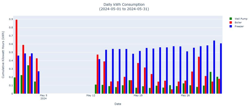

The first pass failed with "utf-8' codec" error. The second pass ignored records with those and produced a plot which included a negative value. I told it to ignore any negative readings of milliwatt hours. The next pass ran successfully and produced this chart of boiler usage for the month of January, 2023:
And then this for the day with most electricity used, Jan 12, 2023:
Some cycles of refinement later with only two errors (variable typo and misunderstanding of actual record type codes when I asked it to allow user input of B, F, W for Boiler, Freezer, Wellpump), I got this:
(Unfortunately my data accumulator had failed for May 5 - May 12.)
This was very easy development--few errors, all but two understandable, and a steady progression as I refined and expanded what I wanted the program to do. This particular kind of coding by AI seems essentially complete.
202 lines of python code (which I haven't even looked at).
