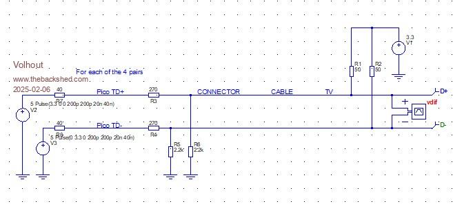

To meet the spec of the previously mentioned chip, the simulation says that following circuit could be used. Again, this is simulation, and it does not have pre-emphasis needed for longer cables.
In essence it is adding a 2.2k resistor to ground from each of the connector pins (except the 5V).
I really wished I had one of these monitors. Measuring what goes wrong is so much easier than working in the blind.

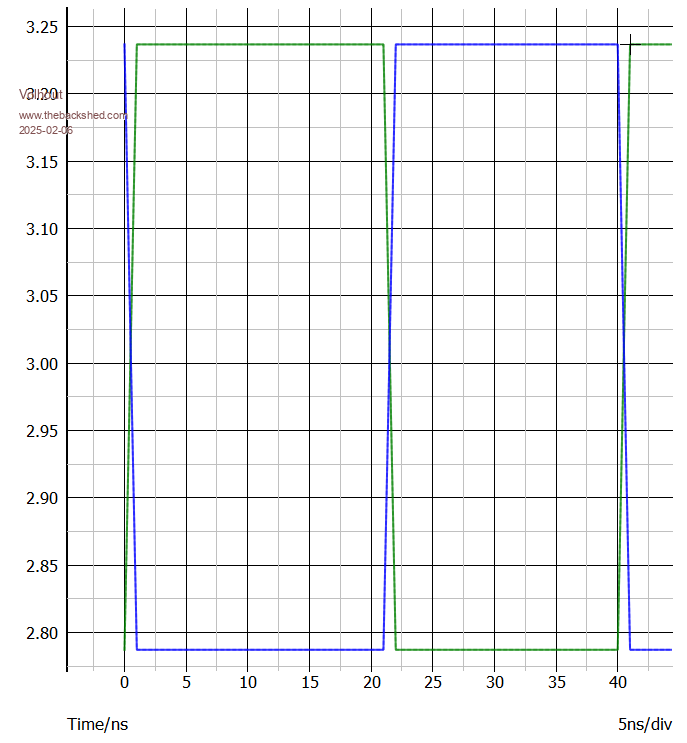

Waveform 25MHz (640x480) simulated without any cable distortion.

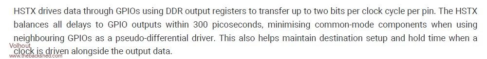

For the higher resolutions the clock rate increases. But the chip uses the normal GPIO pins driven by the HSTX. So you cannot get extremely high clock rates, the GPIO pins do not allow that. It could be that 1280 (around 100MHz ?) is about the max the pins can do. There will definitely be a degradation in levels at 100MHz.
P.S. There is also the timing issue: HSTX has 300ps (pico seconds) alignment margin on the GPIO's.
Where as commercial HDMI chips are more timing accurate: 3 ps max.
This may, or may not be important, but just noted there is a difference.

The frequency at 640x480 is 157.5
Mhz not 25Mhz. DVI is a parallel serial protocol 5 clocks per byte with data clocked on both edges - 4 channels R, G, B + clock. At 1280x720 the frequency is 382Mhz. This is why trace matching is important.

  Volhout said  Waveform 25MHz (640x480) simulated without any cable distortion.
As Peter says it's 157.5MHz what would it be like then?
