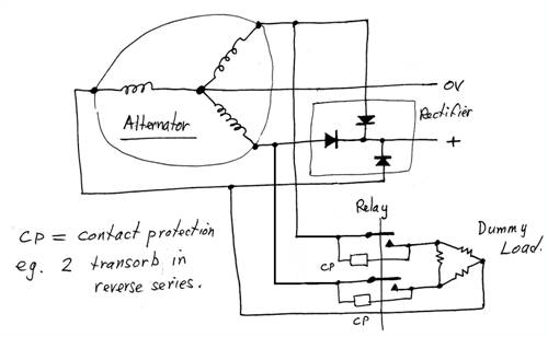

You said above, that my suggestion re inserting a diode is undesirable as it would drop the voltage.
Here are 2 suggestions:-
2. Have you considered using a Schottky diode? As you know, they have a lower voltage drop than silicon ones. If necessary, you could connect several (Schottky's) in parallel to reduce the voltage drop.
2. The alternator has a 3 phase rectifier. So if the anodes of these diode are accessable, then you could connect the load resistors as shown in the drawing & thus a diode would not be necessary & thus there would be no additional voltage drop & the battery would not be discharging into the dummy load.
Moreover, the resistors will dissipate less power & thus can be of a lower power rating than otherwise.
Len
Edited by larny 2011-11-12

you dont appear to have one of the phases loaded is it that the other phase is not nesscary...

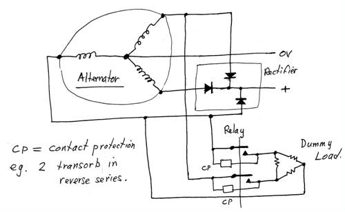

  sparkey said   you dont appear to have one of the phases loaded is it that the other phase is not nesscary...
Yes, sorry, you're right. Drawing error.
I'll fix it & replace.
Edit.
I could not edit my previous post, so here is the modified drawing.
Len

dont missunderstand me here but has glenn stated which type of generator he is using ...star/delta... i guess a star always has a neuteral well then mine must be a delta because it only has three wires comming from it i did not make it myself it is a bought unit ....500 watts
technicians do it with least resistance
larny
Joined: 31/10/2011
Posts: 349
Posted: 08:20pm 11 Nov 2011
Sparkey,
No Glenn did not tell me whether he has a star or mesh alternator.
I drew a star configuration as a guess.
However, it makes no difference to my circuit.
The resistors are connected between the alternator & the diodes.
LenEdited by larny 2011-11-13

also a delta has a different wireing configureation and would require a different diode bridge...but the relay load should be the same....
larny
Joined: 31/10/2011
Posts: 349
Posted: 01:04am 12 Nov 2011
  sparkey said   also a delta has a different wireing configureation and would require a different diode bridge...but the relay I think you mean resistorload should be the same....
Yes, it has 6 diodes rather than 3, but there is no difference as far as we are concerned.
The main question is whether you can access the coil terminals.
The secondary question is whether making this mod will affect your warranty.
I can't answer these questions, so I'll leave it to you & Glenn.
