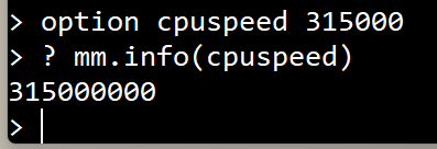

Posts: 6198
Posted: 11:42am 28 Aug 2024
It was to be expected.
In Pico2 the QSPI bus is between RP2350 and flash chip.
In Pico2-plus the QSPI bus is going from RP2350 to 2 devices 1/flash and 2/PSRAM.
The extra load (PSRAM) may limit the speed at which the bus can be used. Even if the PSRAM is not used, it loads the bus.
I hope it also works at 315MHz, since that is the CPU clock needed for HDMI.
If not, HDMI is not possible at the Pico2-PLus.
That would be a problem.
Edited 2024-08-28 21:42 by Volhout
