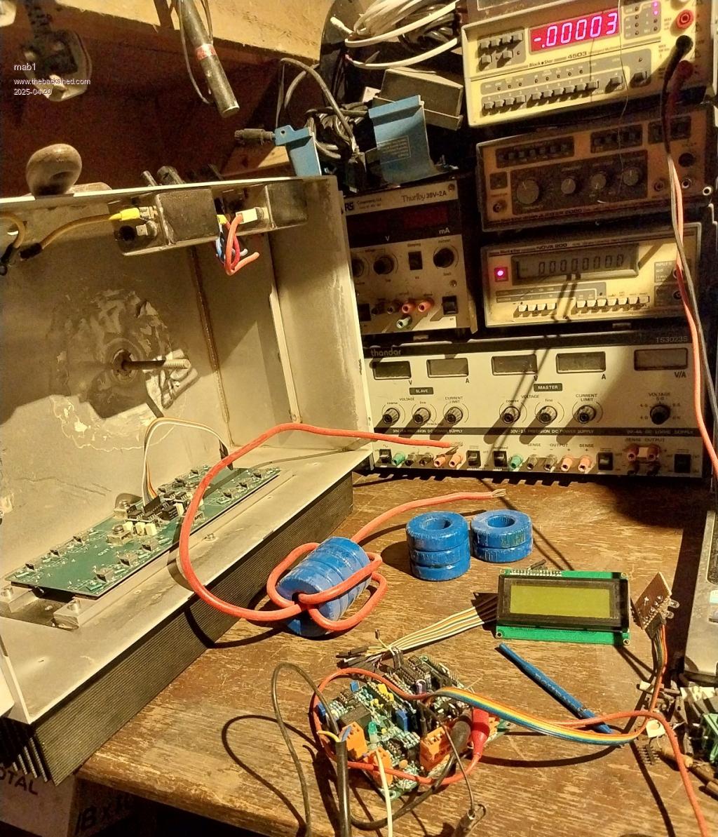

OK, I keep doing bits on my build on other folk's threads - perhaps it's time to resurrect my own

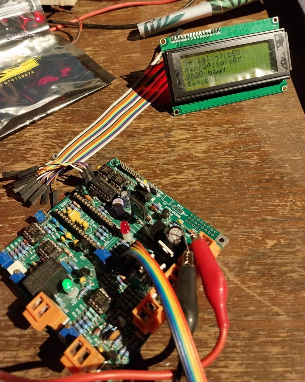

I've completed assembly of WG39, made a board for the front panel leds and reset button, and assembled WG30 power board onto a heatsink in an aerosharp box (there's no room for the Transformer in there, but i'm hoping i can squeeze in the other bits).
I've started working through Wiseguy's testing manual - so far so good:

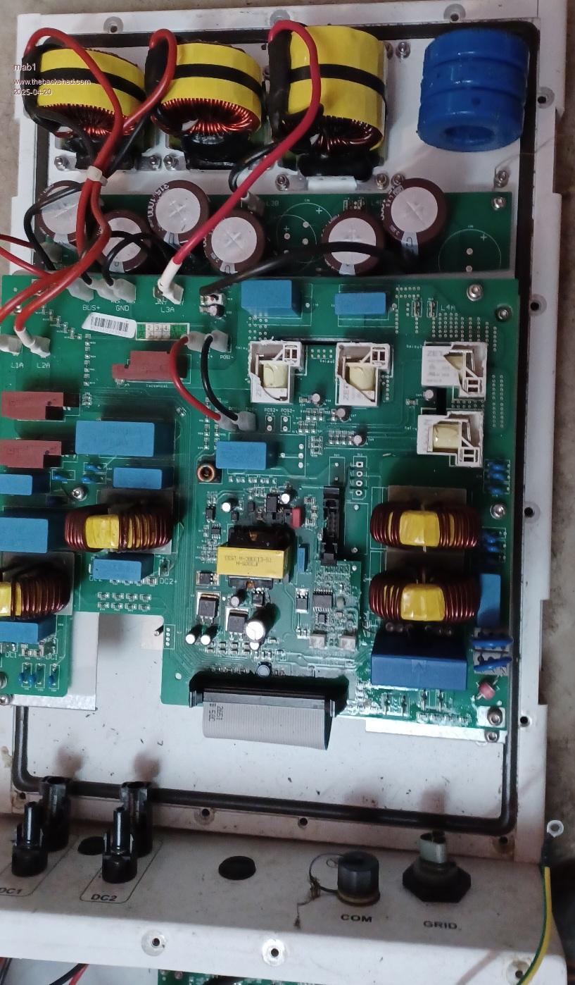

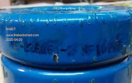

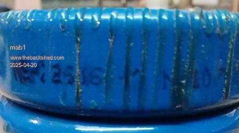

I've managed to salvage Ten sendust(?) rings from a Solis GTI. 58mm od, 26mm id and 16m tall. sadly the writing on them had run when they were varnished, so i can't read much.
four turns on five rings gives me about 20uH; 5 turns about 25uH. My inductor test setup won't go much over 200A so i tried winding lots of turns of small wire to find the upward curve of saturation, then multiplied amps x turns to give me 2150 amp-turns for the start of saturation. if i'm not over simplifying, that should mean they're good for about 500A with 4 turns, or 400A with 5 turns.
I'm still working on winding the transformer - i chose NOT to follow keepis's advice to stack the two cores without fully unwinding them   . luckily i did reserve the right to regret my decision to fully unwind and re-wind

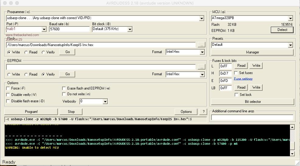

I still seem to be stuck on getting the hex code into the nano
I think i may need the assistance of someone more computer savvy than me - shouldn't be hard to find someone meeting that description
I tried Avrdudess in win xp, but it gave me an error: not a valid win32 application - so i'm guessing it won't work on an old 32bit OS?
Following Revlacs  Github link, it loooks possible to get the portable version to run on an older mac using "mono" which seems to be an open source .net framework thingy. As i'm not sure what .net framework actually is, i did a bit of reading, and it seems to allow 'cross platform' (i.e. OS) use of applications.
so i installed mono and tried to run avrdudess in it - it does work if you select the arch=32 option.
I couldn't get anything to appear in the 'Port' select window (com1 /usb/ etc), so waited until the USBasp arrived (today): still nothing showing in the Port, but it does show up under the USB hardware (apparently you don't need to install drivers on a mac):
Thought about running Arduino and seeing if it shows up there, but whilst i can set the programmer as USBasp, i cant see it under 'port', so comms' port cannot be selected; but some googling suggests this is a common issue with usbasp on mac, and if you select "sketch/upload using programmer", it will program using the usbasp.
So tried the basic "blink" prog: it didn't work, but arduino does seem to be seeing the usbasp, but fails to program because it thinks the nano is a 328pb, not the 328p it was expecting.
OK, i think, maybe avrdude will work with usbasp even if comms port is unselected too, but no, it doesn't appear to (if you check the above pic of avrdude, pressing 'program' results in the 1st long blue message and that's it (tried 57600 and 115200). The 2nd blue line is from pressing 'Detect' button under MCU (both baud rates tried).
edit: the details under fuses&lock bits i typed in manually, along with baud rate, to match keepis's settings.
I've run out of idea's, but then i don't know what i'm doing, i'm just muddling along
help, please!

I need to see everything in the AvrDudess output window. Sometimes the errors are not  a true reflection of the cause.
FYI There is a Force(-F) tick box in AvrDudess. And you can select Atmega328PB in the MCU(-p) drop down, that is unlikely to make any difference as that may not be the real error.
Port(-P) drop-down box should show a USB option if it's really seeing the device, Not an USB port number, just USB.
For a test, open AvrDudess and press Detect (top RH side) this will likely give an error but with less unneeded information in the lower output window.
Then right-click in the output window, from the pop up menu, click "Select all", right click again and select "Copy", then paste that into the Forum reply box.
I get this error with NO programmer plugged in !

At the bottom of the screen in AVRDUDESS      It says Unable to detect MCU?
Wonder if you need the CH340 Driver so it will show up on a port?

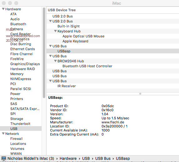

The programmer does not normally show as USB port in Device manager (win11) but rather as a USBasp device under Universal Bus services, much as it's shown in the iMac OS he's using
Edit actually I miss read your post    Yes it's possible that it can't find the USB interface port on the Nano, so indeed it may need the that Driver for the Nano USB.

The Port -P box doesn't show any options at all - that i guess is my problem.

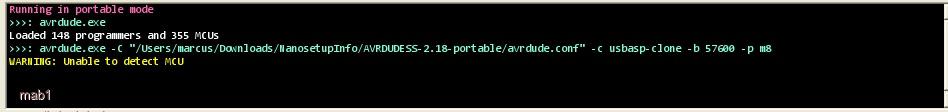

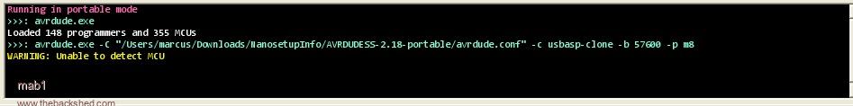

OK, restarting Avrdudess, and pressing detect (with the usbasp and nano plugged in) gives:-
without the programmer:-
(sorry - the copy text from window doesn't seem to work)
so it's not seeing the usbasp

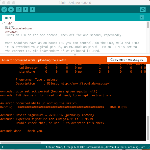

The arduino error window code:-
Arduino: 1.8.19 (Mac OS X), Board: "Arduino Nano, ATmega328P (Old Bootloader)"
Sketch uses 924 bytes (3%) of program storage space. Maximum is 30720 bytes.
Global variables use 9 bytes (0%) of dynamic memory, leaving 2039 bytes for local variables. Maximum is 2048 bytes.
/Users/marcus/Downloads/Arduino.app/Contents/Java/hardware/tools/avr/bin/avrdude -C/Users/marcus/Downloads/Arduino.app/Contents/Java/hardware/tools/avr/etc/avrdude.conf -v -patmega328p -cusbasp -Pusb -Uflash:w:/var/folders/2s/n4lnvcqs55g0zlsbjg2tlsl80000gp/T/arduino_build_174515/Blink.ino.hex:i
avrdude: Version 6.3-20190619
        Copyright (c) 2000-2005 Brian Dean, http://www.bdmicro.com/
        Copyright (c) 2007-2014 Joerg Wunsch
        System wide configuration file is "/Users/marcus/Downloads/Arduino.app/Contents/Java/hardware/tools/avr/etc/avrdude.conf"
        User configuration file is "/Users/marcus/.avrduderc"
        User configuration file does not exist or is not a regular file, skipping
        Using Port                    : usb
        Using Programmer              : usbasp
        AVR Part                      : ATmega328P
        Chip Erase delay              : 9000 us
        PAGEL                         : PD7
        BS2                           : PC2
        RESET disposition             : dedicated
        RETRY pulse                   : SCK
        serial program mode           : yes
        parallel program mode         : yes
        Timeout                       : 200
        StabDelay                     : 100
        CmdexeDelay                   : 25
        SyncLoops                     : 32
        ByteDelay                     : 0
        PollIndex                     : 3
        PollValue                     : 0x53
        Memory Detail                 :
                                 Block Poll               Page                       Polled
          Memory Type Mode Delay Size  Indx Paged  Size   Size #Pages MinW  MaxW   ReadBack
          eeprom        65    20     4    0 no       1024    4      0  3600  3600 0xff 0xff
          flash         65     6   128    0 yes     32768  128    256  4500  4500 0xff 0xff
          lfuse          0     0     0    0 no          1    0      0  4500  4500 0x00 0x00
          hfuse          0     0     0    0 no          1    0      0  4500  4500 0x00 0x00
          efuse          0     0     0    0 no          1    0      0  4500  4500 0x00 0x00
          lock           0     0     0    0 no          1    0      0  4500  4500 0x00 0x00
          calibration    0     0     0    0 no          1    0      0     0     0 0x00 0x00
          signature      0     0     0    0 no          3    0      0     0     0 0x00 0x00
        Programmer Type : usbasp
        Description     : USBasp, http://www.fischl.de/usbasp/
avrdude: auto set sck period (because given equals null)
avrdude: AVR device initialized and ready to accept instructions
An error occurred while uploading the sketch
Reading | ################################################## | 100% 0.01s
avrdude: Device signature = 0x1e9516 (probably m328pb)
avrdude: Expected signature for ATmega328P is 1E 95 0F
        Double check chip, or use -F to override this check.
avrdude done.  Thank you.
This report would have more information with
"Show verbose output during compilation"
option enabled in File -> Preferences.
Edited 2025-04-25 10:10 by mab1

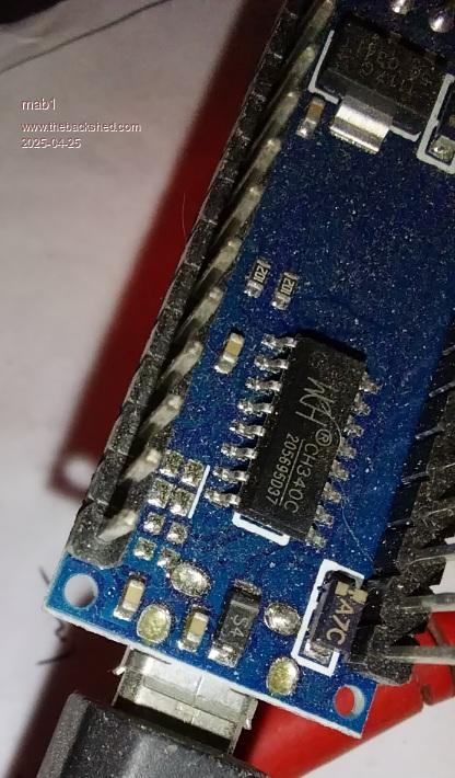

I think i must have the ch340 driver for the regular arduino? otherwise it wouldn't work with the clone nanos.
I can certainly program the nano by plugging into it's usb port   , but the port (-p) is still blank in avrdudess
Edited 2025-04-25 10:22 by mab1

There are two types of Nano USB controllers.
FT232RL USB controller 28 pins.
CH340 16 pins.

Yes - I seem to recall I had to get the ch340 driver, but it was a while ago.
But I've just programmed it with 'blink' and it's blinking
And it's a ch340c

Have you selected in Tools ->  Programmer- USbasp ?
The IDE should then program without an error, it it does not, there might be an incompatibility with the USbasp iMac driver?

Posted: 12:42am 25 Apr 2025
When i tried using the usbasp (posted error with the [code] 'error'   ) i selected tools/programmer/usbasp, and arduino
tools/board/arduino nano
tools/processor/atmega328p (old bootloader)  // the only other options are atmega328p and atmega168, so i couldn't select 328pb to make it happy.
Edit:
err.. i'm currently using terminal like a command prompt, where i'm running avrdudess.exe in mono... i'm not seeing a way to use it to talk to a 'comms port'...
Edit II:
with both the usbasp and the nano connected to the usb ports (asp has no nano connected, i can select what seems to be the usbasp 'port' in arduino IDE (described as "/dev/cu.bluetooth-incoming-port", as opposed to the nano's ch340 "/dev/cu.wchusbserialfd110"). and i can then open the IDE serial monitor, which is a terminal of sorts...
but I need to get off to bed TBH, got to work tomorrow :( ,so may try talking via the asp tomorrow evening.
Thanks very much for everyones help - frustrating, but i have a feeling it's not far off working - but somethings still not right yet
Edited 2025-04-25 11:08 by mab1
