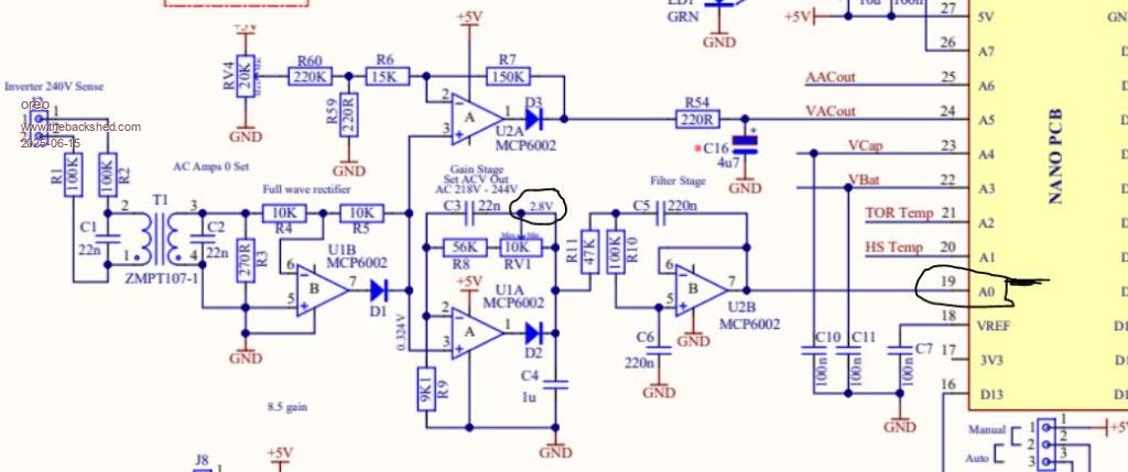

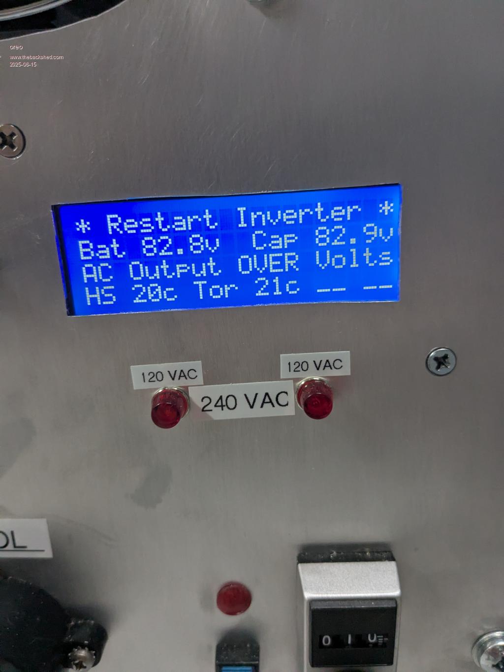

So the Wiseguy inverter has been running reliably for about 7 weeks, and I have been slowly dialing in the 60Hz frequency.  I have the software at 60+ and external clocks that use the line frequency are losing ~17 seconds per day.  This is pretty good, but I would like to improve it if possible.  FYI, I measured the frequency of the 3 Nano processors I have and they vary significantly (from 15.860-15.947mHz).
Anyway, yesterday I noticed the inverter was not running and was displaying this message.
I shut  off and restarted the inverter, and it started and settled back to 240vac.  I left it and when I returned an hour later, it had tripped again.  Further attempts to restart the inverter resulted in it immediately tripping with AC output overvoltage.
So I monitored the voltage on pin A0 of the Nano.
With a separate 120v source plugged into J2, I measure 1.4 volts on A0 and the display reads 120VAC.  This is what it should be I think.
When I reconnect J2 back to the output of the inverter and turn it on, the voltage on A0 ramps up to 3.0v.  I tried increasing the over voltage trip to 280v, and it still tripped.  The display briefly displayed 290vac during the attempted power up.
Since the voltage being fed into the Nano on pins A0 and A5 looks to be correct, I figured there must be a problem with the Nano itself.  I swapped it out with another, and after getting the new Nano set up, it does the exact same thing.
The 5v power supply measures 5.03v and the 12v supply looks good too.
The output of the inverter when in test mode is a perfect looking sine wave.
Any suggestions on what to check next?

wiseguy
Joined: 21/06/2018
Posted: 02:12pm 15 Jun 2025
Hi Greg,
I have essentially zero experience with the KeepIS software so my comments are only general in nature.
From memory I think the control feedback voltage on A0 should be ~ 2.8VDC when the inverter is in regulation, you mentioned it goes to 3V? When checking the A0 voltage only measure it on the Nano module itself, in case the Nano module pin/socket to the controller PCB is not mating properly.
I note that at 120V you measured 1.4V so at 240 it should be 2.8V, which is where it should regulate, increasing A0 past 2.8 should reduce the PWM to minimum. The fact the output regulated to 240V ok after a restart before tripping again later sounds like an intermittent fault so check all AC voltage feedback connections, J2 plug integrity etc.  It could even be a poor soldered joint on the controller PCB along the J2 to A0 chain.
If you have made any tweaks to the software, can you revert back to the original software from KeepIS to see if that cures it, but it sounds more hardware than software!
I assume the overvoltage monitor and shutdown is derived from a setpoint on A5?
Everything happens for a reason - keep hunting, the cause will eventually be revealed.
Good luck!
Edited 2025-06-16 01:56 by wiseguy

Posted: 07:05pm 15 Jun 2025
Thanks for the quick response Mike.
Funny how the brain works (or doesn't) at times.
With 120v on J2 I was measuring ~.17v at the input of U1A pin 3, while at the output (after the diode) I thought I was measuring 1.4v but I was actually measuring .14v.  So in my head I was thinking the circuit around U1A was working properly, when it wasn't.
First off, I measured the components and everything seemed to be ok.  I then swapped in a new U1 (MCP6002) and the circuit started working.  I re-soldered the pins on the socket, swapped the old part back in and it stopped working.  Seems strange to me, but it appears that the IC has failed.
Anyway, things are now back in operation.
thanks again
Greg
KeepIS
Joined: 13/10/2014
Posts: 2284
Posted: 12:09am 16 Jun 2025
Been fighting the seasonal bugs the last few days and just saw your post.
Great to see you solved it with input from wiseguy
Just for future reference for anyone else hunting a problem like this, if you were getting an over voltage only at reset or power up then you must use a DSO connected to the over voltage ADC pin, the DSO may need to be triggered to capture the single spike causing this from a circuit fault, otherwise you won't see it.
In your case you found a hard IC fault, hopefully only bad luck.

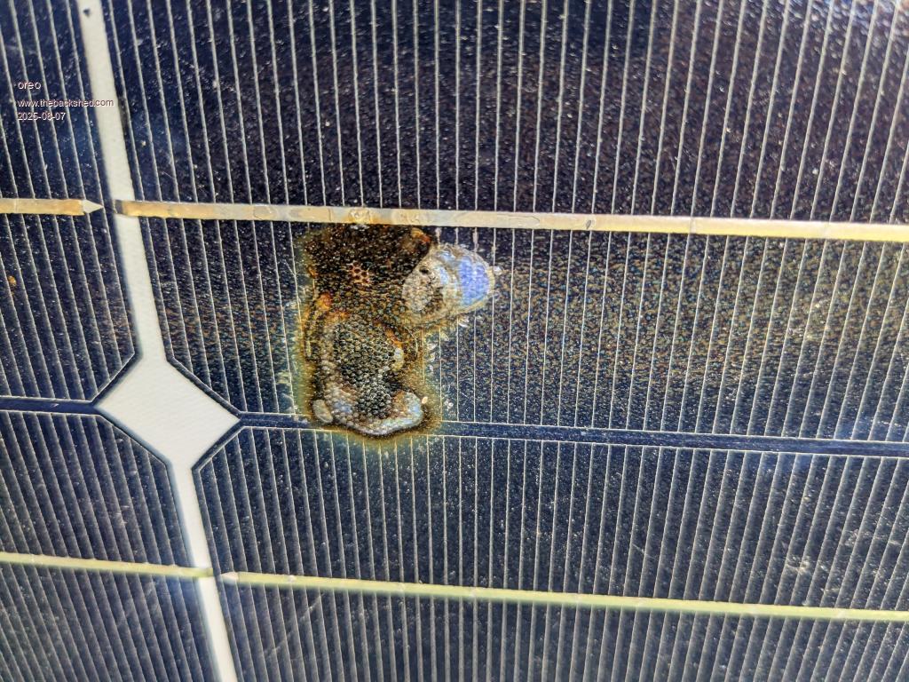

So I finally got around to installing the last 3pcs of the 535w panels I purchased in February last year.
For the last year or so, I have been using 3pcs of 535w and 3pcs of old 250w units.
Anyway, when I removed the 3 older panels I noticed a burn mark on one of them.

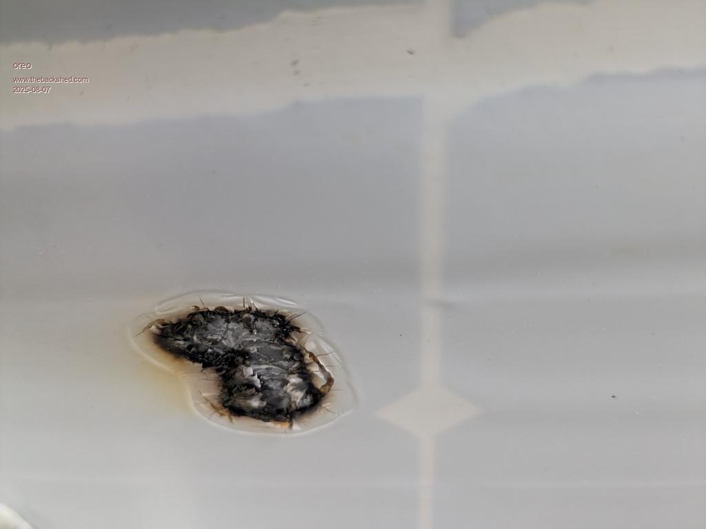

Looking from the bottom
It seems like an odd location for a burn, as I would have thought that it would center on a bad metallic track.
This burn looks to be centered in the solar cell array itself.
Is this type of thing common?
