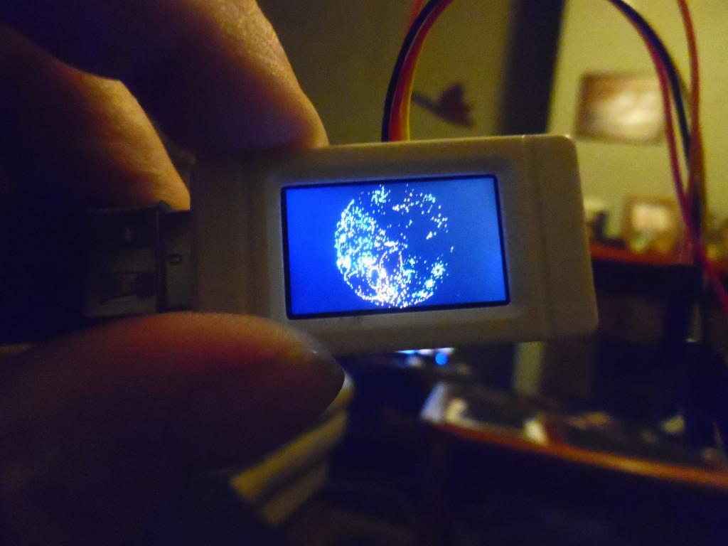

Posted: 07:12pm 05 Apr 2024
  matherp said  Does the display still work? Not sure why I set RLANDSCAPE is it what's wanted?
display is fine using bubble universe as test prog and option list shows option autorun on , as the prog is
and option cpuspeed 420000 seems to be stable with bubble universe which seems a bit faster.??
Thank you for supporting so many picos sir.

Posted: 07:45pm 05 Apr 2024
I never got these. I got another pico with a display attached  but these are weird
 still working at cpu 420000
