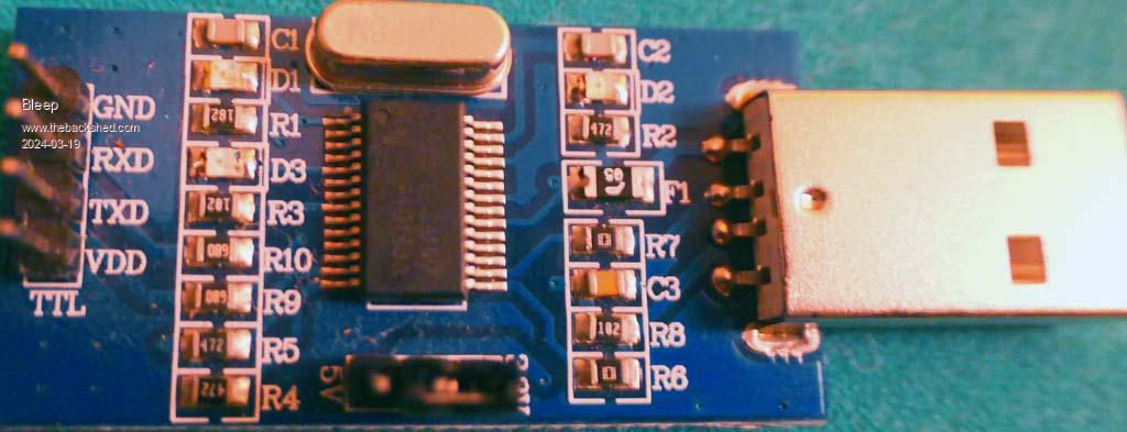

I'm now stuck, I've got the latest Pico USB working with a LCD Console, using the USB serial connection to a terminal, that is working fine, however when I disconnect the terminal and repace it with a keyboard nothing happens, I'm expecting to see a message about a USB device being connected, the keyboard is being powered.
This is the TTL-USB board I'm using, the chip is a LF10193A.

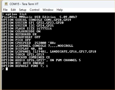

My options are.
PicoMite MMBasic USB Edition  5.09.00b7
OPTION COLOURCODE ON
OPTION KEYBOARD UK
OPTION PICO OFF
OPTION CPUSPEED  252000 'KHz
OPTION LCDPANEL ILI9481, LANDSCAPE,GP15,GP14,GP13
OPTION TOUCH GP12,GP11,GP10
OPTION SDCARD GP22
Is it possible, a fault maybe, for the TTL-USB to work with a terminal, but not directly to a USB keyboard, I've tried 3 keyboards?
Any ideas.
Regards, Kevin.
Edited 2024-03-19 05:48 by Bleep
Posts: 9246
Posted: 07:51pm 18 Mar 2024
It doesn't work like that.
When you load the USB version of the firmware:
. The USB port on the Pico becomes a USB host, to connect the USB keyboard or a USB hub  to. You will need a micro USB male to (usually) USB-A female adapter.
. Pins GP8 and GP9 become a COM port for connection to an external terminal, usually via a USB-TTL converter. You can't connect a USB keyboard to this.
Edited 2024-03-19 05:53 by Mixtel90

  Mixtel90 said  It doesn't work like that.
Thanks Mick,
I was having a senior moment there! It works perfectly when I connect the keyboard to the Picos own USB port, surprisingly enough!
Thanks for putting me back on the rails.
Regards Kevin.

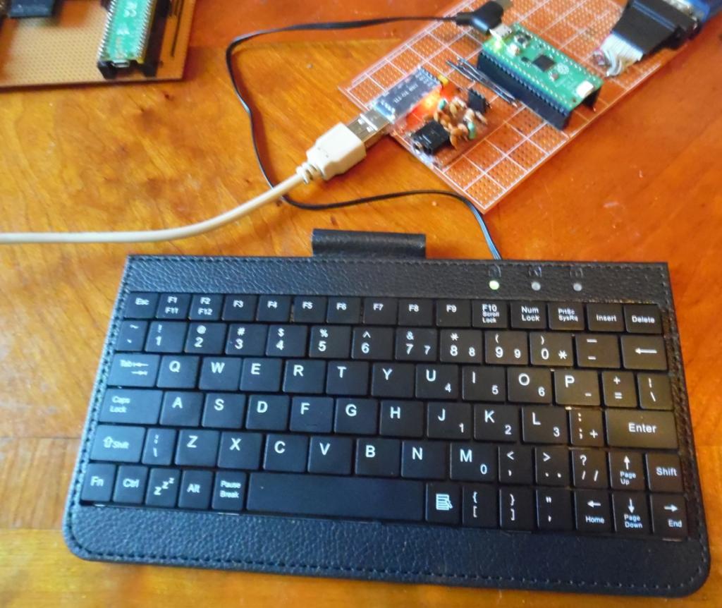

Posted: 08:36pm 18 Mar 2024
Currently this is using a USB terminal program, through the serial coms port, next I'll attempt connecting a USB keyboard through the coms port, to make it all stand alone, I'm currently failing at this, but I'll experiment. :-)
I was going to post that but thought no.
look at my usb pictures
ps using the usb to ttl adaptor with teraterm set baud to 112500 no default or it won't communicate. usb is so useful after ps2 keyboards.
Edited 2024-03-19 06:40 by stanleyella

Posted: 09:16pm 18 Mar 2024
  Mixtel90 said  It won't work, Stan. You would be connecting a USB keyboard to a COM port.
The console is on the COM port. USB devices go on the USB port. :)
You can force the console *display* to be on VGA or LCD, but the keyboard has to be on the USB port.
yes sir I only connect usb to keyboard and usb to ttl is power and mmedit on pc.
Kevin got it wrong but thought don't say.
if I connect a £1 poundland power bank to the usb to ttl instead of a pc it's a stand alone basic computer. remember the usb2ttl is the 5V supply
