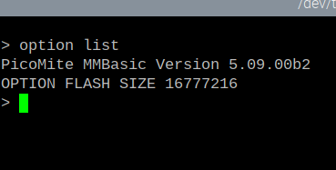

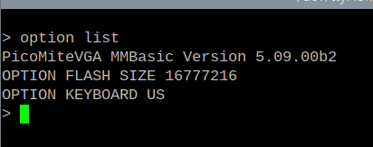

  Hans said  I am starting to wonder if these versions will only run on the board that Peter was proposing?
The following are screen shots of the PicoMite and PicoMiteVGA loaded on to the same Waveshare board I was trying to load the USB and VGAUSB versions.
Hans ...

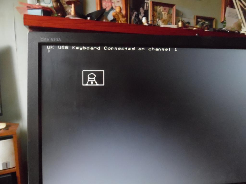

I get this on connecting usb to usb to ttl converter which 5v powers rpipico vbus. it recognises usb kb dongle and it was option keyboard uk.

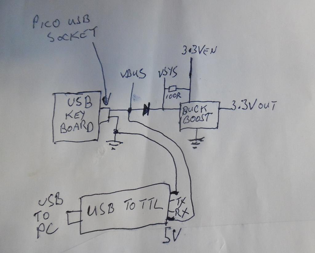

Posted: 05:39pm 26 Feb 2024
Mick, these are my connections. usb to ttl 5V to vbus, that powers the usb keyboard and through the diode to the switching reg and 3.3V out.
if I update firmware then disconnect usb to ttl and usb kb then hold button and connect to pc usb or it will power usb to ttl in reverse, maybe bad
edit doh I soldered the usb to ttl so I'll stick a Schottky diode in the 5V from usb to ttl to vbus so safe

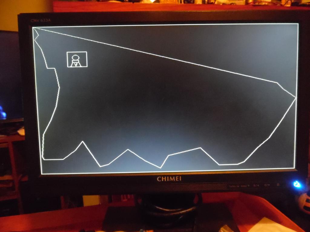

Is this a problem? I draw coordinates but it aways joins the last to the first like the polygon command but it shouldn't. should it?
OPTION BASE 1
dim lx%(35)=(0,5,9,13,3,18,25,30,48,53,57,47,32,11,5,9,57,89,108,149,170,220,262,300,320,400,447,493,510,545,572,600,638,605,590)
         ' 1         5             10            15             20                  25                  30                  35
dim ly%(35)=(0,7,15,25,40,70,100,130,130,160,193,253,298,346,420,430,430,400,370,457,450,400,440,466,424,400,460,460,452,403,373,320,240,210,190)
dim l%,o%
mode 1
cls
box 0,0,mm.hres,mm.vres,,1
'polygon 35,lx%(),ly%()
for l%=1 to 34
 o%=l%+1
 line lx%(l%),ly%(l%),lx%(o%),ly%(o%)
next l%
box 80,80,48,48,,1
circle 100,98,8
box 92,106,16,8
line 92,114,88,126
line 108,114,112,126
line 86,126,90,126
line 110,126,114,126

The 5V rail on USB-TTL converters goes straight through from the USB socket to the 5V pin. You can't "reverse power" it. However, you can reverse power a PC USB port that it's plugged into. That's why I say that you disconnect the converter USB and connect the Pico USB for firmware updates then swap them back after. You can only ever get one source of supply that way.
If you use a separate 5V supply then you need to do more messing about. The rule still applies, only one source of supply. The best way is to only connect RX, TX and GND from the converter and remember to disconnect the separate supply before updating the firmware.

Posted: 09:59pm 26 Feb 2024
the line draw program earlir
for l%=1 to 5
 o%=l%+1
next l%
makes no difference. it says it;s flashing and vga screen scrolls no errors it runs as before like it hasn't flashed it???
Posts: 3417
Posted: 10:10pm 26 Feb 2024
  Stan said  Is this a problem? I draw coordinates but it aways joins the last to the first like the polygon command but it shouldn't. should it?
You may have found a bug as removing the For and Next still draws a polygon.
Option BASE 1
Dim lx%(35)=(0,5,9,13,3,18,25,30,48,53,57,47,32,11,5,9,57,89,108,149,170,220,262,300,320,400,447,493,510,545,572,600,638,605,590)
Dim ly%(35)=(0,7,15,25,40,70,100,130,130,160,193,253,298,346,420,430,430,400,370,457,450,400,440,466,424,400,460,460,452,403,37
3,320,240,210,190)
Dim l%,o%
MODE 1
CLS
Box 0,0,MM.HRes,MM.VRes,,1
'Line GRAPH lx%(),ly%()
l%=1
o%=l%+1
Line lx%(l%),ly%(l%),lx%(o%),ly%(o%)
You can however get what you want using LINE GRAPH instead of Polygon.
Edited 2024-02-27 08:40 by phil99

Posts: 3417
Posted: 12:08am 27 Feb 2024
Some more experimenting with the Line issue with arrays.
It only happens with integer arrays, and doesn't always draw a polygon.
A minimal command line version.
> dim x%(3)=(30,90,90,30), y%(3)=(30,30,90,90)
> Line x%(0),y%(0),x%(1),y%(1)
Draws 3 sides of a square but the 4th finishes at (0,0)
Edit.
Stan's earlier code works correctly if all the "%" symbols are removed.
Edited 2024-02-27 15:52 by phil99
Posts: 6199
Posted: 08:05am 27 Feb 2024
Hi phill99, stanleyella,
This is a real bug.
Since x%(0) is a value (not an array like x%()) the command
LINE x%(0),y%(0),x%(1),y%(1) should plot a single line. It is simply 2 sets of coordinates. To draw all value in the arrays, it should be
LINE GRAPH x%(),y%(),c
POLYGON x%(),y%(),c
Or (maybe if I interpret the user manual correct)
LINE x%(),y%(),a%(),b%()
I can also confirm that this bug exsits in V5.08.00 (the official release on Geoff's page). Appart from plotting the whole array with LINE, that is a but, the other bug is that it ends the sequnce at (0,0). That is a second bug.
