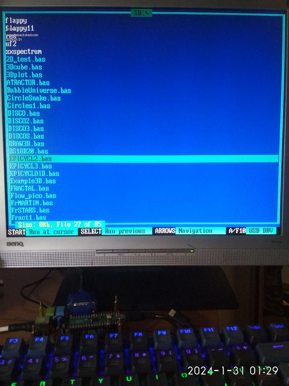

Geoff and Peter,
Is it possible to implement in PicoMite a mode for accessing the contents of an SD card from a computer via USB?
This mode is available in this bootloader that I use for my board.
https://github.com/xrip/pico-launcher
Regards, Java

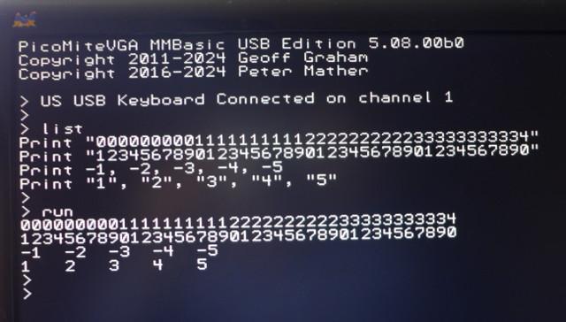

Posted: 01:05am 06 Feb 2024
see, tab stops every 4 columns:
Geoff - you may wish to update your manual for the PicoMite VGA to match the behaviour of Peter's code.
after all the palaver here and elsewhere on the forum, i certainly won't be bothering to waste my time report any other bugs, errors, or inconsistencies again! guessing by the reduced traffic on here i assume most others have already arrived at the same conclusion.
rob.
Posts: 6631
Posted: 05:45am 06 Feb 2024
Normal PRINT statements on the CMM2 obey whatever the OPTION TAB x is set to when seen on the VGA output.
When seen by a terminal emulator, it depends on whatever the terminal is set to. Most seem to default to 8.
With a terminal emulator, you could clear all tabs and set your own tabs at any column.

Posts: 12071
Posted: 08:09am 06 Feb 2024
The code currently is set to 4 but should probably respect OPTION TAB both for print and the editor as per other variants. These means by default the print tab is 2 for other variants and will be for the Pico when I change it. It has never defaulted to 8 on any version of MMbasic for a local screen but of course a tab sent to a remote console will, as Jim says, do whatever the terminal is set up for
Edited 2024-02-06 18:12 by matherp
