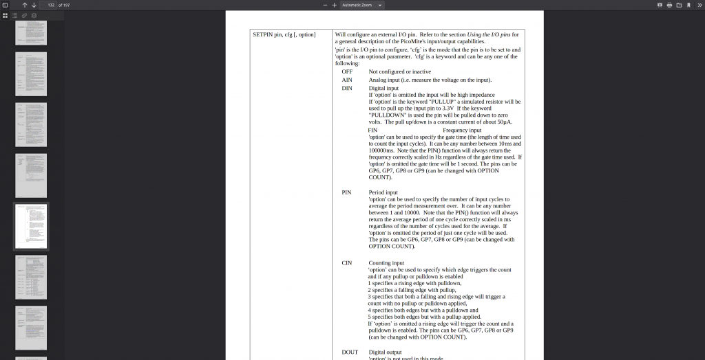

Posted: 05:50am 24 Jan 2024
      SetPin  Fin  index is  out of bounds
      page  132
      page  128
      page  97       VGA

Posts: 12071
Posted: 10:01am 24 Jan 2024
re: above
The command SETPIN FIN is missing from the PicoMite and PicoMiteVGA manuals. It is there in the WebMite manual.
Posts: 3369
Posted: 10:18am 24 Jan 2024
Now that makes sense, thanks.
The manuals have been updated.

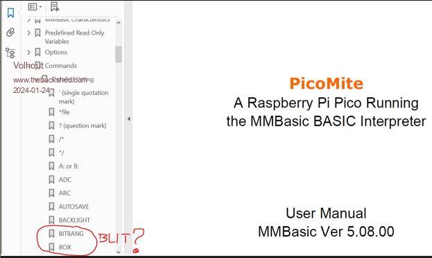

Posts: 6199
Posted: 11:06am 24 Jan 2024
Geoff,
Very minor issue. In the picomite manual.
BLIT command is explained in the COMMAND section in the table.
If you view the booksmarks (unfold the list) all commands are shown, except BLIT. Some attribute is missing.
Edited 2024-01-24 21:09 by Volhout

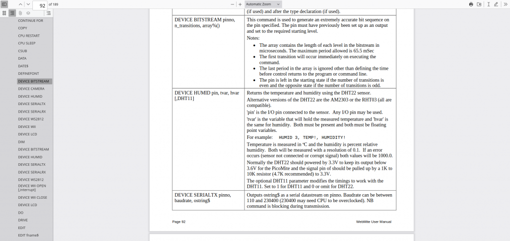

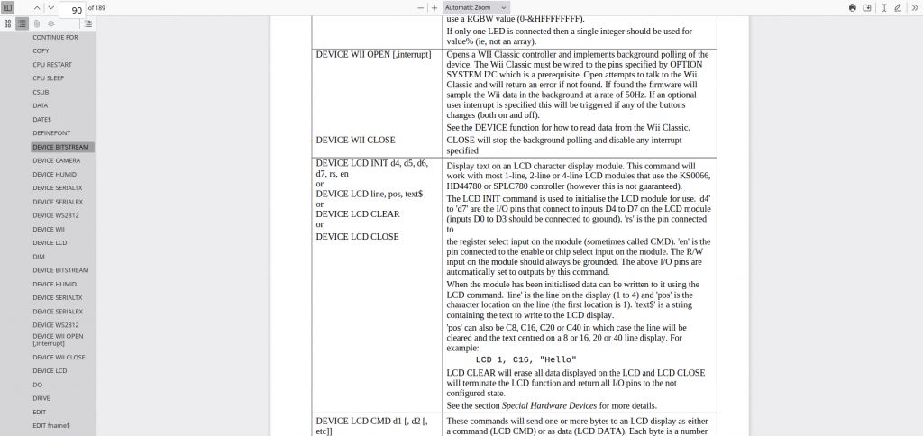

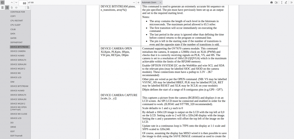

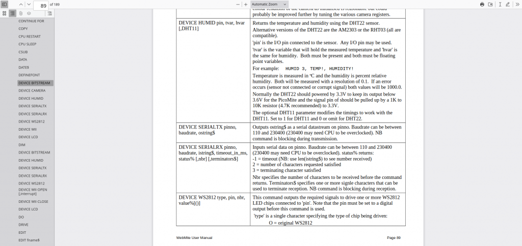

Posted: 03:14pm 24 Jan 2024
      It is the  WebMite Manual
       Device Bitstream        page  88  repeats  on  92
       Device Humid            page  89  repeats  on  92
       Device SerialTx and Rx  page  89  repeats  on  92  and  93
       Device WS2812           page  90  repeats  on  93
       Device WII Open         page  90  repeats  on  93
       Device LCD              page  90  repeats  on  93
      Dim  is out  of place
             Wayne  !!!
