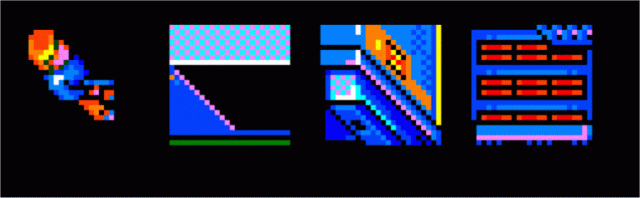

@Tom,
I agree that the library may not be the best way forwars, but for speed, there is nothing that can beat it. So let's just try it first. This is research...
@Martin,
unpzip attached into a folder.
then
load "spr_csub.bas"
library save
load "tile0_csub.bas"
library save
load "tile1_csub.bas"
library save
load "tile2_csub.bas"
library save
memory
You should have 72k in your library, consisting of 4 csubs named "SPRITES, TILE0, TILE1, TILE2".
In this folder is also a set of index file that was created dusring the CSUB creation process.
In below program I use these indexes to create an index array. The index array contains the absolute memory addresses where each sprite or tile lives in memory.
The sprite number is the index in the array.
'write tiles from library
'get start addresses
spr%=Peek(cfunaddr SPRITES)
til0%=Peek(cfunaddr TILE0)
til1%=Peek(cfunaddr TILE1)
til2%=Peek(cfunaddr TILE2)
'build index file
Dim sprite_index%(&h60)
Dim tile_index%(&hff)
Open "spr_index.txt" For input As #1
For i=0 To &h5a
 Input #1,a$
 sprite_index%(i)=spr%+Val(a$)
Next
Close #1
Open "tile_index0.txt" For input As #1
For i=0 To &h3f
 Input #1,a$
 tile_index%(i)=til0%+Val(a$)
Next i
Close #1
Open "tile_index1.txt" For input As #1
For i=&h40 To &h7f
 Input #1,a$
 tile_index%(i)=til1%+Val(a$)
Next
Close #1
Open "tile_index2.txt" For input As #1
For i=&h80 To &hff
 Input #1,a$
 tile_index%(i)=til2%+Val(a$)
Next
Close #1
MODE 2
Sprite compressed sprite_index%(20),70,100 'a sprite
Sprite compressed tile_index%(20),100,100  'a tile from the first csub
Sprite compressed tile_index%(70),130,100  'a tile from the second csub
Sprite compressed tile_index%(150),160,100 'a tile from the 3rd csub
Even when the tiles and sprites are not the latest, use this to see if it works.

Hi Martin, Lizby,
Lizby, that is completely correct!
This code below makes the screen scroll live... Quite impressive speed on the pico VGA. It uses Martins earlier test code.

Very impressive :-) between 2.2 and 12.5mS per iteration at 252MHz so a scroll rate of about 133Hz
or between 1.5 and 8.3mS per iteration at 378MHz so a scroll rate of about 200Hz!!!
This was on a VGA.

wow, thats fast, I am totaly thrilled
I tidied it up a bit, because the pixel-wise scrolling was only there to enable the Tiles to load evenly. For every 8 pixel scroll, one animation step of the player sprite.Since the original ran on 8x8 pixel ASCII/PETSCII in text mode, smaller steps are unnecessary. As you can see, I added a Pause 75 in every Frame to keep it smooth.
That time could be used, in the Game to calculate the Gamelogic etc.
