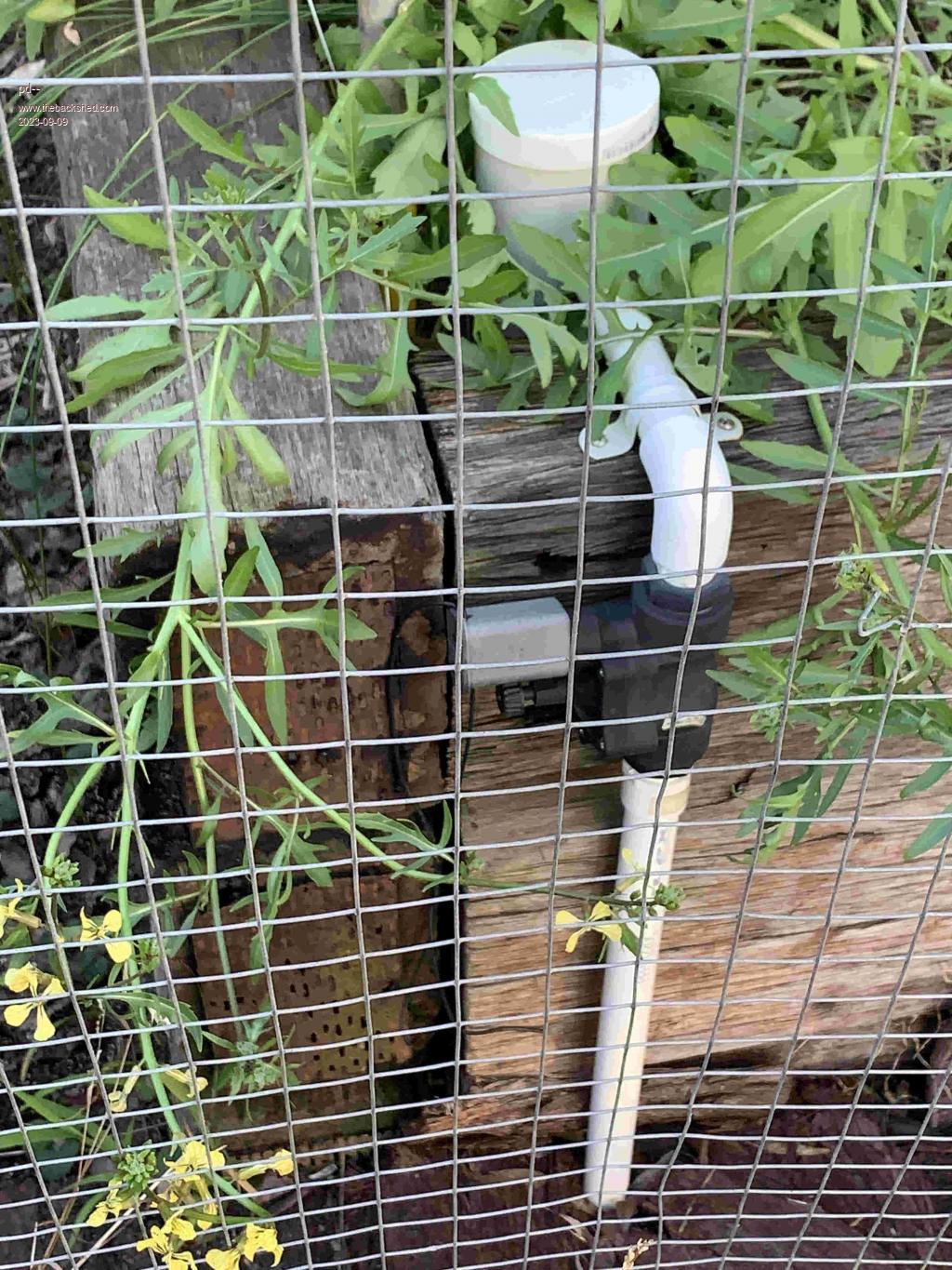

This is for our food garden , so a mix of drippers for the fruit trees
misters for seed raising boxes and raised beds with inbuilt 200l tanks
Theirs a flote switch to shut off filling when the tank in the bed is full
There is not enough flow capacity to just turn everything on at once
so you need to stagger each section.
and different things need watering at different times.
