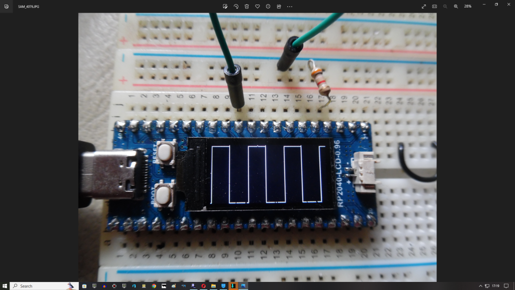

Posted: 07:46pm 04 Aug 2023
I tried another method using a buffer for graphics and the "trigger" works with pwm test signal.very stable.
 SetPin GP18,pwm1A 'this optional test signal comment out
 PWM 1,5000,50   ' 50% = square wave ,this optional test signal comment out
 dim c%,x%,samples!(360)

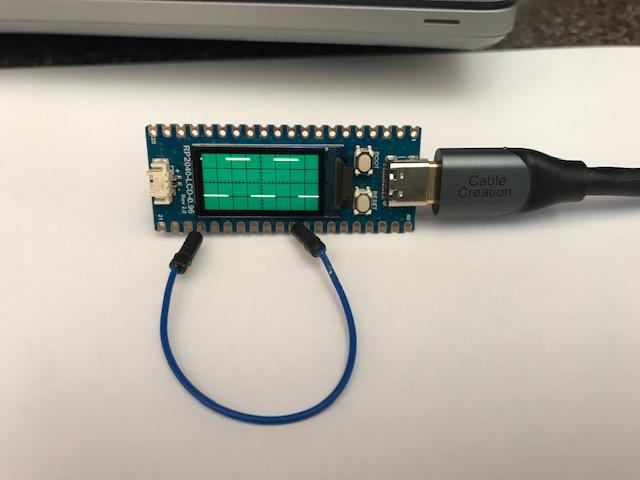

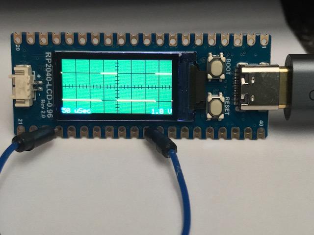

NPHighview
Joined: 02/09/2020
Posts: 222
Posted: 11:16pm 04 Aug 2023
Very nice! I think the stability is due in some part to the divisibility of the square wave frequency into the AIN sampling frequency, though. With a PWM frequency of 7654 (not evenly divisible into 500000), you get some display jitter, but the triggering jitter is non-existent.
Also, brilliant use of pin 24 as a reference signal. I had just started wiring up a separate Pico for that, but hadn't yet got it going.
Here's a version that initializes the graticules, and then use array drawing commands for everything. The only thing I haven't figured out is how to use MATH commands to rapidly copy from the trigger point (at c%) to the display buffer without a FOR loop.
LOTS of setup (sorry!) in order to accomplish the Array graphics output.

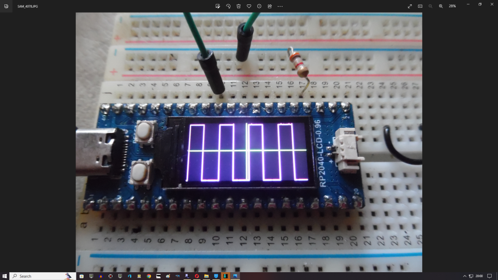

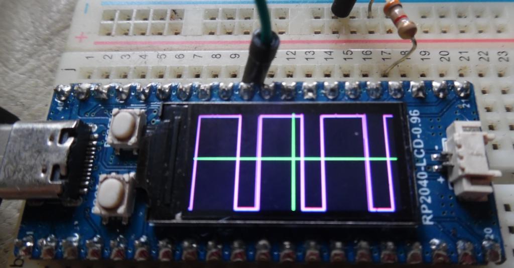

Posted: 05:09pm 05 Aug 2023
You can use the frame buffers to hold the cursor instead of redrawing it.
PWM 1,10000,50  ' 50% square wave ,this optional test signal comment out
SETPIN (31), AIn
adc open 500000,1 'samples per second
FRAMEBUFFER CREATE F
FRAMEBUFFER LAYER L
FRAMEBUFFER WRITE L
line 79,0,79,79,,rgb(red)
line 0,39,159,39,,rgb(red)
FRAMEBUFFER WRITE F
do
adc start samples!() 'get new samples
'trigger
c%=0
do:If samples!(c%) > 0.1 then if samples!(c%+1)<0.2 then exit do
inc c%:loop while c%<160
math scale samples!(),79,samples!()'scale to 80 pixel height
'cls
FRAMEBUFFER COPY L,F
for x%=0 to 158 'screen width
line x%,samples!(x%+c%),x%+1,samples!(x%+1+c%),,rgb(white) 'draw new sample
next x%
FRAMEBUFFER COPY F,N
loop
edit cls not needed
12345 Hz
Edited 2023-08-06 05:07 by stanleyella

Is this attributable to the firmware version? Don't know, but here is my setup:
PicoMite MMBasic Version 5.07.08b8
OPTION SYSTEM SPI GP10,GP11,GP28
OPTION AUTORUN 2
OPTION COLOURCODE ON
OPTION HEARTBEAT OFF
OPTION CPUSPEED (KHz) 250000
OPTION DISPLAY 50, 132
OPTION LCDPANEL ST7735S, LANDSCAPE,GP8,GP12,GP9,GP25
OPTION AUDIO GP0,GP1, ON PWM CHANNEL 0
Here are snippets of my code:
Dim B_addr%, S_addr%                  ' Memory addresses of Buffer and Signal arrays
 B_Addr% = Peek(varaddr samples!())  ' from matherp's example on The Backshed Forum
 S_Addr% = Peek(varaddr Buffer!())   ' https://www.thebackshed.com/forum/ViewTopic.php?TID=16081&P=4
Sub Get_Samples   ' Obtains ADC samples into samples!(), then Buffer!() arrays
 samples!(2*Hres-1) = -1                                        ' Samples never < 0
 ADC start samples!() : Do While samples!(2*Hres-1) < 0 : Loop  ' wait for ADC completion
 For c%=0 To HRes-1                                             ' Find trigger point
   If samples!(c%) > 0.1 Then If samples!(c%+1)<0.2 Then Exit For
 Next c%
'  Memory copy FLOAT S_Addr%+c%*8, B_Addr%, Hres                ' Doesn't Work!
 For x%=0 To HRes-1 : buffer!(x%) = samples!(x%+c%) : Next x%  ' Offset-Copy into Display Buffer
Here's the entire listing:
' Sampling, Test Signal, Framebuffers from stanleyella
' Math & Memory Copy from matherp
' Graticules and array drawing from NPHighview
' Test Signal output on GP18, PWM1A, or Pin 24
' Analog Signal input on GP26, or Pin 31
' Scale labels not calculated for the moment
Option EXPLICIT
Const Hres       = MM.HRes    ' Horizontal screen resolution
Const Vres       = MM.VRes    ' Vertical   screen resolution
Const VScale     = Vres/(-6.6)  ' Scale factor for display buffer
Const Voff       = .75*Vres   ' Offset for display buffer
' Specifically For Waveshare RP2040-LCD-0.96
Const Major      = Vres/4     ' Major tic mark spacing
Const Minor      = Major/4    ' Minor tic mark spacing
' Generic to all displays
Const HMajor     = Hres/Major ' How many Horiz Major Tic marks
Const VMajor     = Vres/Major ' How many Vert  Major Tic marks
Const HMinor     = Hres/Minor ' How many Horiz Minor Tic marks
Const VMinor     = Vres/Minor ' How many Vert  Minor Tic marks
Const Background = RGB(32,64,32) ' Color for Display background, a la Tektronix scopes
Const GMajor     = RGB(black)    ' Color for Major tic marks
Const GMinor     = RGB(black)    ' Color for Minor tic marks
Const Signal     = RGB(yellow)   ' Color for displayed signal
Const TxtColor   = RGB(cyan)     ' Color for displayed text
Const PWM_Freq   =   5000        ' Frequency for PWM test signal on Pin 24
Const ADC_Freq   = 400000        ' Sampling frequency for signal input on Pin 31
                                ' Note: >== Full waveform should be 100 pixels wide
Dim Horizontal!(Hres)            ' Horizontal coordinate buffer for fast graticule draw
Dim Buffer!(Hres)                ' Display buffer. As wide as LCD screen
Dim samples!(2*HRes)             ' Allow for twice the display width to capture a trigger
Dim c%                           ' Index of trigger condition in signal
Dim HMajorX1(HMajor+1), HMajory1(HMajor+1), HMajory2(HMajor+1) ' For Horizontal Major Axes
Dim VMajorX1(VMajor+1), VMajorx2(VMajor+1), VMajory1(VMajor+1) ' For Vertical   Major Axes
Dim HMinorX1(HMinor+1), HMinory1(HMinor+1), HMinory2(HMinor+1) ' For Horizontal Minor Axes
Dim VMinorX1(VMinor+1), VMinorx2(VMinor+1), VMinory1(VMinor+1) ' For Vertical   Minor Axes
Dim Integer x%, y%               ' Index values for drawing graticules
' Initialization Section - executed once
Initialize_Arrays
Initialize_Hardware
' Processing Section - looped forever
 Randomize_Test_Signal
 Get_Samples
 Scale_Samples
 Update_Display
' Subroutines
Sub Draw_Graticules
 FRAMEBUFFER WRITE L                                            ' Write this once into Framebuffer L
 CLS Background                                                 ' Clear the screen to background color
 Line HMinorx1(), HMinory1(), HMinorx1(), HMinory2(), 1, GMinor ' Draw minor horiz graticules
 Line VMinorx1(), VMinory1(), VMinorx2(), VMinory1(), 1, GMinor ' Draw minor vert  graticules
 Line HMajorx1(), HMajory1(), HMajorx1(), HMajory2(), 1, GMajor ' Draw major horiz graticules
 Line VMajorx1(), VMajory1(), VMajorx2(), VMajory1(), 1, GMajor ' Draw major vert  graticules
 Text    0, Vres, "50 uSec", LB, 7, 1, TxtColor, Background     ' Draw Time Scale at LL
 Text Hres, Vres, "1.0 V",   RB, 7, 1, TxtColor, Background     ' Draw Volts Scale at LR
Sub Randomize_Test_Signal
 PWM 1, PWM_Freq, 10+20*Rnd   ' Randomize duty cycle to ensure displayed signal is refreshing
Sub Get_Samples   ' Obtains ADC samples into samples!() array
 samples!(2*Hres-1) = -1                                        ' Samples will never be < 0
 For c%=0 To HRes-1                                             ' Find a trigger point
 Next c%
'  Memory copy FLOAT S_Addr%+c%*8, B_Addr%, Hres  ' from matherp's example see URL above
Sub Scale_Samples
 Math Scale buffer!(), VScale, buffer!()                    ' Scale samples to fit vertically
 Math Add   buffer!(), Voff,   buffer!()                    ' Offset to bottom of screen (positive is up)
Sub Update_Display
 FRAMEBUFFER COPY L, F ' Pick up screen background and graticules
 FRAMEBUFFER WRITE F : Pixel Horizontal(), buffer!(), Signal
Sub Initialize_Arrays
' Print "Buffer Address:  "; Hex$(B_Addr%)
' Print "Samples Address: "; Hex$(S_Addr%)
 Math Set 0, Buffer!()                               ' Zero out the display buffer
 Math Set 0, HMajory1() : Math Set Vres, HMajory2()  ' Set Arrays for Time  Major Axis
 Math Set 0, VMajorX1() : Math Set Hres, VMajorx2()  ' Set Arrays for Volts Major Axis
 Math Set Vres/2+Minor/2, HMinory1() : Math Set Vres/2-Minor/2, HMinory2() ' Set Arrays for Time  Minor Axis
 Math Set Hres/2+Minor/2, VMinorx1() : Math Set Hres/2-Minor/2, VMinorx2() ' Set Arrays for Volts Minor Axis
 For x = 0 To Hres-1 : horizontal!(x) = x    : Next x ' used in array graphics
 For x = 0 To HMajor : HMajorx1(x) = x*Major : Next x ' for Time  Major Axis graticule
 For y = 0 To VMajor : VMajory1(y) = y*Major : Next y ' for Volts Major Axis graticule
 For x = 0 To HMinor : HMinorx1(x) = x*Minor : Next x ' for Time  Minor Axis graticule
 For y = 0 To VMinor : VMinory1(y) = y*Minor : Next y ' for Volts Minor Axis graticule
Sub Initialize_Hardware
 SetPin GP18,pwm1A    ' Set up pin 24 for PWM test signal out
 PWM 1, PWM_Freq, 10  ' Square wave on Pin 24
 SetPin (31), AIn     ' ADC input on   Pin 31
 ADC open ADC_Freq, 1 ' Sample at specified samples per second
 FRAMEBUFFER LAYER  L
 Draw_Graticules
and here's its current appearance:

OK - that makes sense. I've emulated your code (see below), but for floats (as ADC start sample returns floats from 0 to 3.3), and it works (probably no surprise). Now to figure out what I'm doing wrong in my much longer scope code (maybe depending on % and ! to control variable typing instead of explicitly stating).
Dim Integer c=5, n, HRes=MM.HRes
Dim Float   signal(HRes*2), buffer(Hres)
Dim Integer addr.signal, addr.buffer
addr.signal = Peek(varaddr signal()) : Print "*signal = "; addr.signal
addr.buffer = Peek(varaddr buffer()) : Print "*buffer = "; addr.buffer
For n = 0 To (Hres*2)-1
 signal(n) = n/100
Next
Memory copy FLOAT   addr.signal + c*8, addr.buffer, Hres
For n = 0 To Hres-1
 Print Str$(n, 3, 0), "Floats: ";Str$(signal(n+c),3,2); " -> "; Str$(buffer(n),3,2)
Next
NPHighview
Joined: 02/09/2020
Posts: 222
Posted: 01:02am 10 Aug 2023
Well, it's a mystery. Basically, retyping the whole thing back in (making some structure and declaration changes along the way) now results in the memory copy working. Wow - it's fast!
Thanks again to stanleyella and matherp for hints :-)
 FRAMEBUFFER LAYER  L
Sub Draw_Graticules
 Local STRING T$, V$
 FRAMEBUFFER WRITE L
 CLS Background
 T$ = Str$(1000000*Major/ADC_Freq,3,0) + " uSec"
 Text    0, Vres, T$, LB, 7, 1, TxtColor, Background     ' Draw Time Scale at LL
 V$ = Str$(1.0, 2, 1)+" V"
 Text Hres, Vres, V$, RB, 7, 1, TxtColor, Background     ' Draw Volts Scale at LR
 PWM 1, PWM_Freq, 45+10*Rnd  ' Randomize duty cycle to ensure displayed signal is refreshing
Sub Get_Samples               ' Load ADC inputs into sample() array
 sample(2*Hres-1) = -1       ' Samples will never be < 0
 ADC start sample() : Do While sample(2*Hres-1) < 0 : Loop
Sub Scale_Samples
 Memory copy FLOAT addr.sample + trigger*8, addr.buffer, Hres
Sub Update_Display
 FRAMEBUFFER WRITE F : Pixel Horizontal(), buffer(), Signal
Edited 2023-08-11 00:34 by NPHighview

Posted: 04:38pm 10 Aug 2023
Ta Mick. It's not a "real" scope but could be useful.. my code is short and shows pwm signal or sound ..after filter.
Assuming it's a repetitive wave then oversampling more than the display width and finding a trigger sort of works ok but my trigger is too simple to be true.
 PWM 1,9876,30  'square wave ,this optional test signal comment out
 dim c%,x%,samples!(320)
 SETPIN (31), AIn
 FRAMEBUFFER LAYER L
 FRAMEBUFFER WRITE L
 line 79,0,79,79,,rgb(green)
 line 0,39,159,39,,rgb(green)
 FRAMEBUFFER WRITE F
 do
   'trigger
   c%=0
  do:If samples!(c%) > 0.1 then if samples!(c%+1) < 0.2 then exit do
     line x%,samples!(x%+c%),x%+1,samples!(x%+1+c%),,rgb(magenta) 'draw new sample from sample(c%)
next x%
 loop
